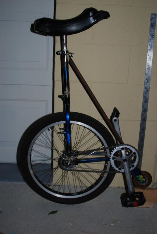

I’m so determined to find a solution I built this thing. It’s geared to the equivalent of a 36er.

You built that thing?
Pedal-strike much?

Yeah, it looks interesting. Like a skate bike that’s actually a bike (not a tricycle). But how does it steer? Or does the front wheel just lift off the ground for turning? Freewheel?

It is actually a unicycle. The front skate wheel, which is not steerable, is only there to prevent pedal strike when stopping (intentionally or otherwise). It’s not bad to ride and is faster than my 29er. Setting up a higher or lower gear is simple. It seems easiest to ride in about the equivalent of a 29er gearing. The 36er gearing seems a little tougher for me to get used to. I also built one with a 29er wheel but the balance envelope seemed really critical to me.
It does take some getting used to and is certainly not as practical as a regular uni. On the plus side it is very compact and I can flat foot at rest. When in riding trim the crank center is about 11 inches off the ground so about the same as a b*ke. Of course this height fluctuates as you balance it. You can keep going if the skate wheel touches down but its best not to leave it on the ground for too long.
