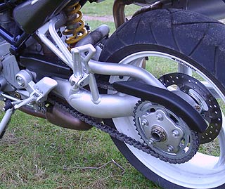

Strength is not such a problem with one sided forks as one might guess. One sided rear wheel swingarms have been popular on racing motorcycle for many years. It’s big advantage is to change wheels (new tire ) fast, by removing one nut, and leaving the brakes and chain in place.
My point being, this design can be light and strong.

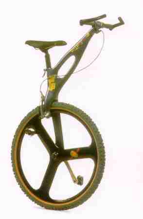

the 48 " flat streets uni
The top of the fork crown would be a flat ribbon of steel, hugging the 48" TA style air tire.
The standard seatpost has been replaced by a strong fender, to keep your knees from bending the long spokes. The seat mounts directly on the fender, or on a riser bolted to the fender.
It may be impossible for most riders to mount without a wall, idle, or ride in traffic, hills etc.
I bet it could be sold for a profit, like a larger 36" , for 500 $ or so.
There is lot’s of riders like me who live in flat places that would love the greater hight, slower pedaling speed, and extra coolness factor. :sunglasses:

Funnily enough i saw the exact bike that feel the light posted parked down the road the other day, I stopped to examin the way the thinner tube runs from the left hand side of the wheel across in front of it to hook up on the right side of the swing arm pivot, a really crazy design i’d not seen before. I can fully understand the single swing arm for motorbikes, but my car essentially has exactly the same in the rear and it requires some seriously heavy components to keep everything in line. Also there’s no redundancy, which has come back to bite the manafacturers in the ass, I just found this recall notice:
“Cannondale is voluntarily recalling 367 Carbon Lefty suspension forks. If you think you may have an affected fork, stop using it immediately! This bicycle fork can break, causing loss of control and possibly serious injury or death.”
I guess if one of two shocks breaks you can probably ride it out, but if a lefty gives way…
