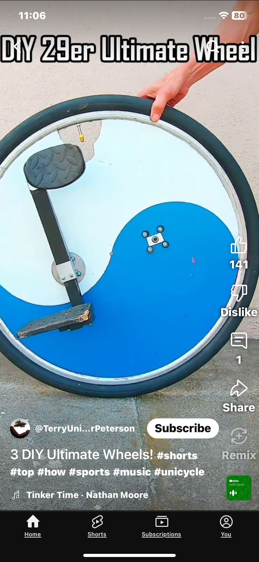

unicycle.com offers the 20", 24" and 28". The 28" is said to be easiest to learn, possibly also because it helps to have the wheel pressed against your leg while at the bottom position. That way you can gain your balance again and make another rotation. Terry Unigeezer has made several custom UW’s, also some 36", which I would love to get my hands on, but with my 2 left hands, I couldn’t make it myself.

Self building seems feasible. Take screws instead of spokes to fix the rim on the disc. Then screw 2 old cranks directly on the disk to hold the pedals. I would machine the pedal holders so that they don’t touch the ankles. Right/left pedal thread cutters are not too expensive.

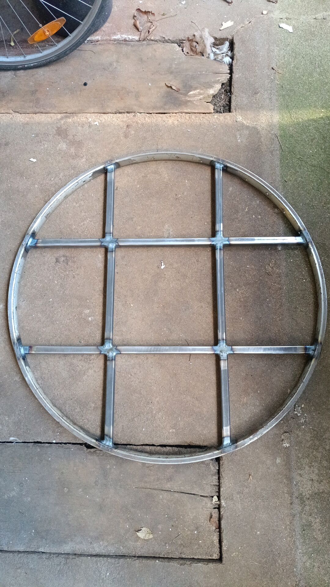

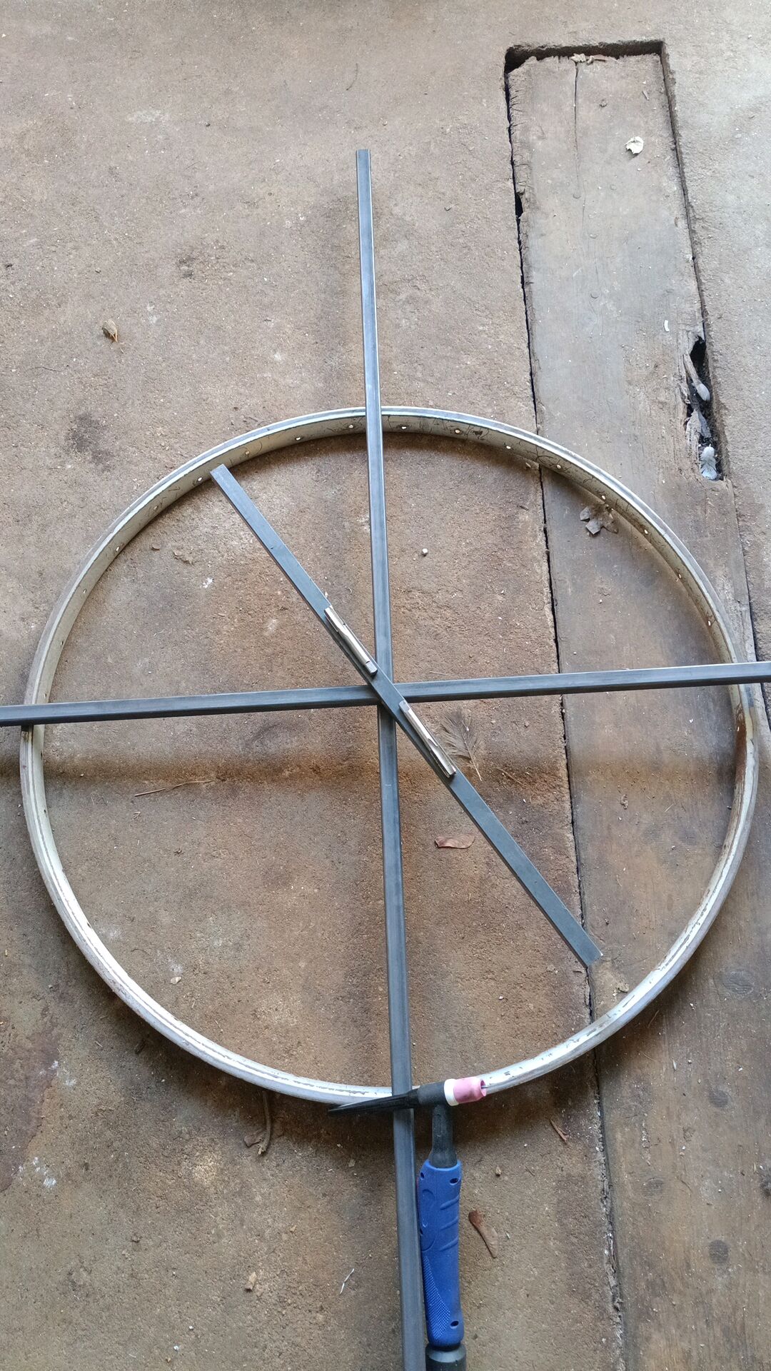

Will you weld it like that. Some weld it like a #

I gave it a nice personal touch on the left coloumn due to swapping out upper and lower part which have slightly different lenghts. On the right coloumn I showed that I can do it straight if I really want to.
Ulkig :wink:
Personal touch is a good thing.

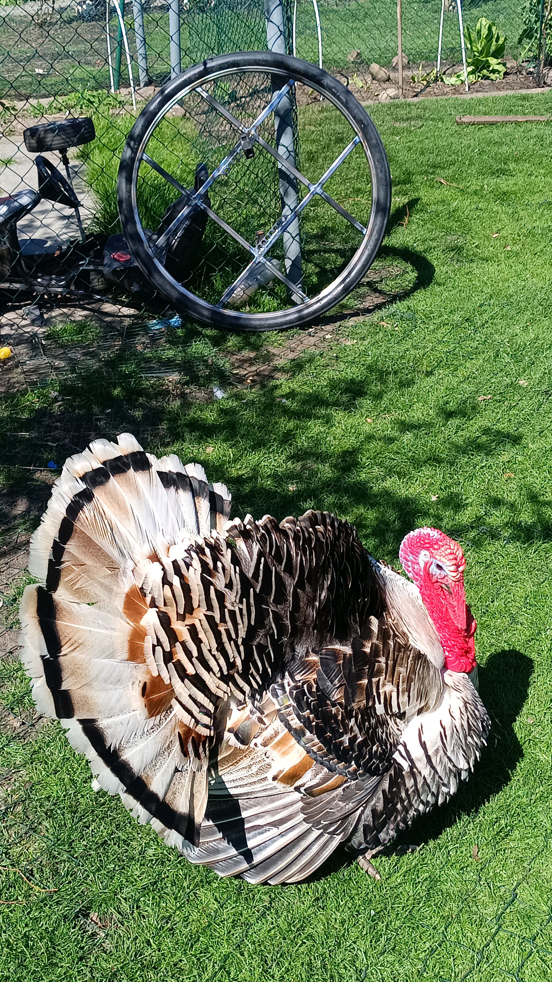

The ultimate feather wheel.
You can tell that turkey is intimidated by the side eye glare he/she is giving you.
