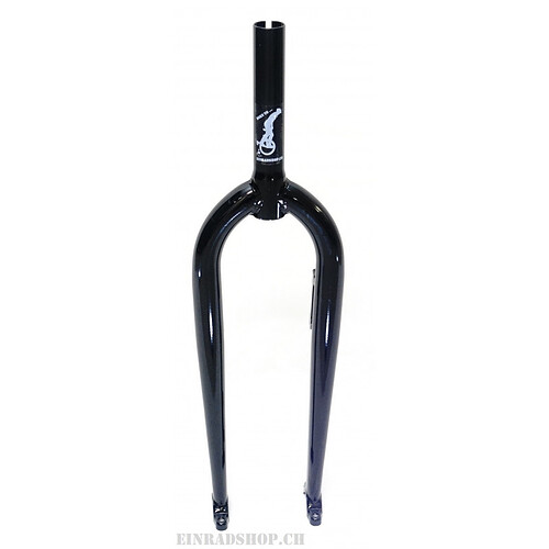

Is the brake mount on the other side of the frame different somehow? Interesting that it’s on the front side.
I had a look myself and will find your answer here
https://www.einradshop.ch/einrad-kaufen-schweiz/einradgabeln/1598-one4all-crmonster-fattygabel.html
Here is a snippet
Da diese Gabel auf Langlebigkeit ausgelegt ist, liess ich kurzum auch auf der Gegenseite Disc- Sockel anschweissen. Dies kostet nicht alle Welt, hat aber den Vorteil, dass das “Ersatzteil” schon eingebaut ist. Bei einem verbogenen oder abgerissenen Bremssockel , Fertigungstoleranzen usw. kann man die Gabel einfach um 180 Grad drehen !
I do not speak any German but here is an automatic translation which is probably enough to give you the idea.
Since this fork is designed for durability, I also had disc bases welded on the opposite side. This does not cost everyone, but has the advantage that the “spare part” is already installed. With a bent or torn brake socket, manufacturing tolerances, etc. you can easily turn the fork 180 degrees !
Here I have described it. You can use the translation tool in the top right corner.
My thought was: This fork should be indestructible and last as long as possible. A brake socket is not the most expensive thing on the fork. So I installed a second one as a spare part. If a base is bent, torn off, or something doesn’t fit, you can simply turn the fork 180 degrees.
Fair enough. Interesting idea!
Smart idea I like it. M4O has two tabs as well but both on the back so you can do either inboard and outboard disks. Now I will wait for the first frame that combines both approaches and comes with 4 brake tabs! :grinning_face:
