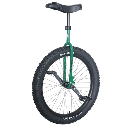

I’ve been thinking of getting a 27.5 Muni. The new KH 27.5 (USD950) is painfully expensive, but they also have a new steel 27.5 Muni for USD490 in racing green. Tempted…

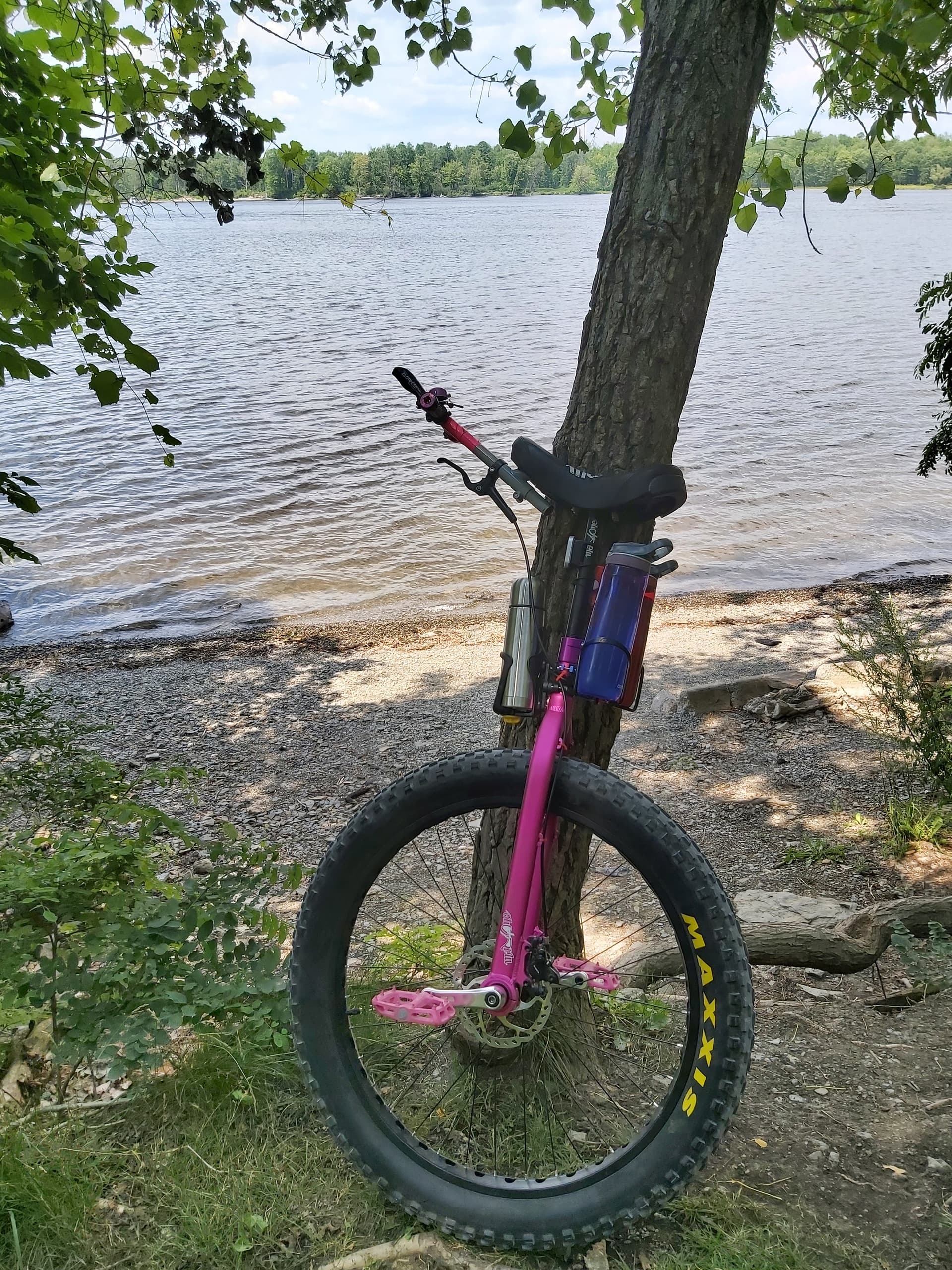

If you’re looking at a 27.5", maybe check out Mad4One as well? I recently bought a fat 27.5" from them at the start of the season and it’s been treating me really well, I paid a bit more for it to get the anodized pink one but it looks amazing, performs well, and doesn’t feel like it has any compromises component wise!

I’d take the Nimbus over the URC since it has machined bearing housings. Nimbus steel frames are pretty nice IMO.

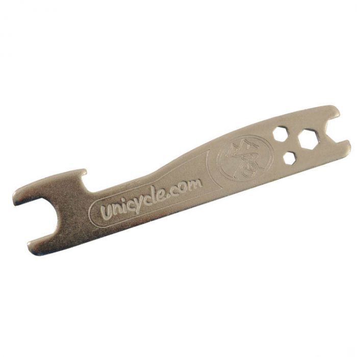

In theory the machined housings will be a bit easier on the bearings if they are built to tight tolerances. Plus you can adjust them with a 5mm Allen key rather than a 10mm spanner - one less tool to carry on the trail.

As for less tools, sure ok but it not a big deal IMHO. A 10mm spanner is tiny and weighs almost nothing.

FWIW, This (or similar) is quite handy and small, and it is nice to have to adjust pedals. Plus it has a 10mm spanner on the back. Yes I know many pedals can be taken off with an allen key as well but that is 8mm, not 5mm. So you still need an extra tool.
The bigger thing for me is that either the machine screws with the locating nub are required, or you need two tools to get them apart. At the very least you have to keep one part pressed into the housing with one hand while you undo the nut on the other end. If I’m not using a ratchet socket I’m going to be getting pretty frustrated.

To be honest, I am actually really pleased to see this new option from Nimbus. Previously they had the 26" and whilst I am very happy with my own 26", it has been mentioned numerous times here that the mountain bike market is increasingly favouring the 27.5" size and hence the tyre selection for muni is better there. Realistically muni is how most people who buy 26"/27.5" will use their machine.
With a steel 27.5" Nimbus, people who want an entry level machine have more tyre options and in addition those that simply favour steel have a great base to build up their dream uni from, given it has all the baseline parts needed to attach higher end components (ISIS hub, 27.5" wheelset, disk brake tabs). So this is a very nice new option and I am glad it has finally appeared.

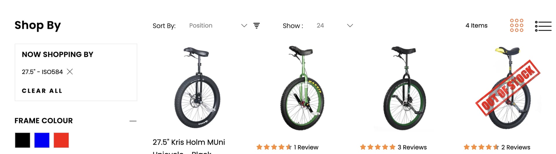

Looks like they do not sell it in the UK though. So is the a US only option @rogeratunicycledotcom?
I only see 24", 26" and 29" Nimbus branded steel Munis.
