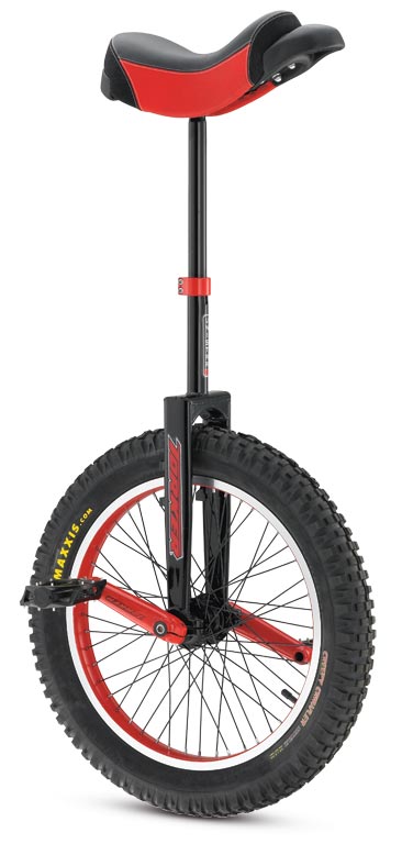

The only thing I’m concerned about is seat comfort, I’m used to riding on a friends (long-term-borrowed) Kris Holms style saddle, and I’m hoping the DX has a comfy seat? I’m assuming it’s the same seat as other productions, if it is, can anyone drop me a line about how comfortable they are? I’d hate to spend 250 on a new uni, and then have to shell out another 40 bucks for a kris holms seat to accomidate my discerning bum.
The DX style saddle is almost Identical to the KH. I can’t tell any difference between them, but that’s just me.
I think it may even be a tad more softer than the KH…
The old DX seats are softer than KH. The new red DX seats are pretty much the same as KH, but stiffer than they were before.

A friend of mine has the Torker DX, and I have ridden it. The bottom side of the handle for the seat is textured with plastic in lines, and after jumping over things for a while, my fingers were really hurting from how rough it was. I have a Kris Holm seat that is somehow different, and I much prefer it. Also, I am 5’8" or so, and I weigh 136lbs., and the dx was much too heavy for me. I used to ride on the United Trials, and I recently put it out of comission permanently (lets say a tig welder, an abandonded courthouse, and me with an afternoon to myself). I loved the United while it lasted though, and it weighed 12 lbs.
The newer KH’s have those grooves too.
