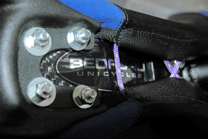

Oh yeah also when i was trying to tighten the front bumper i noticed that one of the nuts was not tightening and just turning around. I noticed also that this is really bad and must be fixed before you strip the cf base. To do this you need to take a pair of plyers and a flat screwdriver. This sort of only works well if you have the type of nut that it would be imposible to take off at this point with the bolt loose. Pull with the plyers and slowly rotate and then pull. Repeat and then eventually the bolt will pop into place… unless you forgot to file away a square and then you have issues… once it pops into place put the screwdriver under the nut and pull up. While keeping up the pressure with the screwdriver slowly tighten the nut untill the screwdriver cannot fit at all then tighten slowly the rest of the way. If you do not do this you will strip the square filed out spot in the base and i dont know what you can do then except hope that the handle is strong enough with the remaining bolts.

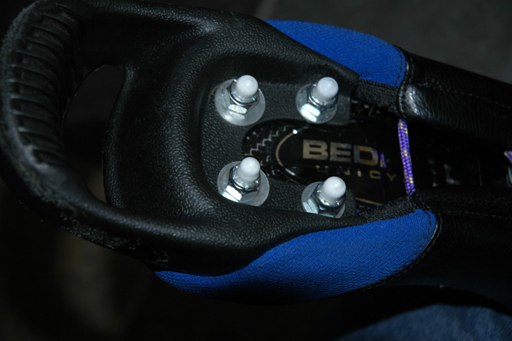

Yeah I did this all yesterday but didnt have time to take a pic and post it.

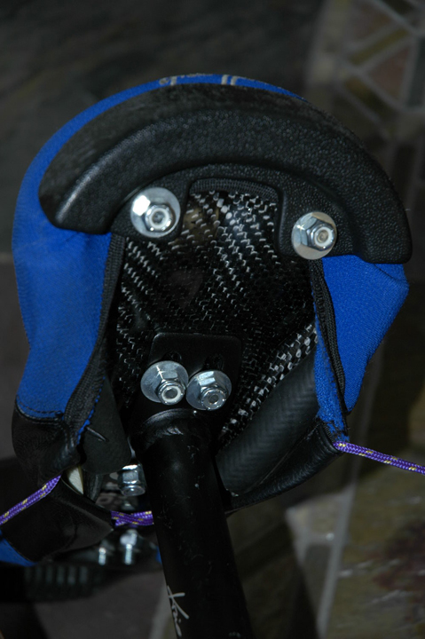

And heres my uni with the finished seat :sunglasses: :smiley:
In that first picture none of the bolts are tightened more than to just keep them in place temporarily.

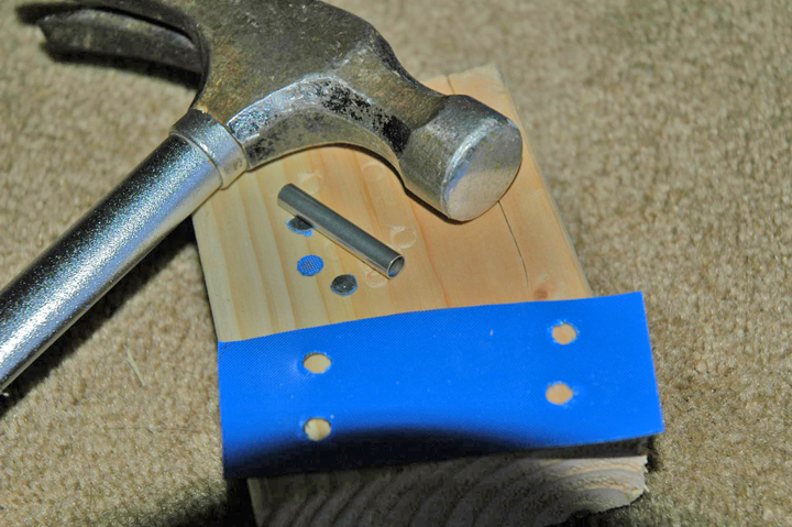

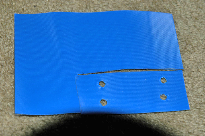

Okay so I put in a piece of rubber in my seat. Heres a few pics illustrating the process sortof. Heres the rubber cut out with the holes punched out. Basically i took off the washers on the seatpost and with a sharpie marked where the bolts came through the seatpost. I then put the peice of rubber up to the seatpost and drew an outline of the shape and put dots where the bolts came through.
To punch the holes i used this punch and a hammer. Its sort of obvious but use a scrap block of wood to do the pounding on because the hammer makes huge dents before it punches through the rubber.
