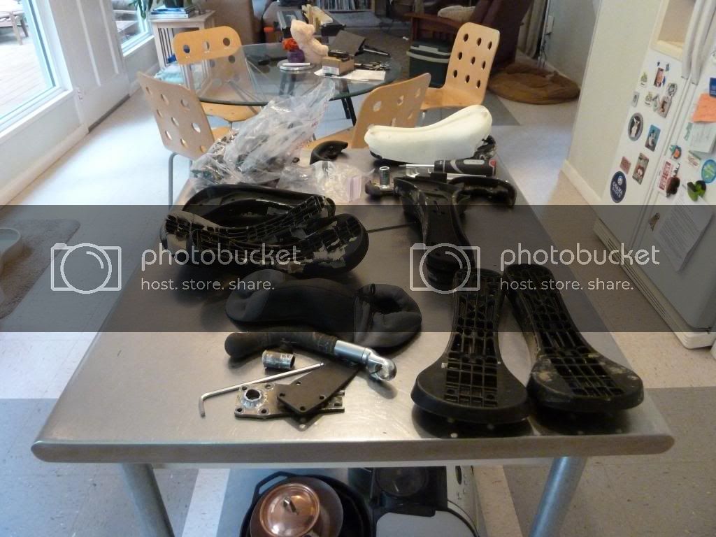

And here we are, ready for some flattening:

Multi-tasking in between seats:
The “Xtreme flattener”
Before and After:
Eleven flattened bases awaiting…
