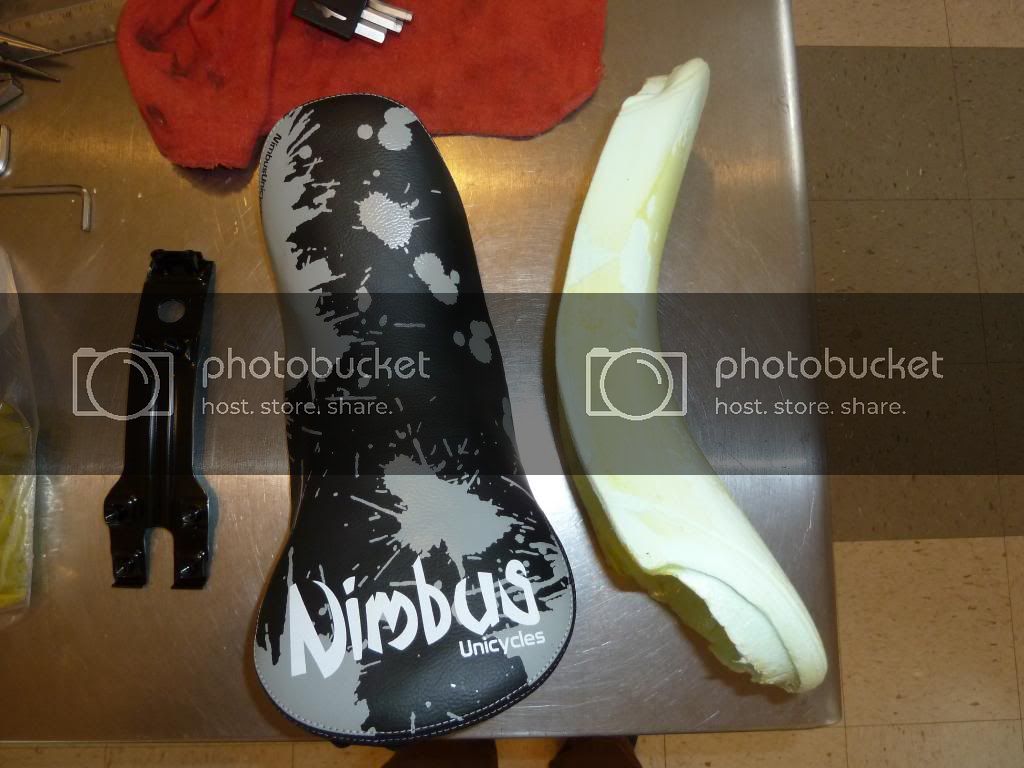

Flattened Nimbus Gel
Had this seat base completely flat in the vise while it cooled but I still got a little bit of spring back. Still much flatter than the stock Nimbus Gel.

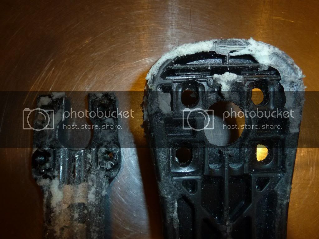

Bent internal stiffener plate to match the new curve and had to widen the holes in the base a little, to line up with the t-nuts, as mentioned by other posters.
