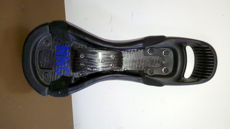

Not much to figure out- the NNC Flatfish is made for KH handles, so I’ve drilled holes for KH handles. As long as you drill it straight, it should fit.
The only thing to figure out is how to attach a reinforcement plate. With carbon fibre, the plate probably isn’t necessary. In fact, I don’t use the reinforcement plate on my plastic seatbase either, although I notice flex on the plastic base. A carbon base shouldn’t flex.
My 10 layer base feels very light, so I’m thinking about installing the KH reinforcement plate so I don’t crack the carbon. I haven’t (and won’t be) trying to break a NNC Flatfish seat just to prove a point. It will require the plate to be trimmed slightly and new holes drilled. On Peters 15 layer bases, I doubt it would be necessary.
I really didn’t mean figure out how to do it… I meant, figure out how to do it without breaking the seat and allowing me to put weight onto it. Or… If someone wants to make a stiffening plate for the flat design, I’m in. :slight_smile:
Sorry :slight_smile:
Yes, I think the seat is strong enough, although I would be more comfortable with a 15 layer base. On my 10 layer base, I would use a KH stiffener plate (which needs to be cut down slightly and new holes drilled).

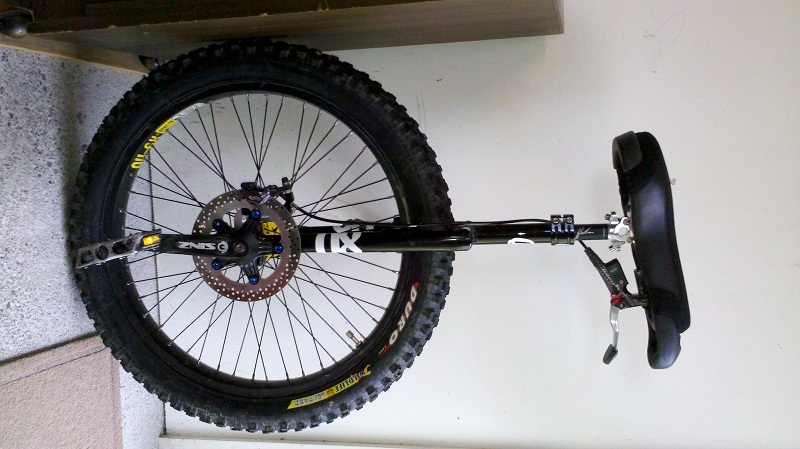

NNC Flatfish MUni

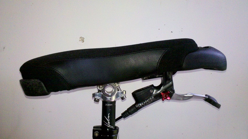

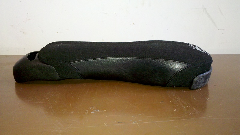

This is the 15 layer MUni version, I used a KH Freeride seat for the parts, I think I will use a KH Slim for the next one.
I have only ridden this around the back yard but the first impressions I get are very good.
No loss of control, having the handle lower feels great for hopping.
Only draw back was brake mounting on the KH bracket, needed to go all the way forward to get the brake in the right place, this meant making a new thin clamp/strap as the one that came with the brake is too big to fit. Other brands of brake maybe ok.
No flex in the base.

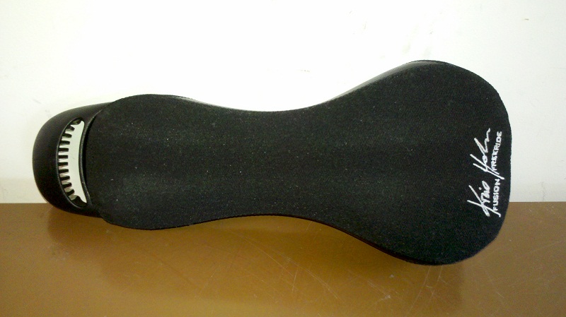

I trimmed the excess material off the cover and glued to the base with 3M77 spry glue, if this moves I will rivet as staples won’t penetrate carbon.
I looks really different on the uni, even my wife said it looks wrong.
I will let you know how the first ride goes.

It’s the same width as the existing KH seat bases. I’m not sure if Pete trimmed the seat foam ‘lip’ which overlaps the saddle though.
She said, thanks but no thanks! :smiley:
Yip, trimmed the foam.
