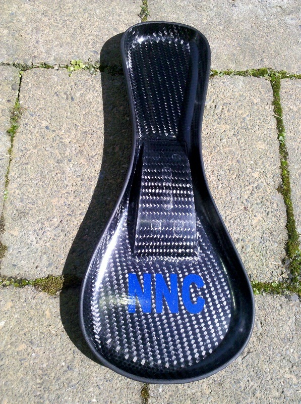

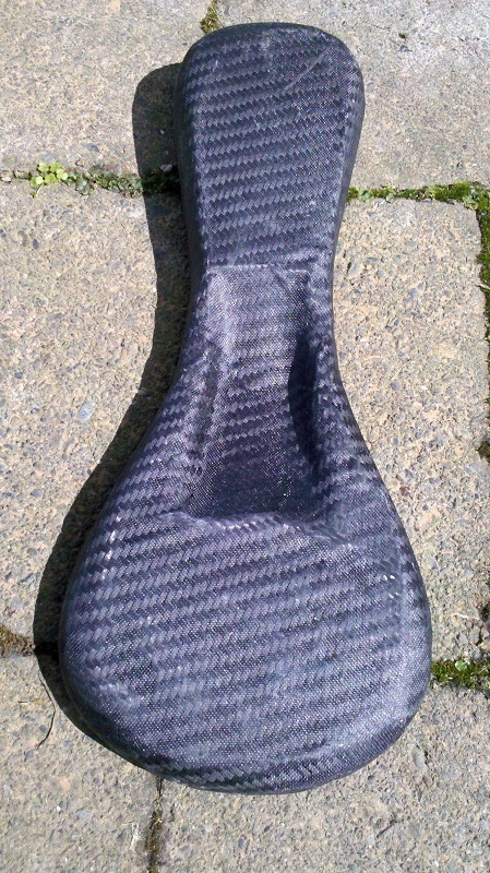

Finished the first Flatfish MUni NNC, 15 layers of 200 gram carbon with 5 doublers around the post mount, feels very stiff.
I have drilled and taped mounting points directly into the carbon and glued washer plates and nuts in behind (not shown in pics) so mounting will be with cap screws like a Freeride saddle.
Weight was 195 grams before I started adding glue etc.
He Pete NNC,
the saddle you made looks so cool, imho, and the last pics look promising too.

Dam! That looks sooo nice :smiley:
So when and how much? :smiley:
Cheers.
I haven’t worked out the cost properly yet, I suspect it would be in the $150-$170 NZD range, when = late November or early December at this stage.
