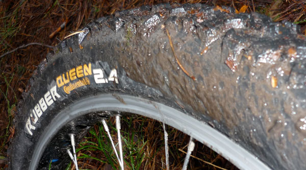

Well, I’ve been riding Continental’s Rubber Queen 2.4 since Christmas and it’s definitely the best tyre I have tried so far. It’s very large for it’s size. It just fit in the older KH26 frame but really needs the newer frame with the clearance for a 3" tyre. I’m currently running the tyre at 20 psi and it could go lower yet. Pushing the sidewall’s there is little give while pushing the top of the tyre there is quite some movement, so the sidewall strength is good.
Previously I have used a Stout 2.3 and a Swampthing 2.3 (both run tubeless as is the Rubber Queen), and this tyre is much bouncier, bouncing me off balance upon landing my first few drop-offs! The tyre manages to be both gripper than the two previous tyres I have run and faster rolling, providing a sensation of speed that I never got while riding the Swampthing. I’ve found the extra grip most notable while climbing, being able to climb more technical and steeper hills before the tyre looses grip and spins out. I’ve had no problems with wet roots and it handles mud well too.
I weighed the tyre at 843 grams so it’s a little lighter than the stout, great considering it’s extra volume, a super ‘All Mountain’ style tyre that’s well worth a try.
Is that with or without Mud!![]()
