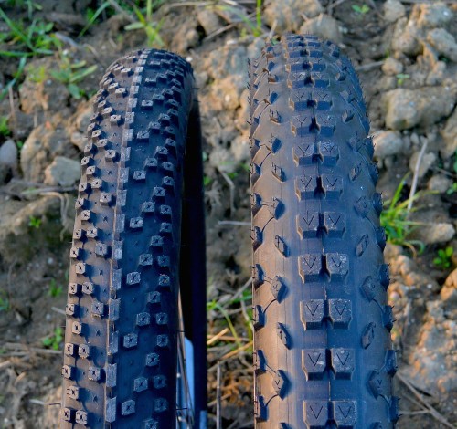

Schwalbe Nobby Nic 27.5x3.0 and Rocket Ron 27.0x3.0 are out!
See here
The Nobby Nic 3.0 is an awesome tire! I tried it on a Norco Torrent Demo bike from the company, I loved it! The nobs are big and super grippy like most Schwalbe tires. I was satisfied :stuck_out_tongue:
Nobby Nic 27.5x 3.0 and Rocket Ron 27.5x 3.0
