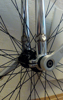

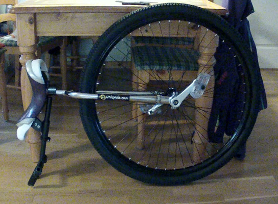

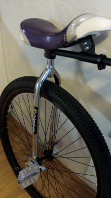

I tried to put together a true 32’er.
The main purpose was to make a uni as big as possible, but still small enough for my daughter, Nora. (During the work, I couldnt get rid of the thought wanting this for myself..). I can only say, the 32" wheel looks much more impressive in real life than in pictures. (Well, “impressive”… not big and heavy, quite the opsite!)
As a part of getting the uni small (smaller than a 36"), I had to adjust the frame. I added 4.5 cm (a bit less than 2") to a standard 28" frame, by cutting off the housing and adding a bit more of the lower part of the fork from a second frame.
In the pictures you can see that it still remain some “painting” work. I might allso have to cut down the seatpost/frame another cm, to make the uni fit the rider properly (its a question of how short cranks “we” manage to start with when getting used to the wheelsize).

Nice job on the frame!
Has she ridden it yet?
The stock tire is actually pretty nice, though I am hoping that UDC (Roger, are you listening?) will mass produce this wheel and tire.

How many spoke wheel?
The wheel is 48, but its no problem to lace it down to 36… I have a spare one sitting in the US right now if you want it?

I just put it together today, after finishing the wheelbuild.
So, no, she has not tested it yet. I guess we have to wait for the apropriate weathercondition outside first…
