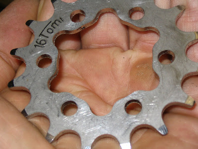

I am not really into giraffes that much so I don’t really know what is out there. Stumbled upon this on the MTBR forums. It is a cog that bolts onto the disk mounts for a MTB hub. Should be perfect for a giraffe in my opinion. There is no way this thing is going to screw off.
tomicog

Saskatchewanian, Thanks for posting the pics and the link; I am familiar with the Tomi Cogs, but wanted something more readily available for my giraffe, so this is the option that I chose after considering price, availability, and the lack of a definitive answer about thread-on cogs being safe on giraffes based on the quality of componentry and skill of the mechanic installing said componentry.
Perhaps some other ambitious giraffe rider out there has used, is using, or would like to use the Tomi Cog and present us with a definitive answer regarding that particular product here on the forum.
