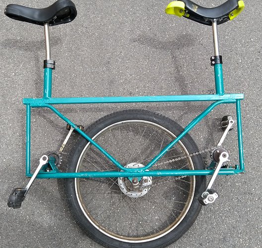

That’s definitely wrong. You don’t need the same weight. You can balance this by moving the mass center to bring it above the support point and that’s by tilting the tandem. I drove the tandem with people weighing much more or much less than me. Recently, we reactivated our tandem after very long time:

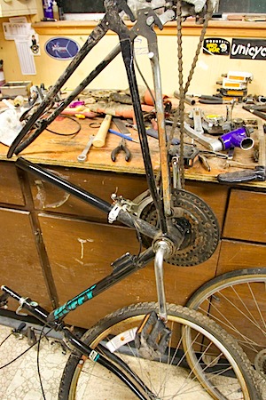

Mine is made from the rear halves (seatpost back) of two old girls schwinns, with horizontal dropouts. That is what was available back when I was a young man. You can see it in my album just click on my name and you sill be directed there.
Lobbybopster
some tandem unicycle details
ok, I put some pictures of construction details online:
http://projects.feuerzeuger.de/tandem-unicycle/building-the-tandem-unicycle/
Very nice, thanks for posting.
I like that you used a motorcycle wheel. Makes sense for the added weight. :slight_smile:
