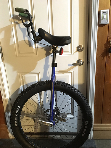

Gotta show my upright stance bars with a starfighter brake within both middle finger’s reach.
When I put a light on for night riding I can rotate the brake lever to one side so the starfighter doesn’t cause a shadow.
