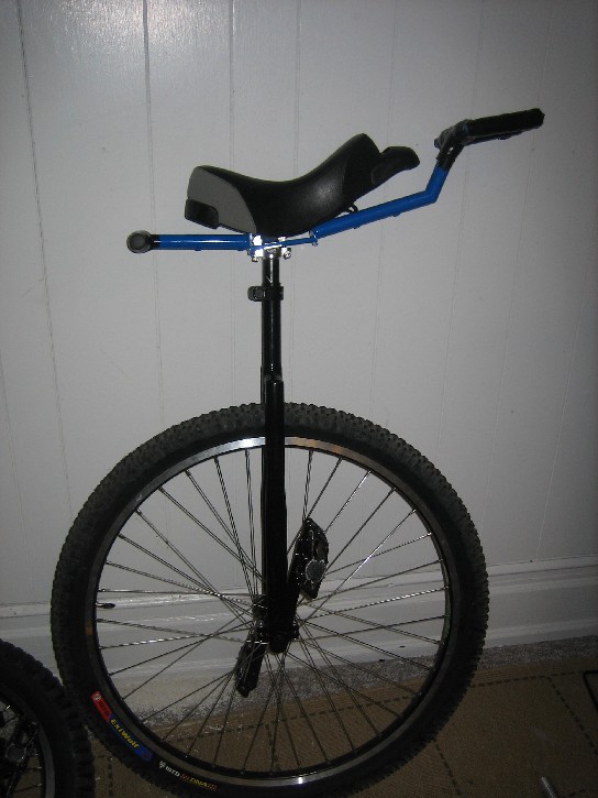

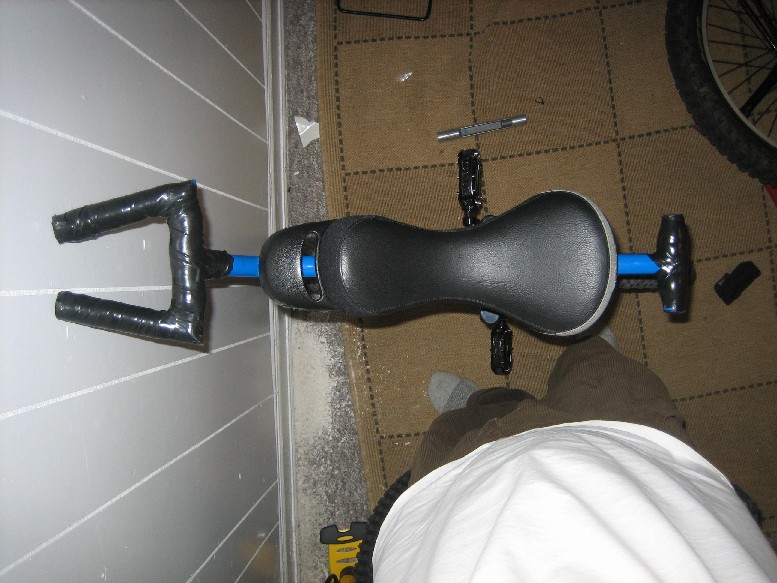

My 29er with the T7 and handlebar wrap.
Wow, thanks for posting the pix bluntRM! That really helps a lot. The 29’er with the T7 looks more ‘proportionate’ than I expected. Nice.

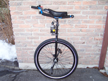

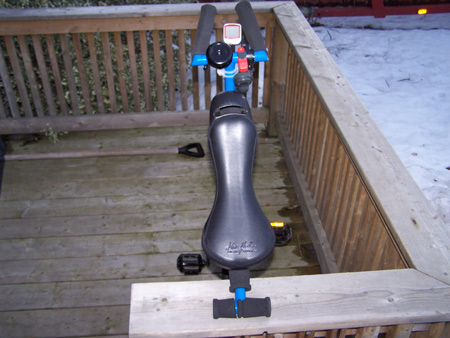

my first picture upload
Pashley Muni Frame
29" Keba Rim
Big Apple Tire
5" cranks
KH Freeride Seat
T-7 Handles w/foam grips
Air Horn
Sidewalk Bell
Cycle Computer
