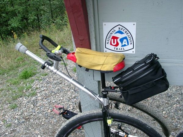

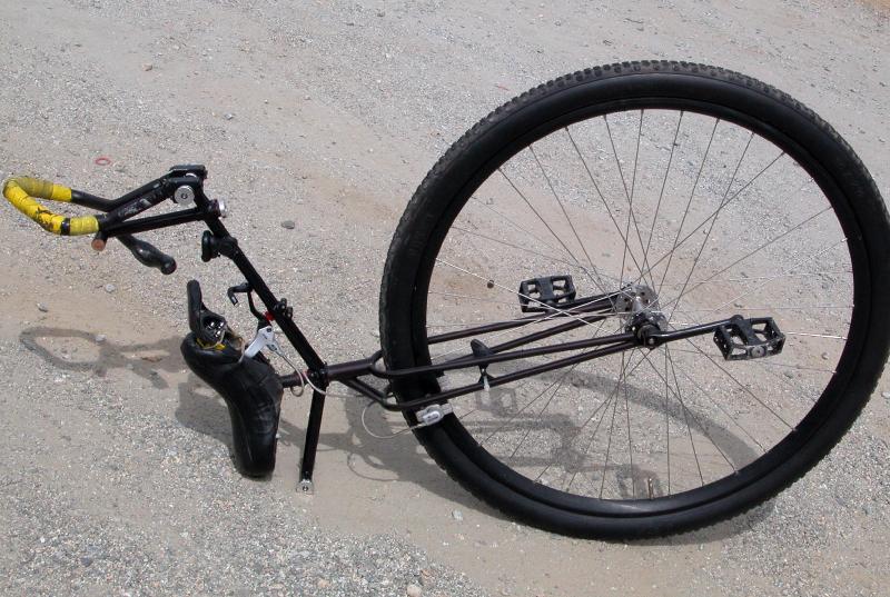

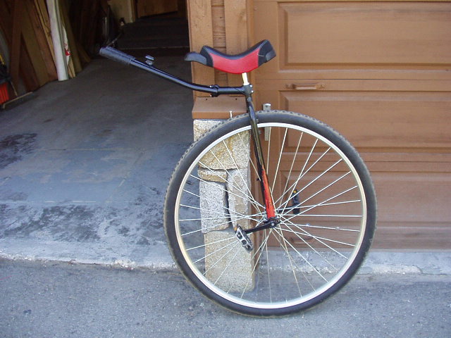

Anyway, here’s some pictures I’ve collected. Does anyone have plans to making a handle? Where to buy parts, dimensions, etc?

First pic looks like a JC got excited right before a ride.
is the first pic a guni??

The GB4 is quite a nice design, there’s one on the uni lying on the floor in your first photo, and being simple it wouldn’t be too hard to knock up your own. Only thing is as it mounts to the seatbase rather than the post you may need to go to a carbon seat base to get the handle stiffness you want.
Personally i have the T7 handle in your third picture and its sweet as, fits my brake handle bell and cycle computer on and gives great control.

No, it’s JC’s GB4 36, photographed here along the scenic Iron Horse Trail in western Washington. Direct drive, no gear, not that you’d know that from trying to keep up with him. We limit his speed by forcing him to carry a small cask of wine and all our tools in that big suitcase he has on the back.

That’s actually doc’s KH 36. My handle is more modest. :o

Of course it is. The seat was bugging me even as I wrote the post, as I couldn’t really remember your’s ever looking quite like that. But I forgot Doc built out the Big Boom.

You need your handle to be pretty stiff so that it gives you a good control of the uni, and you can use it to lift your weight off the saddle for comfort without it flexing too much. Most of the handles pictured here are metal poles connected to the seat post/frame, and as such are very stiff. The GB4 handle bolts to the underside of the seat at the front, and it’s additional length means that you can put large forces on the seatbase and cause it to flex unpleasently. One solution is a carbonfbre seatbase, which is stiffer and stronger. I hope that clears up what i meant.
I have the T7 on my 36’er as well which I enjoy very much. I notice from the first two photo’s that the owners ran into the same problem I did. The hydraulic line for the magura brake is too short to place the lever where I really want it. I’ve had to compromise and install it under the seat. It’s not the worst place to have it but I’d rather it be where I place my hands while I ride.
That 1st pic looks like a walking stick was welded to the coker. :smiley: :smiley: Anyway it’s all good and good luck to you. :slight_smile: :slight_smile:

I had that problem too, but i got a service kit and extended my brake line to the exact length i wanted. My muni has the brake handle under the seat and my T7 setup is so much nicer, it’s so good to be able to reach it with one finger without moving my hand.

Kokomojuggler, have you seen the T7 handle available from UDC? I was planning on building my own from bicycle parts until I saw the T7. In my humble opinion it’s perfect.
