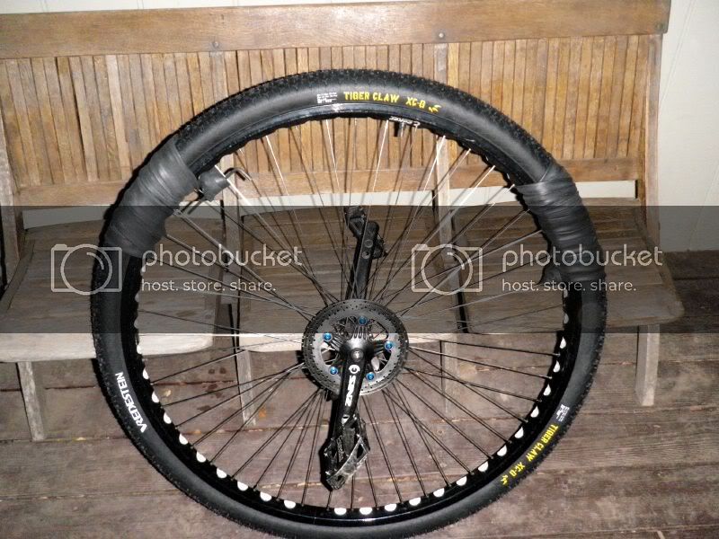

In this tutorial I am using 2 26” Vredestein Tiger Claw tires to make one 36” tire.
I used very basic tools/materials. My tools included a knife, pliers, Marine Goo, sewing needles and fishing line.
First I took a sharp knife and cut through the rubber in the tread section being careful not to cut the casing cords. Next I used the pliers to carefully peel back the tread rubber exposing the casing beneath. Peeling the tread rubber works better in one direction than the other due to the casings construction.

Once the joints are all sewn up you can throw some glue in the joins and then mount the tire on a rim with a tube to squeeze the casings together ensuring a good bond. Let sit overnight.
Remove any glue that squeezed out then glue down the flaps. I used old innertubes to keep pressure on them while the glue cured.
And that is about it. Once it had time to cure remove the wrap, install your wheel and go for a ride!

When riding, is there a bump at the sewing locations?
