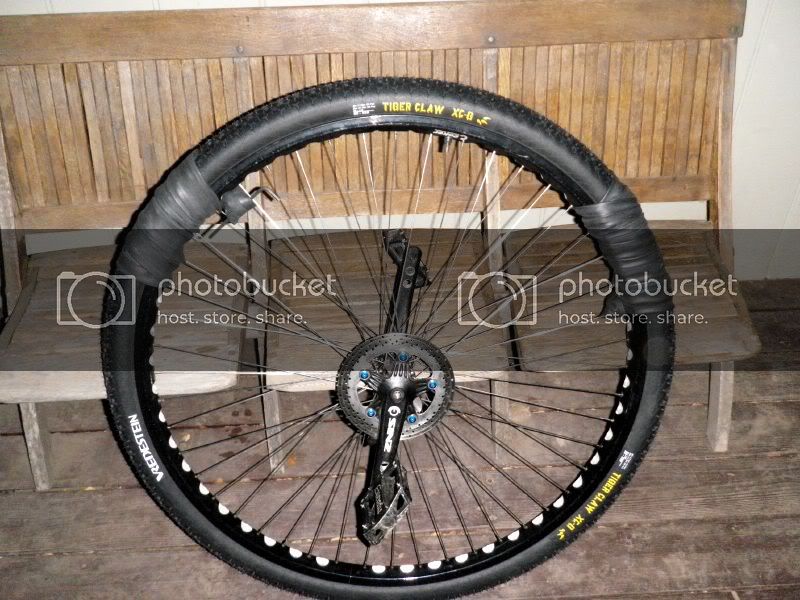

Here is a quick tutorial on how to cut and re-join tires to fit a different sized rim.
I have found through experimentation that it is best to use kevlar beaded tires as they are easier to get a good join at the bead than wire or cable beaded tires.
In this tutorial I am using 2 26” Vredestein Tiger Claw tires to make one 36” tire.

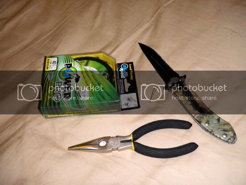

I used very basic tools/materials. My tools included a knife, pliers, Marine Goo, sewing needles and fishing line.

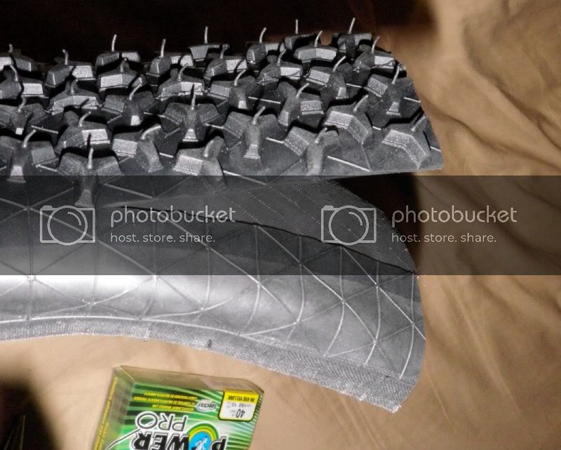

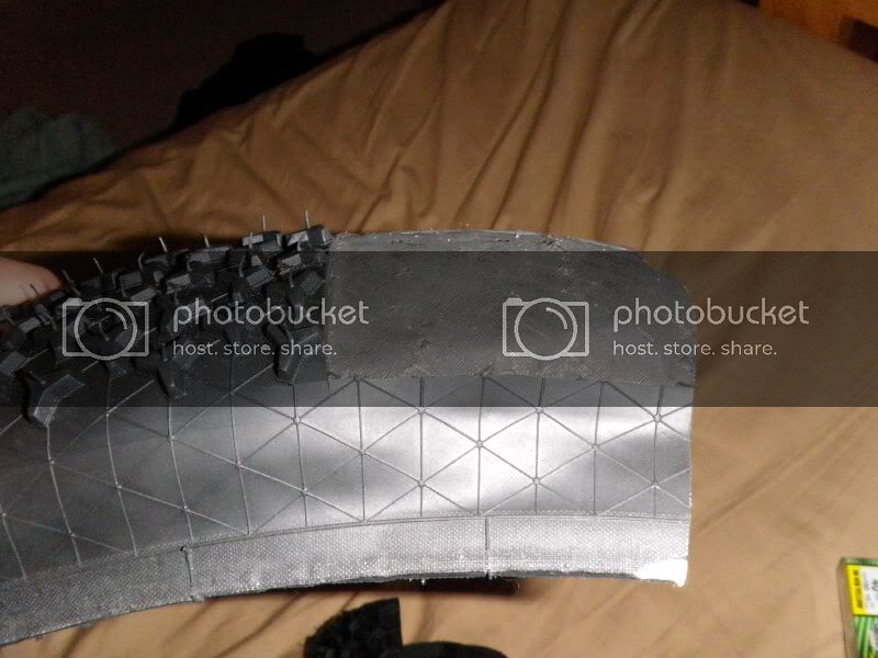

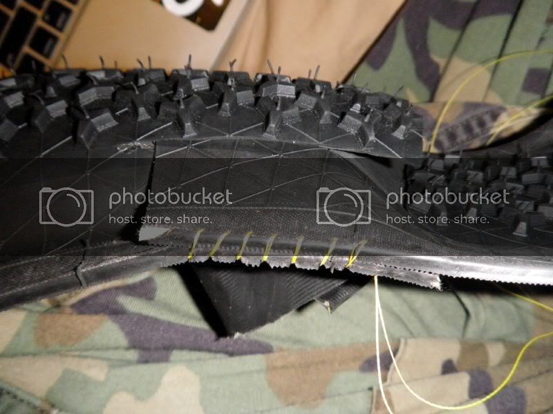

First I took a sharp knife and cut through the rubber in the tread section being careful not to cut the casing cords. Next I used the pliers to carefully peel back the tread rubber exposing the casing beneath. Peeling the tread rubber works better in one direction than the other due to the casings construction.
After peeling enough rubber back for the join you can cut the tire and peel the other side removing the tread rubber instead of leaving a flap.
Calculate how much tire you will need to add/subtract to get your target size.
I found that counting the tread repetitions and doing a bit of arithmetic worked better than trying to measure the bead lengths since the tires don’t lay flat and have a small amount of stretch. Remember than 24” tires have a 507mm bead diameter, 26” = 559mm, 29/700C = 622mm, and 36 = 787mm
Peel and cut the section you are going to add to the tire.
Most tires will have a mold release agent on them, which will prevent glues from bonding properly. I used some sandpaper and rubbing alcohol to prepare the surfaces for bonding. I also perforated the upper side of the join to allow excess glue to squeeze out.

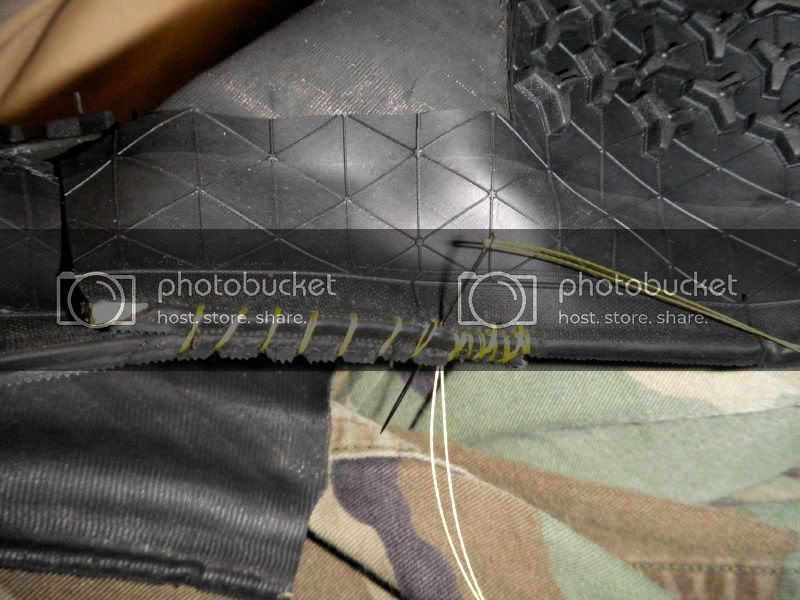

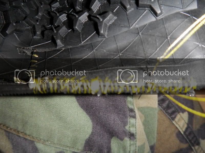

This is where we finally get to start sewing. I first did a pass going around the beads just to hold everything in place.

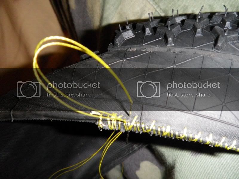

Next I made a back pass sewing through the beads and around the bottom pulling it tight every time.
Finally I did a third pass through the bead and the edge of the casing for good measure.
With the first bead done I sewed only the visible side of the join on the sidewalls and under the flap, then sewed the other bead.
Repeat the process for the other join.

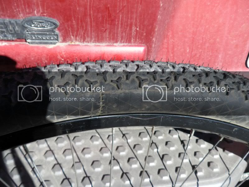

Once the joints are all sewn up you can throw some glue in the joins and then mount the tire on a rim with a tube to squeeze the casings together ensuring a good bond. Let sit overnight.
Remove any glue that squeezed out then glue down the flaps. I used old innertubes to keep pressure on them while the glue cured.
And that is about it. Once it had time to cure remove the wrap, install your wheel and go for a ride!

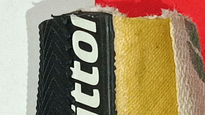

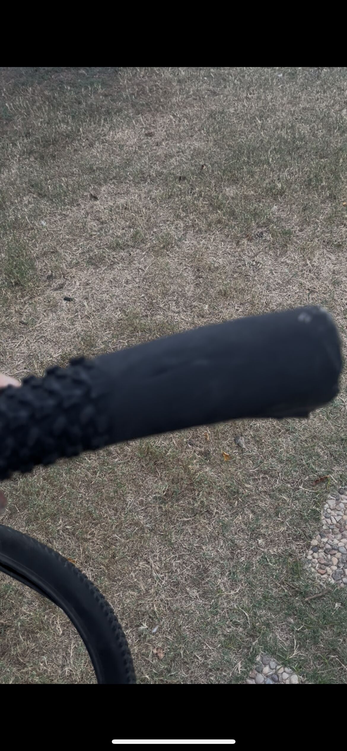

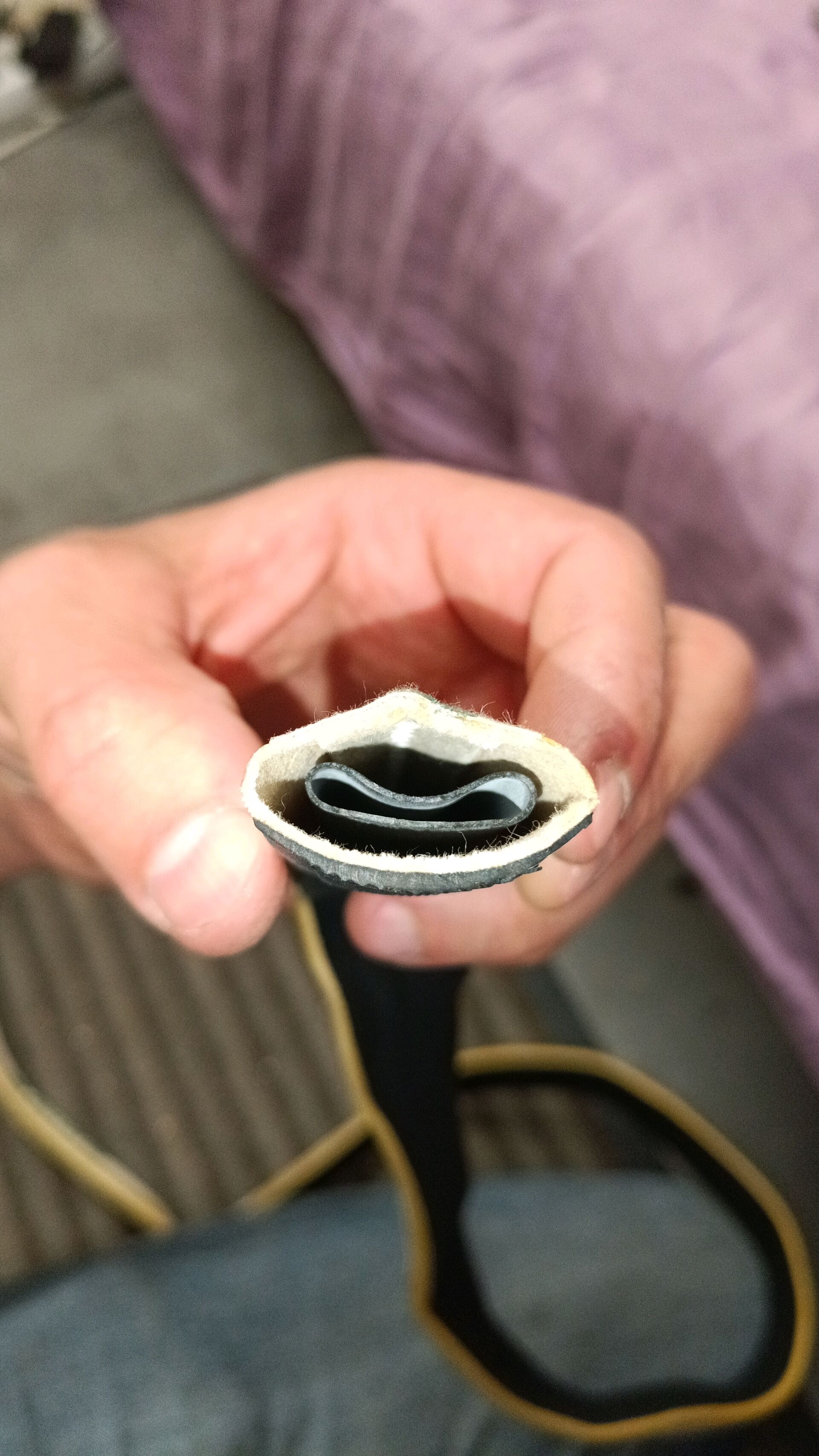

I wasn’t able to peel my tire, I tried two different tires.
@Nathan_Moore
The tire:

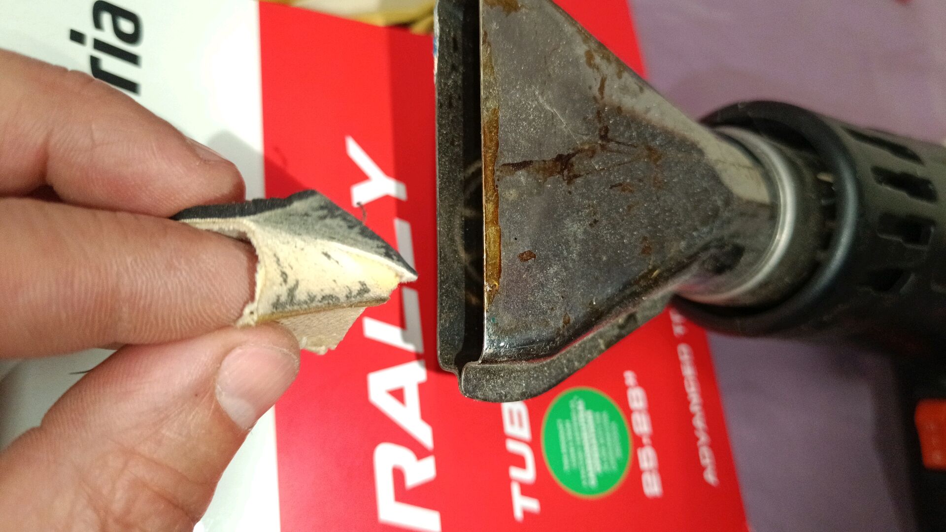

Hot air did not work:

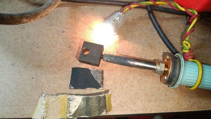

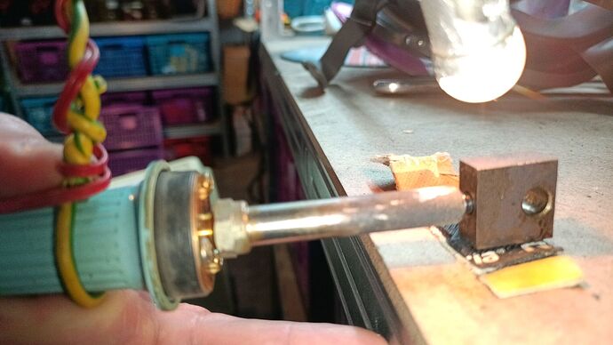

I created a heated block as tip of my soldering metal, originally to clean the nozzle of my 3d printer. That works well and is very precise:
First heat, then pull/peel off by hand. When pulling, watch out for the mesh. Only pull alongside the threads or you’ll rip them up.

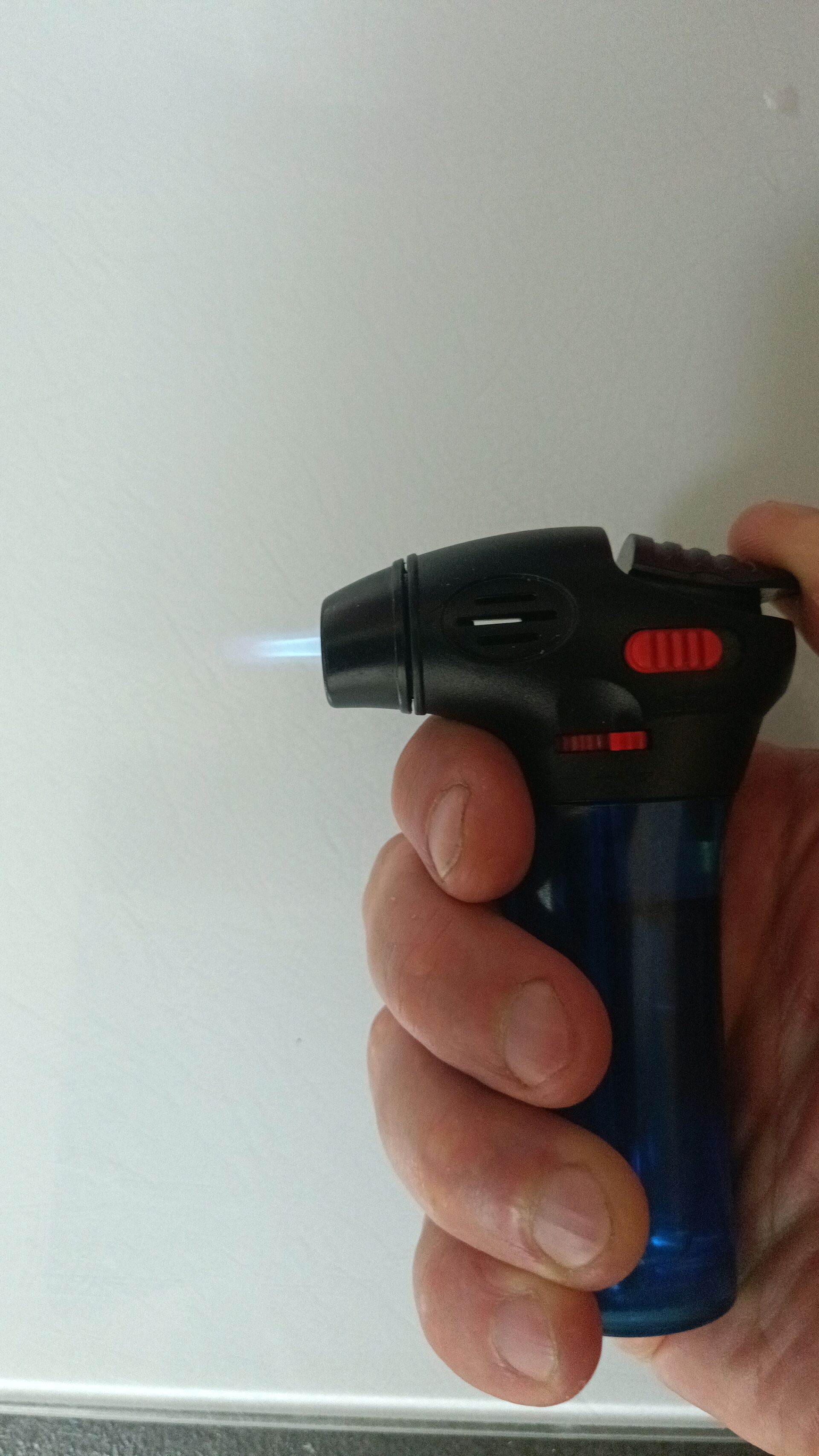

Maybe in your case as a principle, the tip of the soldering metal could be a blade of a knife to cut with heat. I guess you require even higher temperatures than I had. A lighter with a focused flame could heat your blade:

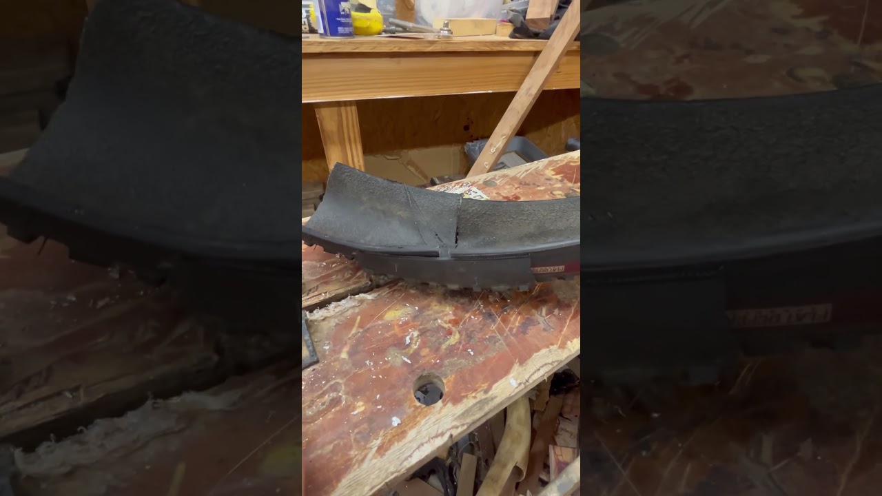

Watch some youtube tire tread cutting videos. They do it with intense heat on a blade structure. At 18:00 min:

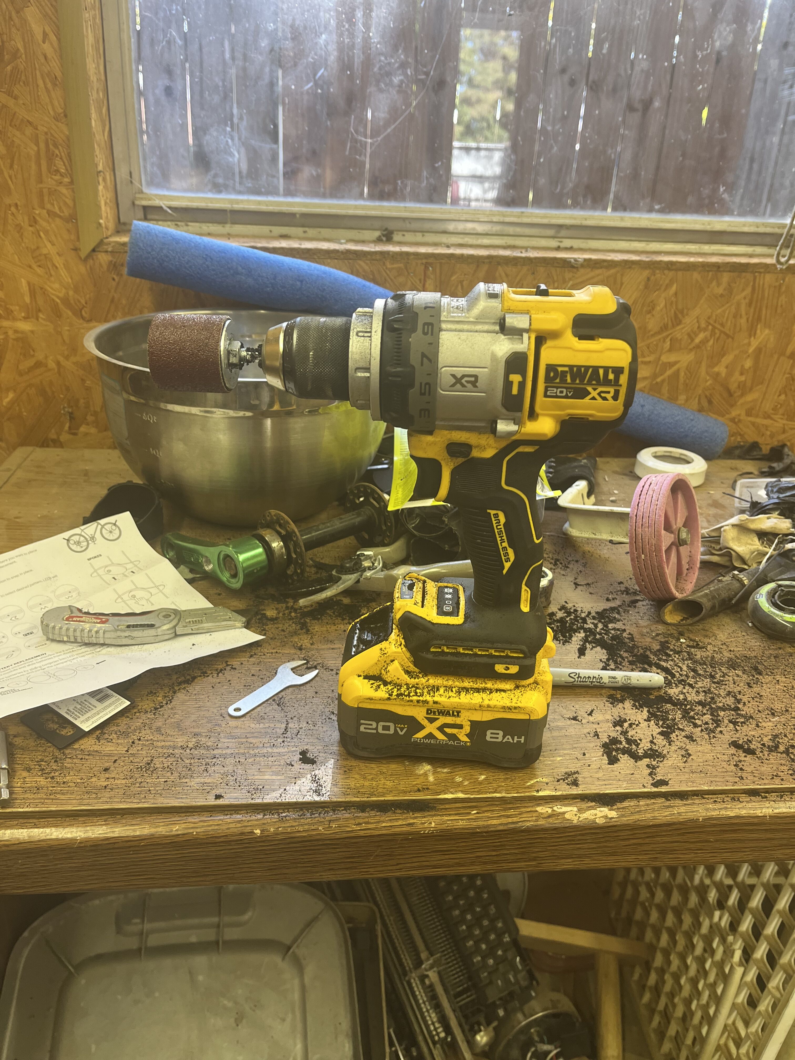

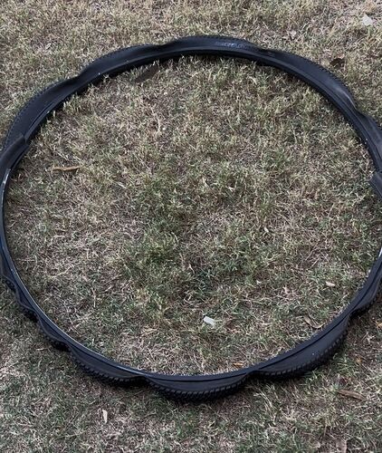

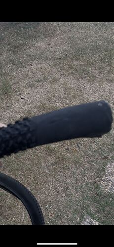

I wasn’t able to peel my tires, (Still no lighter) so I sanded them instead, there wasn’t enough tire to put on my 45” rim so I’ll do a benchmark on my 36” first and buy some tires for the 45” later
Which tools did you use, an angle grinder, a belt sander, even by hand? And why did you choose 45", because of the pre-drilled spoke holes of the original rims?

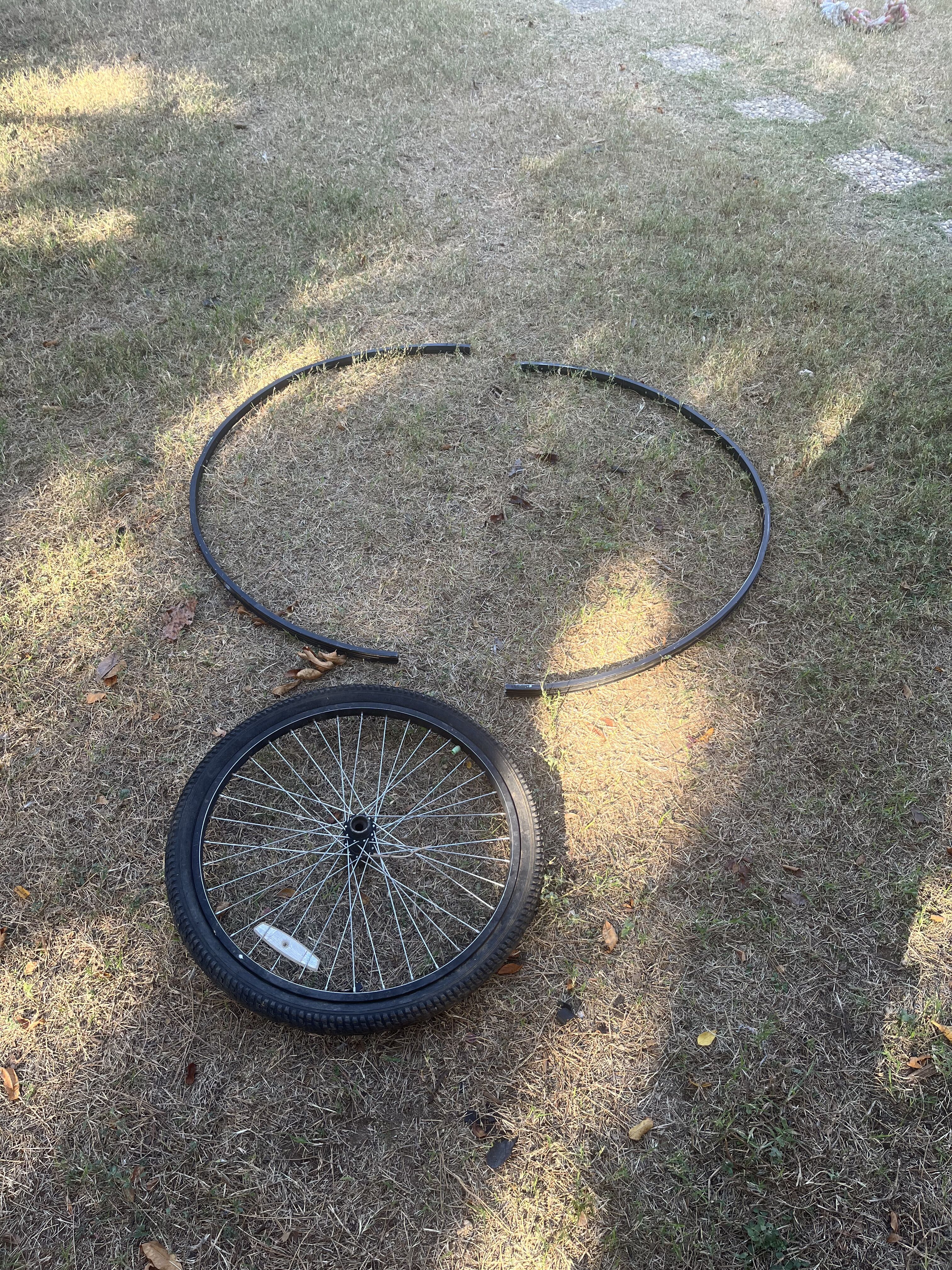

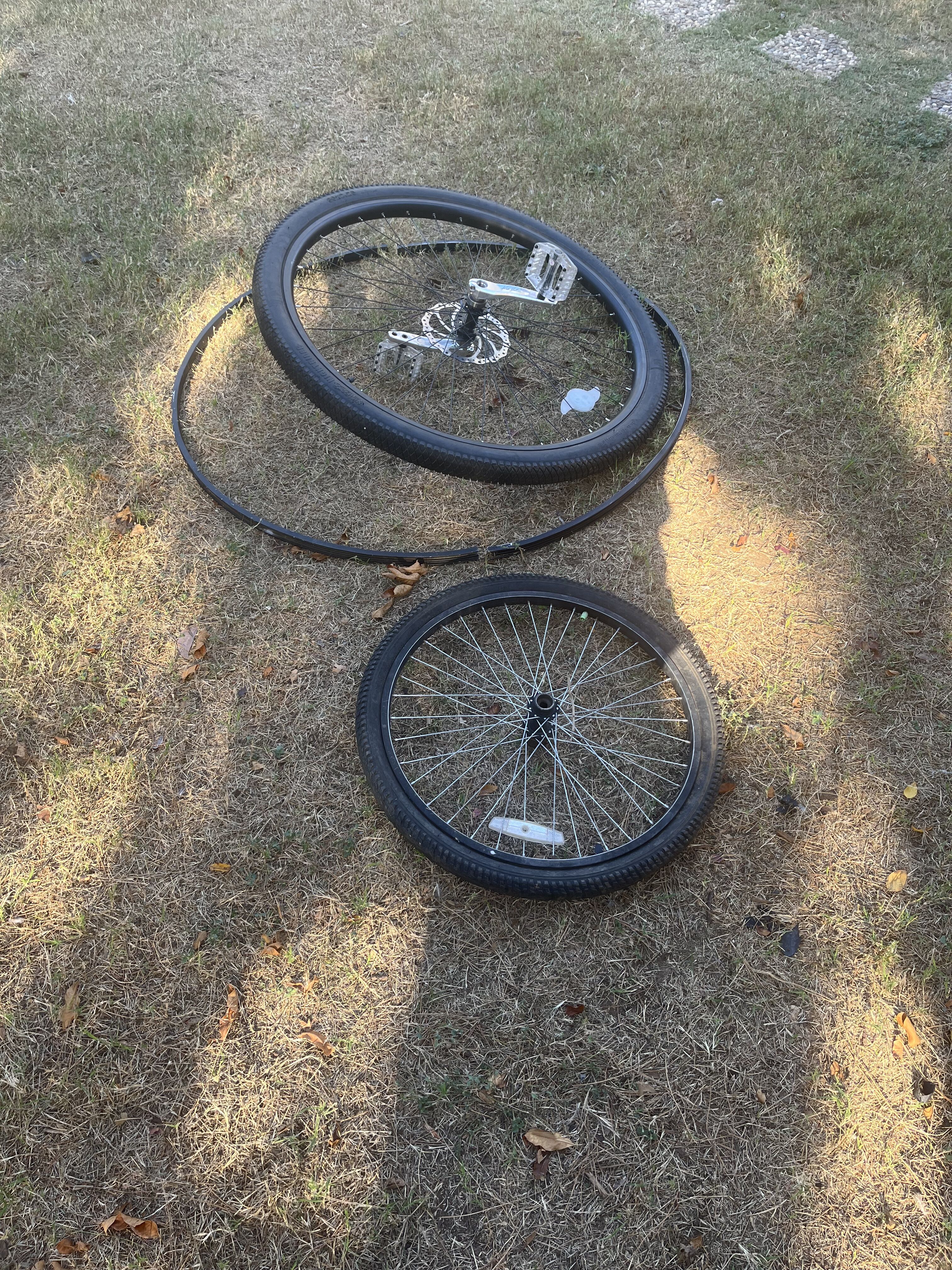

I had 2 26” rims and cut them bent them by hand which ended in a rim 45” in diameter but the last 2” on each side dont cooperate so they need to be cut off and replaced, I do have an identical 24” rim that I’m going to use for that. Spoke holes were an afterthought though I will have to check that before I make the final weld, the rim is currently in two pieces. I used a drill with a drum sander attachment. Shown here is the drill, and the rim and 24” “fill rim” and a 36” for scale.
Also if you haven’t noticed, the bike rim is not the tire size, the tire size is the overall size where the rim is a few inches smaller. For example the diameter of a 32” rim is actually 28”, the tire and its width determines the overall size.
