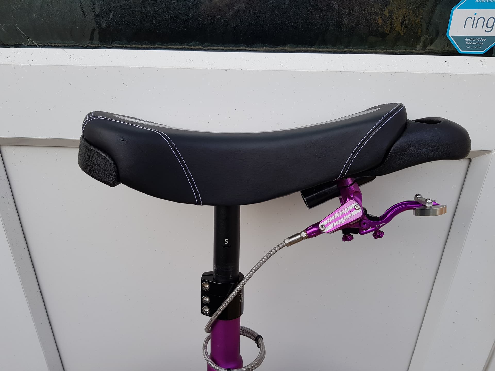

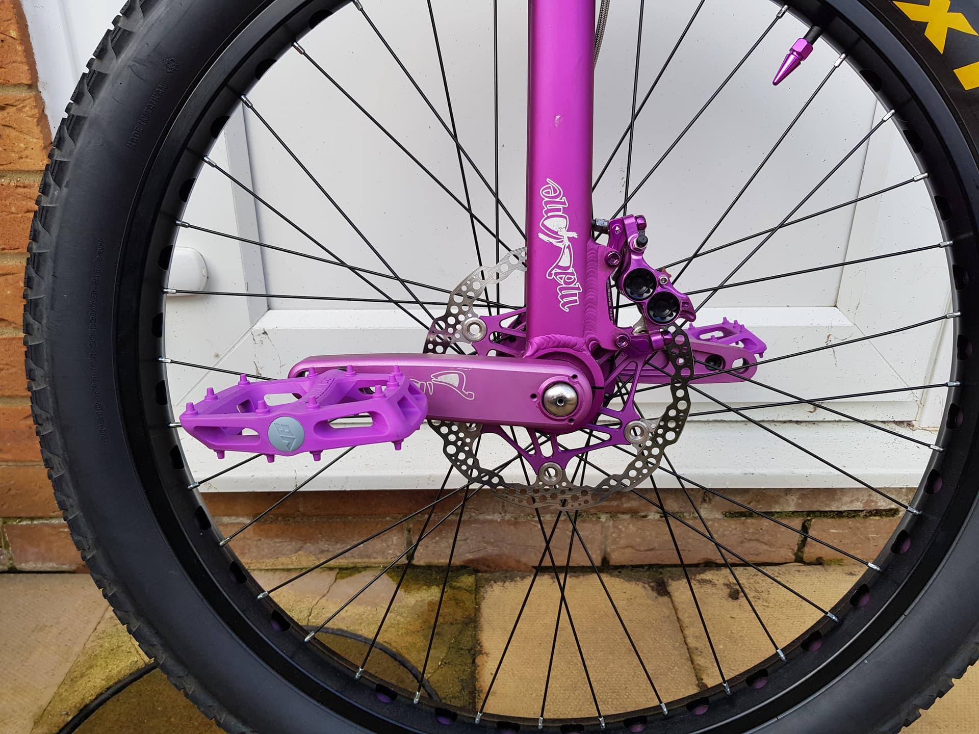

On my 36 oracle I have a Hope floating rotor 203mm, Hope E4 brakes and a medium density brake pad.
The brake is smooth even on steep descents.
Personally going with a smaller rotor especially with 160mm I think It will be too small.
Originally I had 180mm and went up to a 203mm
A 4-piston brake would probably do the trick. The BR-MT520 is such a brake, so go for it :grin:

One thing to be careful with is going smaller disc might cause the caliper to foul on the spokes as it moves it in closer.
A 36er is worse than a smaller wheel, due to the spoke angle.

@Bernhard Careful trying a 160 rotor, generally this size is used a rear on a bicycle. I put one, on one of my unes, and the 160mm adapter just did not work as the caliper fouled on the mount, so 0 adjustment for the pads, only way I could get it to work was to jack up the caliper with a couple of washers, then it did not sit on the rotor right. 180 or 203mm.
Try giving your caliper a good service and clean up, especially the pistons. Clean up everything with Isopropol alcohol spray, rotor incuded.
Then pop in some new pads, again carful on choice, I over speced and put the top rated uber pads in, and for me unrideable. They would just snatch the rotor even with the lightest pressure. Swapped back to the std Hope pads and its lovley, just perfect.
Shimano are good brakes and do the job, I have the 4 pot, on 3 unes and are very good. However, my 1st choice would always be Hope brakes, a quick twiddle of the biting point adjustment screw and its fine, takes about 4 seconds. No faffing with allen keys. The Tech 3 E4 or Tech 4 V4 are both std IS mount and give full adjustability.
If its smoothness and adjustability you want, that would be my choice. The Hope floating rotor is thicker and more soild, than a std Shimano rotor, so if you have a bigger wheel, then a good choice. I had it set up on my M4O freewheel flick flock une, where smooth controlled braking is essential most of the time.
Dont forget if you move upto a 203mm rotor you will have even greater braking force. Personally 180mm is about right for most unis. Finally I am pretty sure that shimano brakes should only use resin pads. Why not sure, but thats what it says on the the shimano 4 pot calipers info I have.
