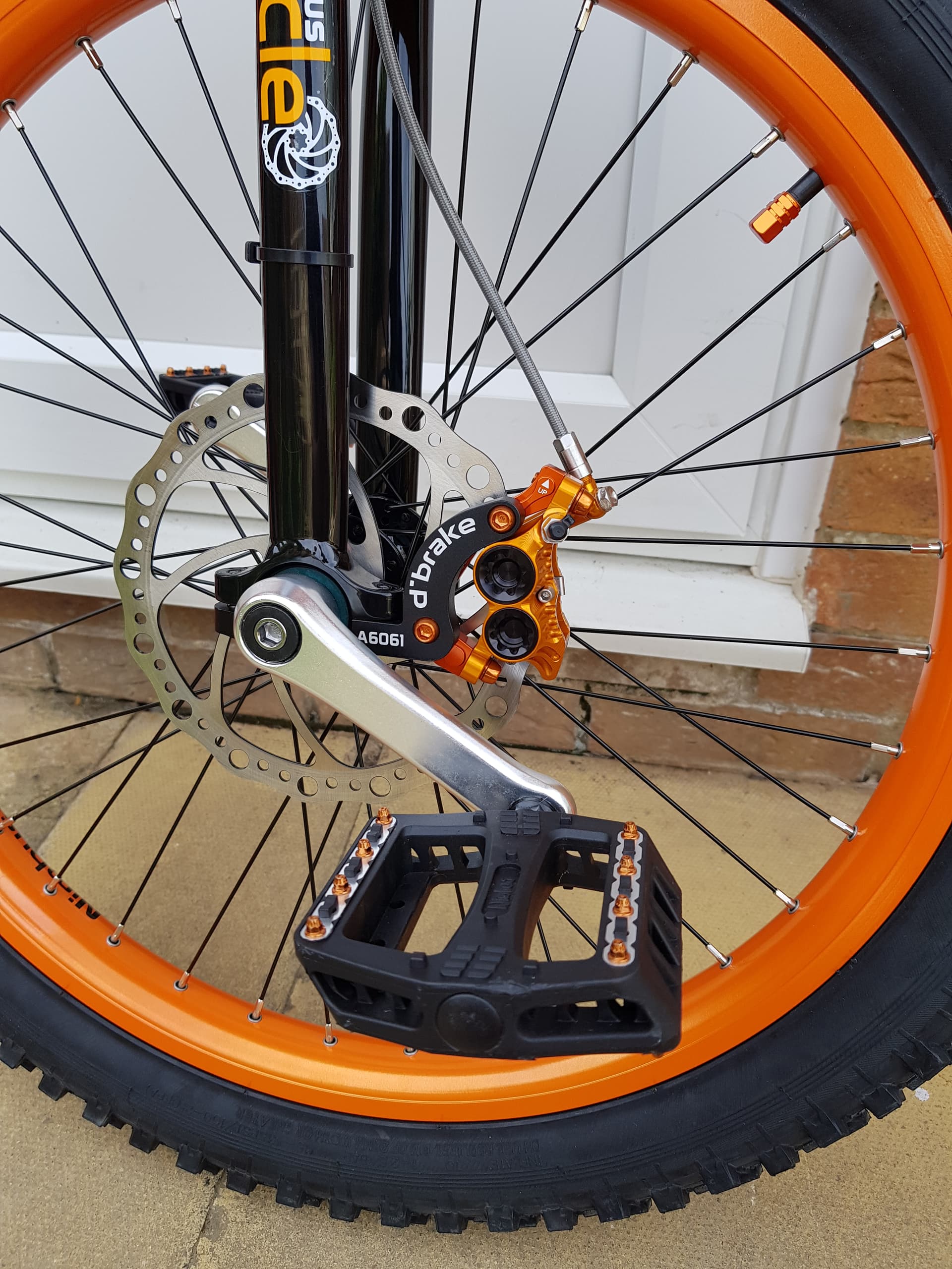

Smoother braking
In that case, any fresh brake rotor will probably be a major improvement. A consistent brake is a smoother brake and a grease spot will make any brake inconsistent. As the first start, I would just get a 180mm disk.
Make sure to clean up the pads (or replace) to get rid of all contamination if you keep the same brake. Perhaps a fresh bleed, clean & lubricate the pistons, just generally make sure it is in good working order. It’s a very common setup, if it is working normally, it should be totally usable.
You can of course swap in the BR-MT520/BL-M4100, I personally would not expect any major improvement, but worth a try since you have it around.

Initially I had a single piston 160mm on my 36 and braking gave me some trouble. I now use a Zee (simpler Saint dual piston) with 203mm and braking is never a problem, even on steep muni downhills.
So, I would say 180mm is okay but 203mm is better.
But I did get what you’re getting at. A few years back when I first upgraded to a 180mm disc on my 26" muni, I felt the brake modulation was too “digital” meaning on/off, so I changed back to 160mm.
Now I would say that a more powerful brake/disc generally makes it easier to modulate.
As has been suggested, brakes are different as are pads.
As a first and less expensive step, I would replace the disc and use organic pads.
If that doesn’t work, then I would try a dual piston brake. Lastly, then upgrade to 203mm (for 36 muni very nice to have, but for road 180mm should be more than sufficient).

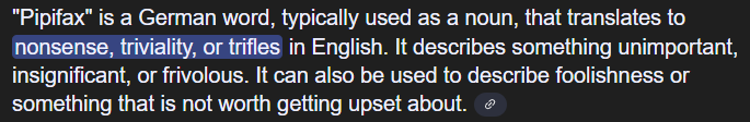

Pipifax is only available with the QUAX interface, right?
If it only has to do with QuAx, then that is your answer to trying a freewheel from a different brand.

maybe it’s the calibration of my monitor, but I see purple
