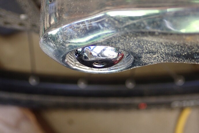

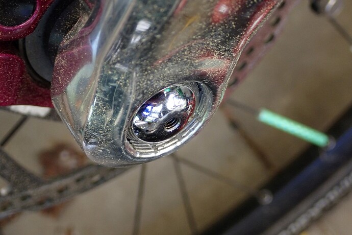

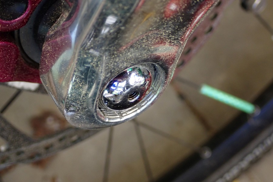

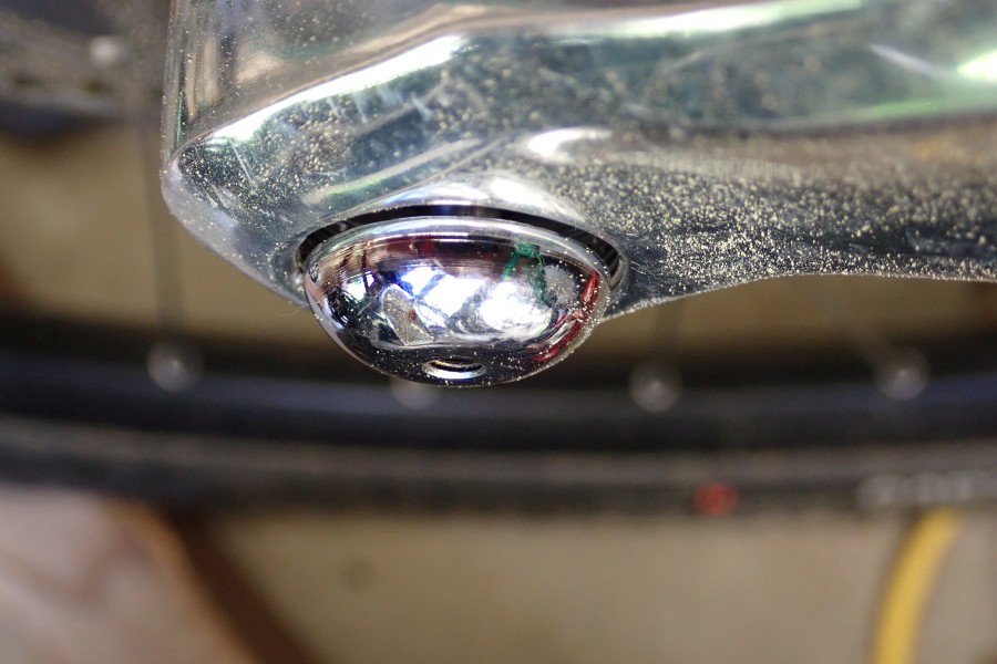

Pictures
Out (as explained, I adjusted the knobs to stand exceptionally far out):
In:
In, different angle:
So you only need one ‘plug’ that you can screw into the crank on the side that is pushed in.
The other side doesn’t need anything as the button can’t get pushed in because the plug at the other side means the shifter rod can’t get pushed through.
3d printing the thread might be a bit challenging, but one of the cotterless crank dust covers might work as is.
