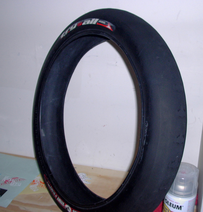

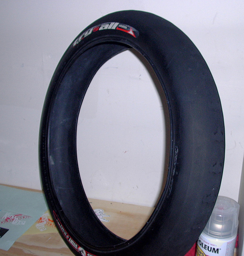

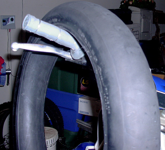

I finished shaving all the knobs off and started on sanding. Its starting to look pretty cool

Almost done with sanding one side, should be finished in about 30 min
Done

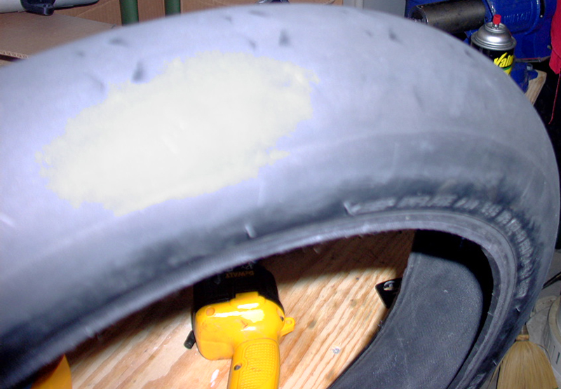

an angle grinder will set your tire on fire pretty quick and they suck to use.
i tried it when i shave d my tirea and i was prety close to setting it on fire.
so i stopped.

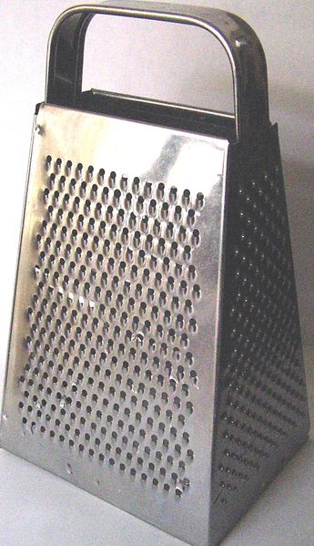

a planer works much better.
yea a planer…hang on Emile, ill post a pic..
but the kind that looks like a cheese grater…
it worked for me perfectly.
i got a ton of tire off before i accually started sanding.
like from start to finish?

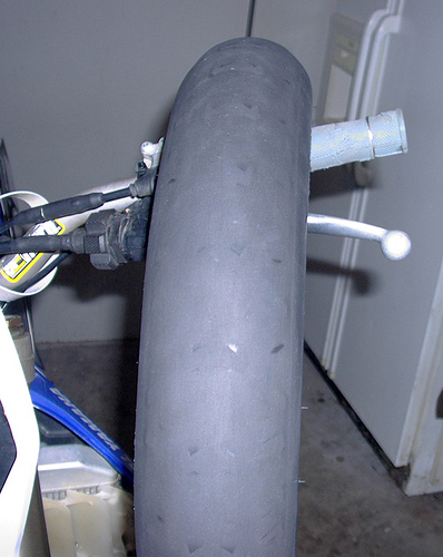

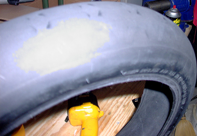

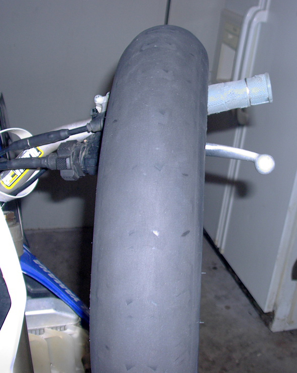

well i did this method…
first used a hack saw…
then used the plane, kinda looks like this
then i used a sander with 60 grit paper…
Bench grinder is by far the most efficient way I have ever seen, easy, and did not melt, burn, or catch on fire.
