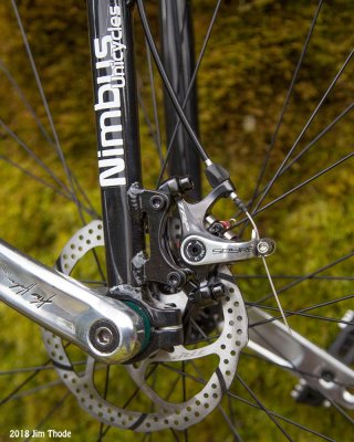

I measured the space between the disc and the spokes and it comes just under half an inch. Which is too little to fit a current caliper as everyone has switched to dual pistons. Lobbybopster dealt with this problem using a Coda caliper - single piston. I’m trying to find one, but no luck yet. Anyone can point me to a single piston model still in production, that would be great. I’m also looking at the second hand market.
Another option would be a cable operated disc caliper, they seem thinner but I have yet to find dimensions on the web. Looks like the Shimano CX77 could be a good candidate -single side- or the TRP Spyre but the dual side operation could make it too thick.
I read somewhere that calipers for trial bikes are narrower, but then again can’t quite find dimensions out there.
I can also gain a couple of mm by bringing the disc closer to the frame, won’t be enough for a regular hydraulic caliper though.
I measure a minimum space needed between the disk and spokes on my TRP Spyre mechanical caliper as 11/16". Looks like it would be too thick.
