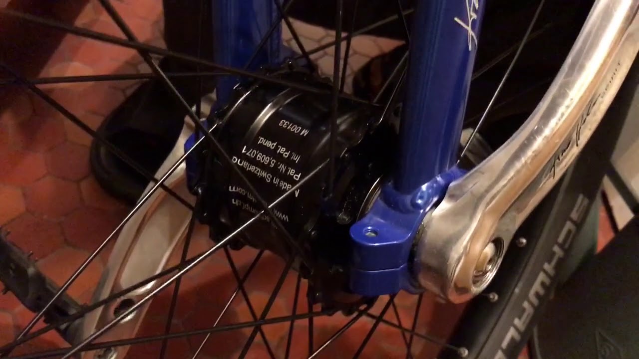

Tech question for the Schlumpf owners out there: my wheel has some play, which I assume is normal. Is it the case with yours? And how much? I have about 2mm at the rim (easy to measure with the Magura brakes) on the 29" wheel.

Sound like you managed to get a tight one. I’ve had seven of them. They only get worse with use. If you ride enough you will get use to the side play and gear lash. I’ve had enough side play that I’ve used the rim brake to keep the tire from rubbing on the frame when traversing side hills. That was just about when I decided to trash it.
JM
There should be no sideplay in the hub! My hub now is back at the Schlumpf workshop in Switzerland for the second time now because of side play issues. Florian Schlumpf told me, that there shall not be any side play and if one recognizes side play, the hub shall be repaired.
Interesting because he told me it shouldn’t be a problem to have some play. His secretary in on holidays at the moment, but I’ll be in touch when she’s back as they keep track of all operations done to the hubs. Mine is supposed to have been serviced not long before I bought it. So I’ll know for sure.
smal side play of the tire that causes in high play of the hub is no issue
axial side play of the hub is an issue
I’ll make a little video to show the problem, might be easier than describing it.
Eric, didn’t you have a similar problem and filmed it?
Ok now I’m freaking out a bit… so I filmed it in my kitchen!
https://www.youtube.com/watch?v=kImvKsjfCkc
It’s hard to tell from the video which parts are moving and hoch much, couse the cam is solid to none of them. But when the hub body is wobbling sideways while the axle is solid, then it should not be ok.
Florian told me for my hub, that it’s not ok to have this side play and it should be repaired, but he also said, riding so will not cause any additional damage to the hub.
Have you aksed Florian about your hub?
It’s a bit easier to see it if you go to the youtube page and make it full screen. I’m still waiting for feedback from Florian. Hopefully I’ll get some news today.
