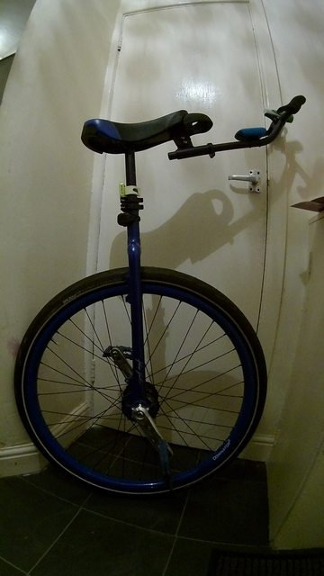

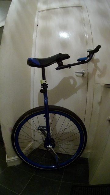

I finally took the bait and added a handlebar to my Guni. I am pretty comfortable riding without one, but figured if I’m going to use this for racing I might as well make it faster!
The fact that I have an easy place to stick my Garmin and headlight is nice too :smiley:

PIece Maker, I think your next move is a rim brake! Totally makes sense with a Schlumpf and bars. I know… it goes against the “uni-simplicity” but hey, you’re already away from that!

I’m considering a brake - I do find it really hard to stop from a high-speed sprint especially when tucked onto the handlebars, and especially when I’m using the short crank holes (Gotta beat Mowcious next year!). I’ve never ridden with one though so I’m not sure this is the best way to learn, plus I’m not sure if the blue Nimbus rim even has the tracks for it being a disc wheel!
