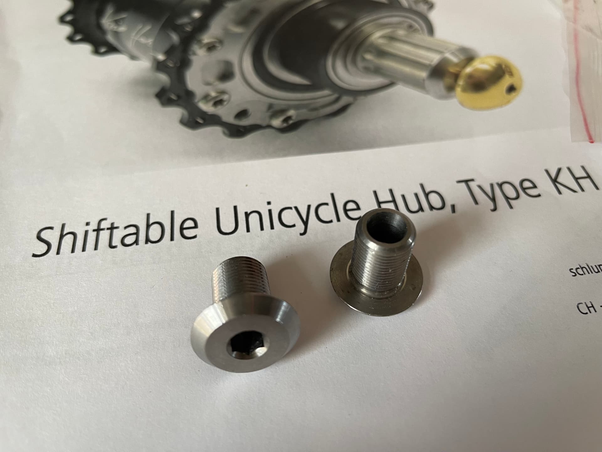

I have tried in vein to search older posts to find details for a Schlumpf hub’s axle bolt. I can see in 2016 they went to a M14 - but I’ve just ordered 2 x M10s from UDC UK as a back up for my soon to arrive M0274 hub.
However I can’t see any post or info if this is the correct bolt for that era hub.

Yes I remember reading them and notice it mentioned a move from M12 - M14 in 2016. Oddly been able to order M10 axle bolts for the Schlumpf. No idea what will turn up as they were listed as M14. Hoping not M14 as want some back ups for the 200 series.
Perhaps this is just a mislabelling and the M10 is in fact an M12.

https://www.unicycle.co.uk/schlumpf-axel-bolt-m10.html
Ordered two of these as backups for my 274 hub due to arrive tomorrow. Yep excited!
The listed speaks about the bolts being M14s. But the product code is M10.
I’m principally trying to work out if these are the correct version or backwards compatible with my series of hub.
If not, then I’ll be returning them - and currently they do to my eyes look like M14s but it just isn’t clear if the change in spec means for anyone with an older hub they have to source bolts with the spec before the change.

I ordered a bolt in UDC China, does not fit in my M800+ hub. Then I realized it’s a M12, which should be a leftover of them years ago. I’m going to return it but @mindbalance if you need one, I can send it to you (only one, and this is the last one in stock).
That’s very kind of you - and yes, I’ll never say no to rare spare parts for my older series hub.
I’ll DM you later today :folded_hands:
