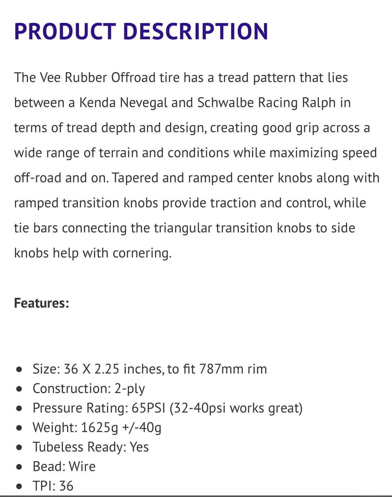

Holy crap that’s a lot heavier than the stated weight on every website I’ve checked for that tire which lists it at 1,410g
It’s from around 2017 I believe - so before the Vee logo and this was a slightly heavier tyre.
Interesting that the old listing details, thanks to the magic of Wayback Machine, says the tyre is tubeless ready. Odd.

The extra details I got from the seller were:
“Yes it is custom production before
official T-Monster.
The history is that the few enthusiasts
in US have decided to have perfect 36"
tire, take the pattern of the year (the
winner of MTB tires, I don’t know exact
year), diameter and other
measurements and asked every
producer around the globe. Only Wee
were willing to produce a small batch
(about 300 pcs). I was asked too and I
took 30 pcs from this production. The
next season Vee decided to launch T-
Monster. It exists thanks to a few US
unicyclist.…
I thought they use the same mold, it is
new information for me that weight is
different. Maybe it is the same mold but
less material..”

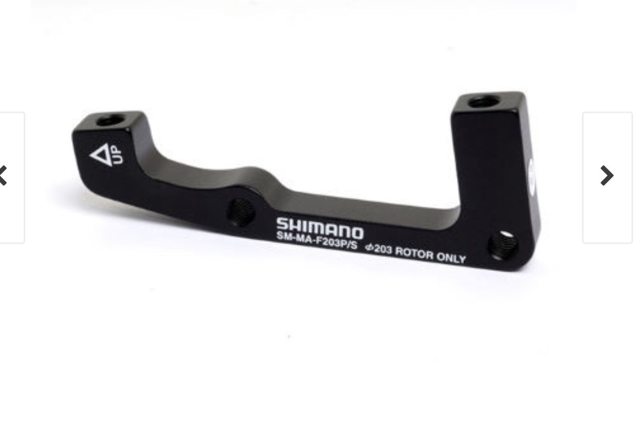

Caliper should fit - you just need the right IS adapter. I find these a pain to fathom but basically you want a Front IS to Post Mount adapter for 203.

Try searching for “Front Post Mount to IS 203” locally online or ask in a LBS.
It needs to be front and look something like this one:
I never enjoy finding the right one. It should be easy but at times it feels like you’re going to buy the wrong thing as there’s so many different types.

Some bike shops have boxes of the mount adaptors and will give it away for free. I went to Blackman bikes in Parramatta and the mechanic just let me have whatever I needed.
The current bracket holding the brake calliper to the KH36 frame might fit the oracle 36 frame? Actually Oracle 36” use 180 rotor and KH36 uses 203mm rotor, so will need another bracket.

and now I understand the adaptor brackets are easy to get and not expensive online locally or i might try Gockie’s advice and check out that bike store.

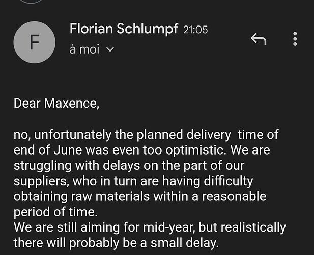

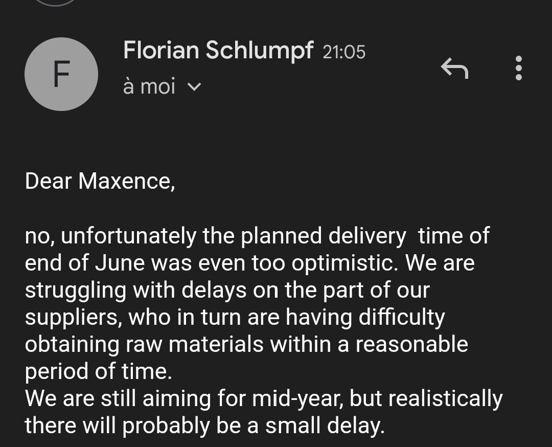

Some bad news from Florian: expect some delay for the next bunch of hubs.
I guessed as much.
When you say “next bunch of hubs” - you mean the first run of these 2022 hubs right?
Time to reschedule my wheel build slot. I may push it until August at this rate.
The term mid-year does confuse me a bit as that would sound like end of June - but that’s not happening. I read this more like an unknown length of delay - 1 or 2 or 3 months more so I’ll be happy if there’s some summer left to ride with the new hubs. Better to be pessimistic at this stage and have the shipment surprise you I feel.
At least it hasn’t been cancelled :crossed_fingers::gear:
