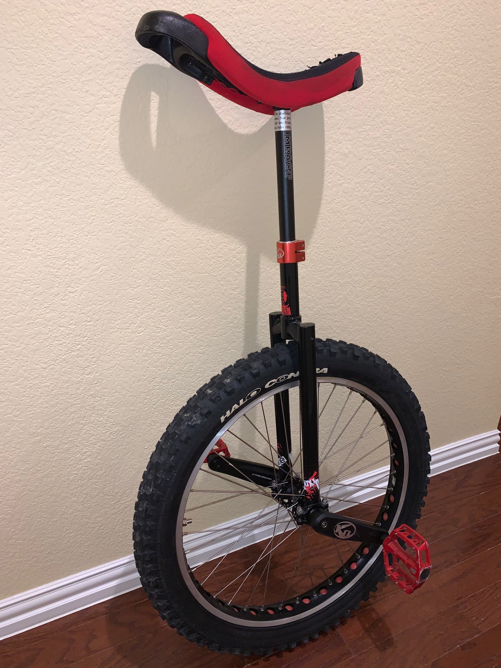

But I do have a unicycle that is like riding a tank. It seems like it can roll up and over anything, with the limiting factor being me. It is my Koxx 24” Track Monster with 165mm cranks.
I have never thought, “I wish I could coast on this unicycle.” But, I have thought that it would be great to have the torque of the 165mm cranks for ups and downs, and then be able to have more speed in the flat areas.
So, I have added a second option for myself, which may actually end up being the option at the top of my list. That is, build a second wheel for the Track Monster with a non-free-wheel Shlumpf hub. I’m not sure whether I would need a brake on this one or not. But, I’d rather have the brake and not need it, than wish for the brake and not have it.
Edit… Wait, just a second. This frame does not have the option for a brake, and I’m not sure if a UDC D’Brake adapter will work with this frame and/or the new Shlumpf hub. If not, that makes the decision process easier for this uni.
