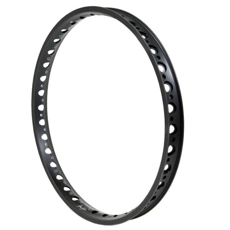

Do people know if the KH Freeride rim is designed for / intrinsically better for symmetrical builds.
Would this rim work well with the off set we have with the inboard disc of the schlumpf hub?
My head says the Dominator2 in the more clearly tough and used in dished wheels option - but I do tend to prefer the design of KH gear… just by a hair or so, but still tend to prefer. But I’d go Dominator2 if it is better with dished wheels for sure!
The generation rim in the picture is a fairly generic rim with some holes drilled out - really nothing special about it. It will work just fine in an asymmetric build, if you don’t plan to do big drops regularly I would not worry about it at all.
And even if, Mad4one has had similar rims (possibly even from the same extrusion) in use on asymmetric wheels for a long time and I have not heard of any trouble, just make sure the wheel is well built.
Thanks for this bit of advice. I see your point here, and yes paths would be the focus. So a narrower rim would make more sense especially if I want to run narrower tyres.
The 47mm wide KH rim with holes, i.e. the previous generation, was and still is a remarkable rim given the width and strength it provides at that weight.
The 46mm mad4one rim is similar, yet different. It’s a bit heavier and the holes are slightly smaller.
And the dominator is an even stronger rim, a very heavy DH rim.
There are different opinions on matching unicycling rim and tyre width. I comfortably ride tyres as narrow as 2.4inch on a rim such as the 47mm KH rim.

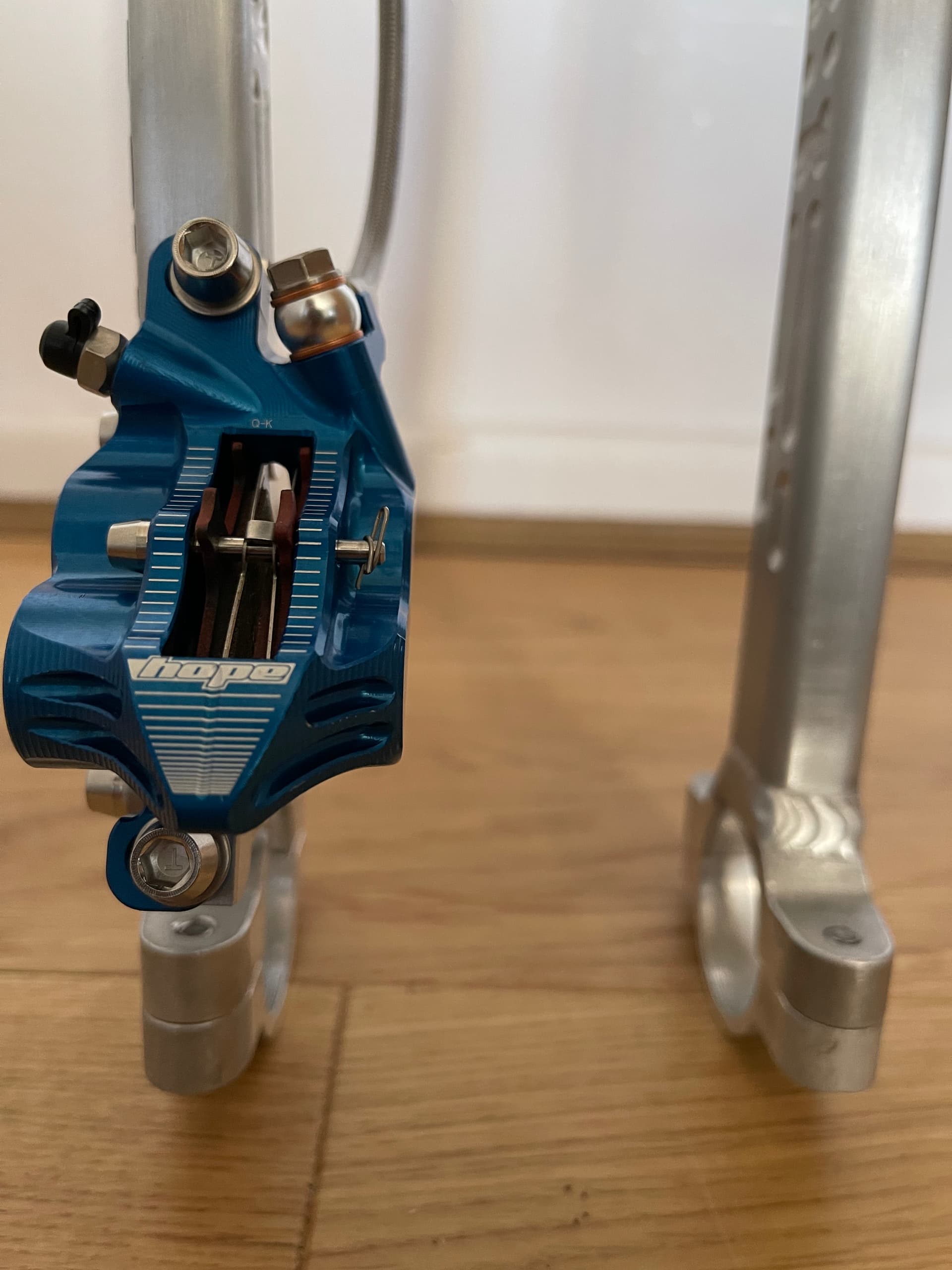

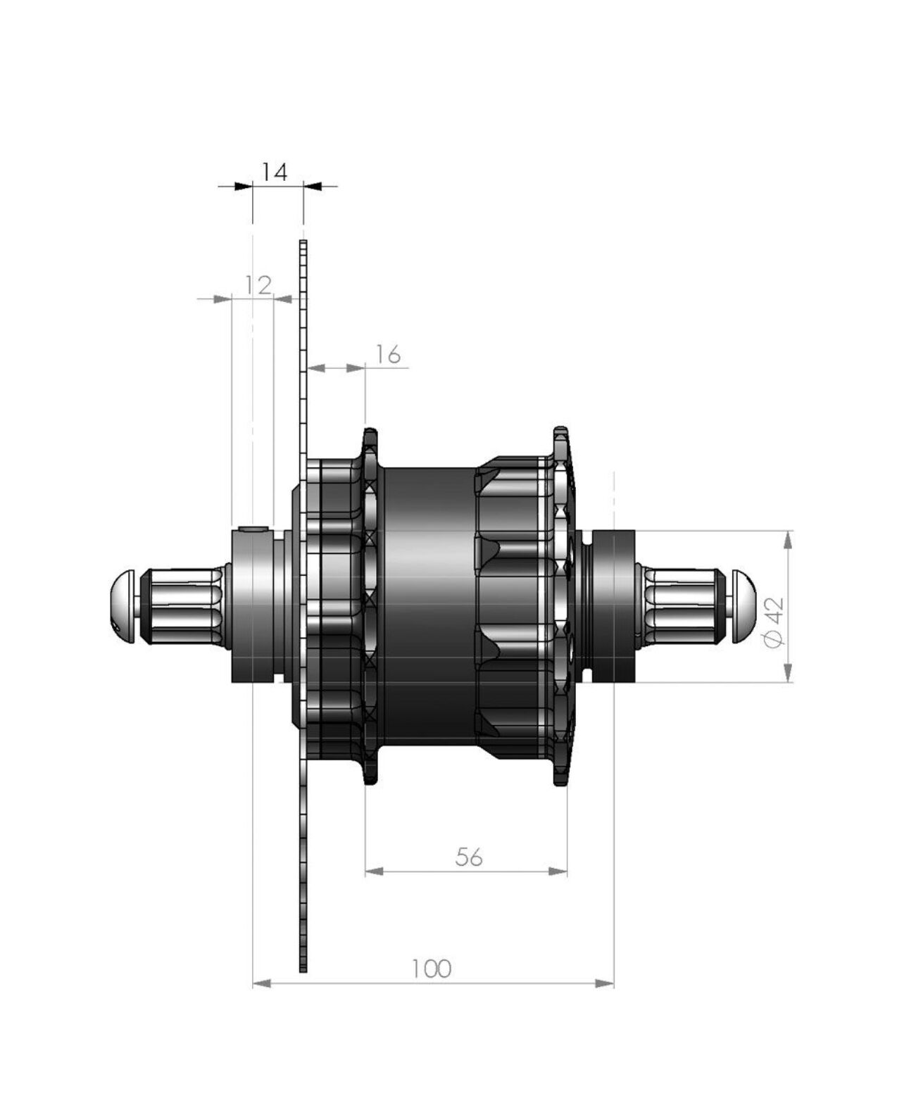

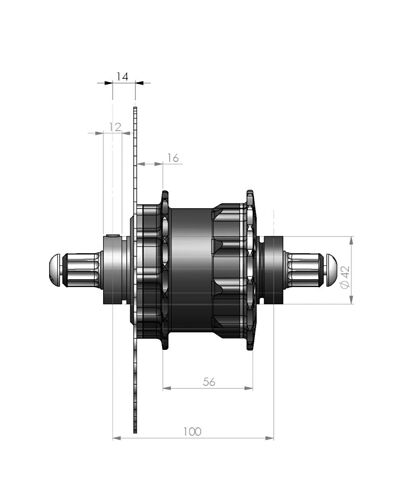

I’m likely to be over thinking this as I suspect the space for caliper and rotor is going to be pretty close but it has me slightly worrying as I can’t quick visualise the space when the disc side flange in build up.
The rotor slot does look to be in the right space as shown in the CAD drawing and by eyeball I can gage probably 16mm from that to where I picture the flange starting.

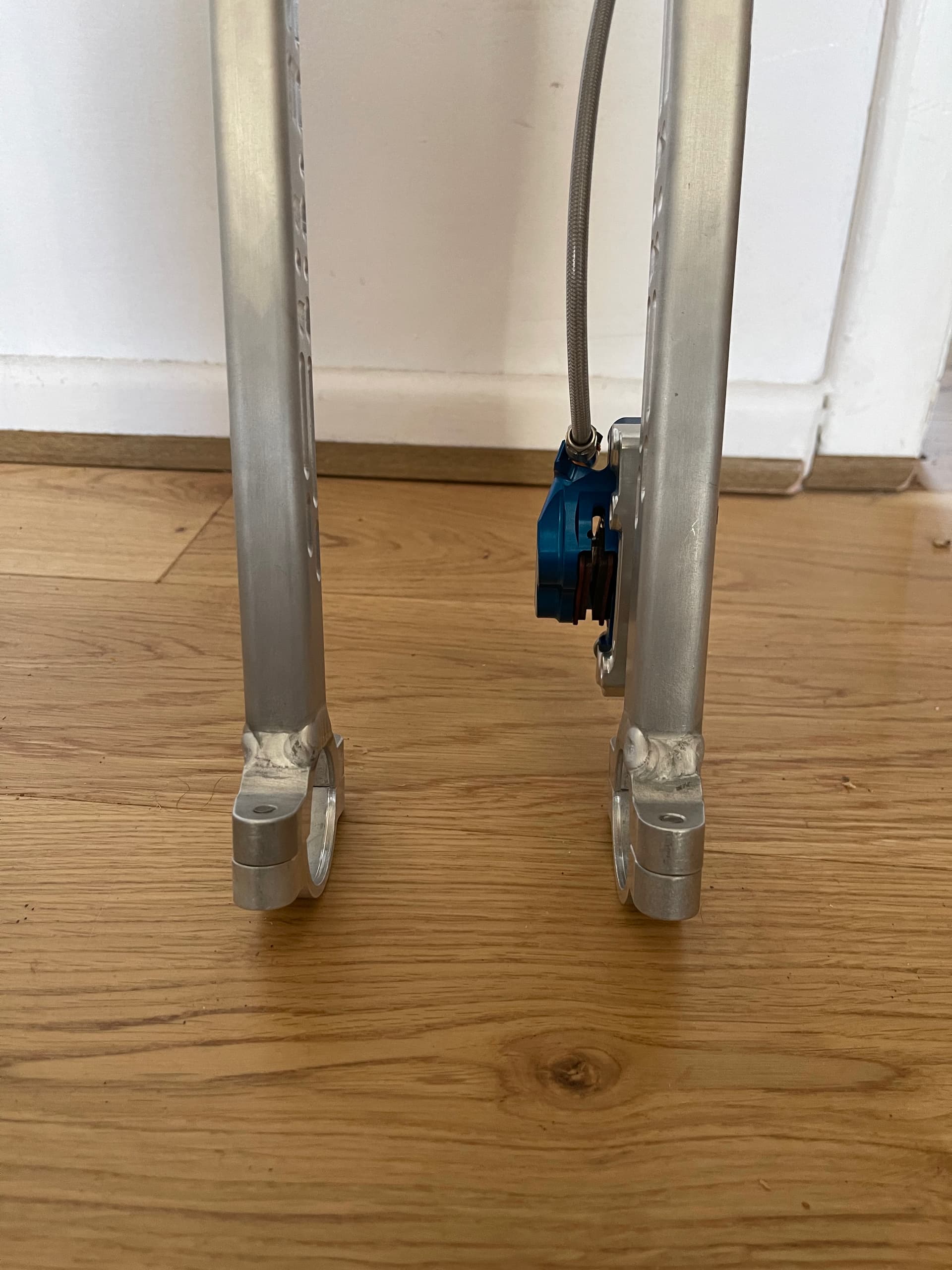

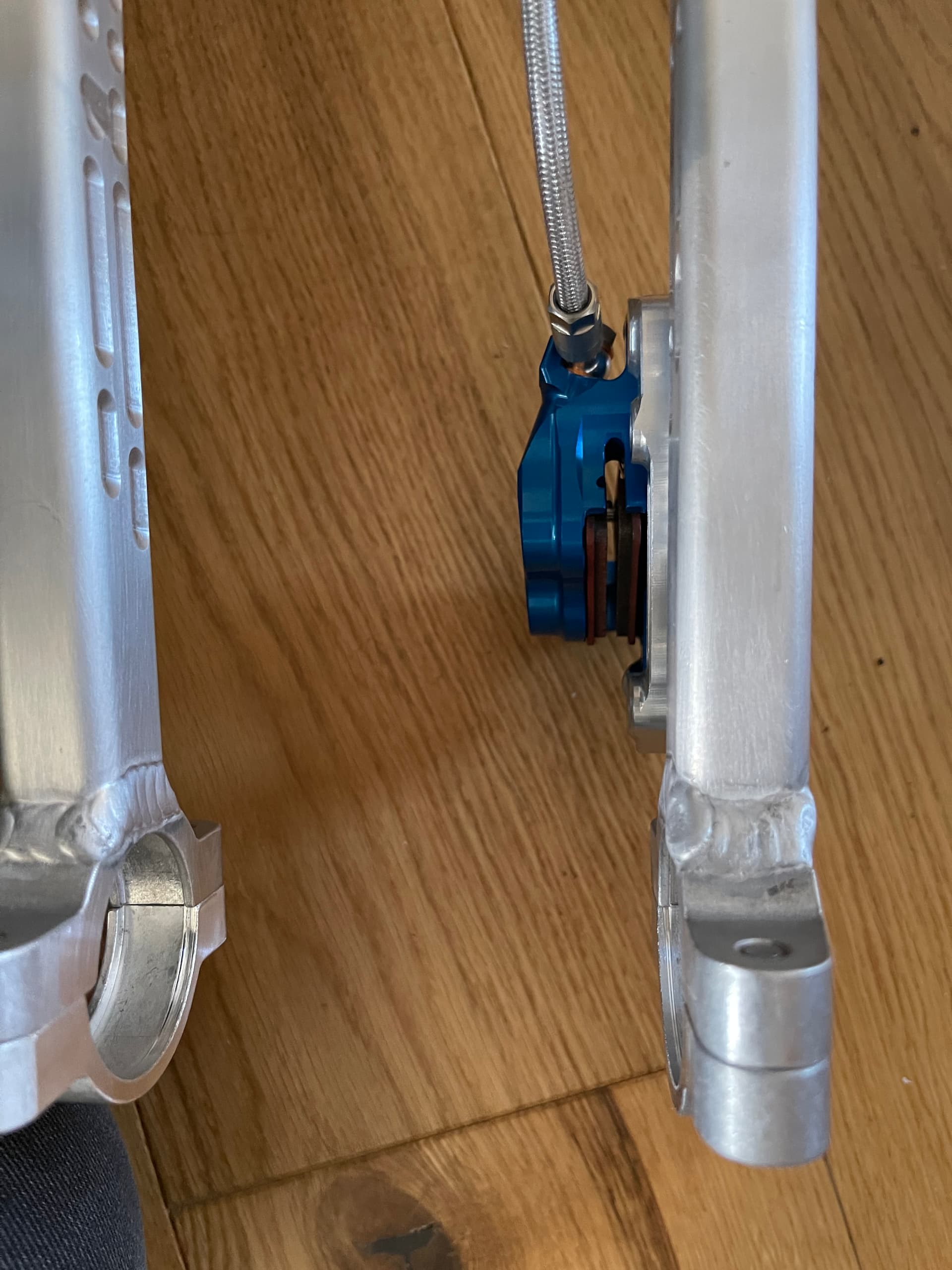

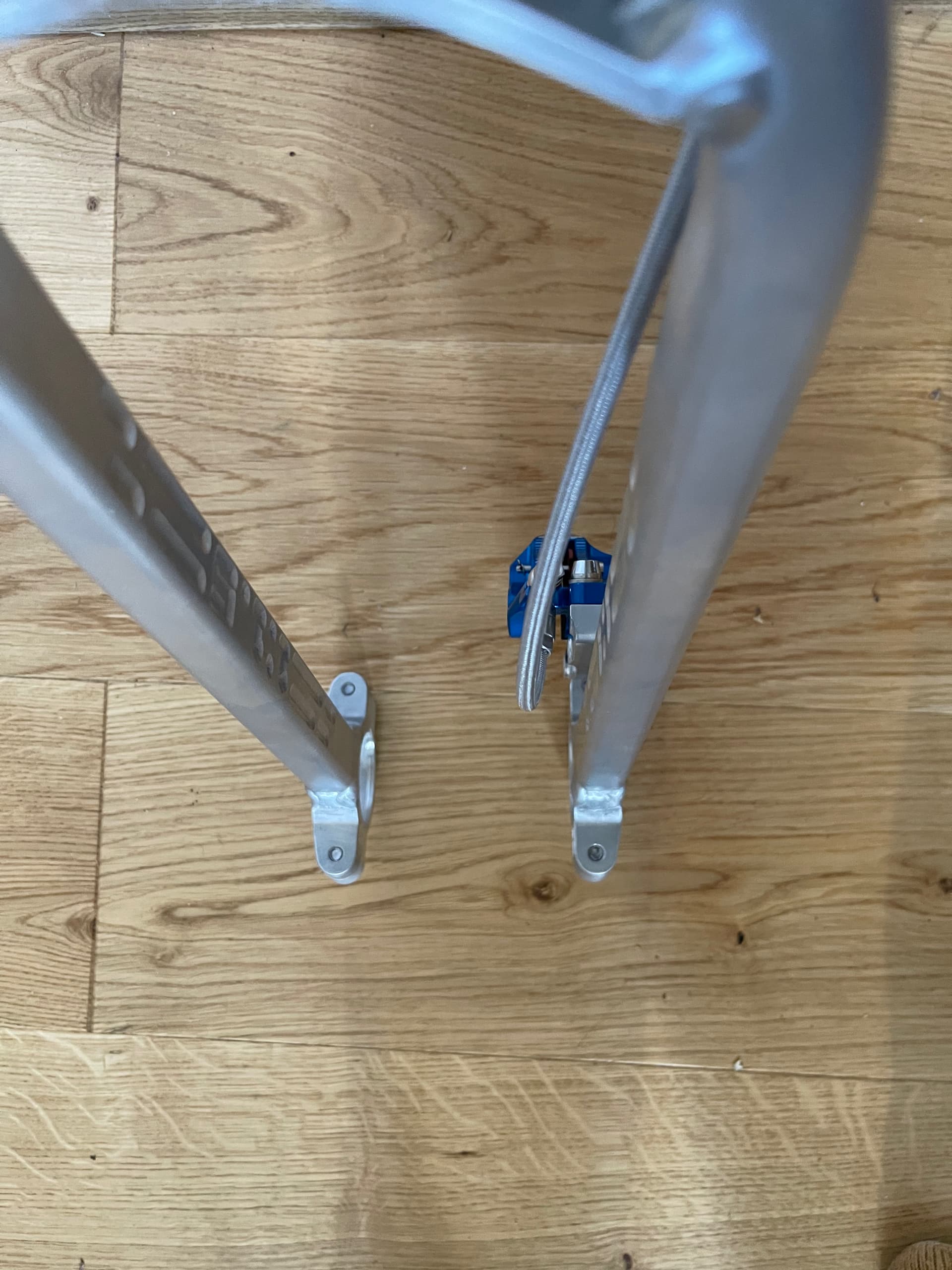

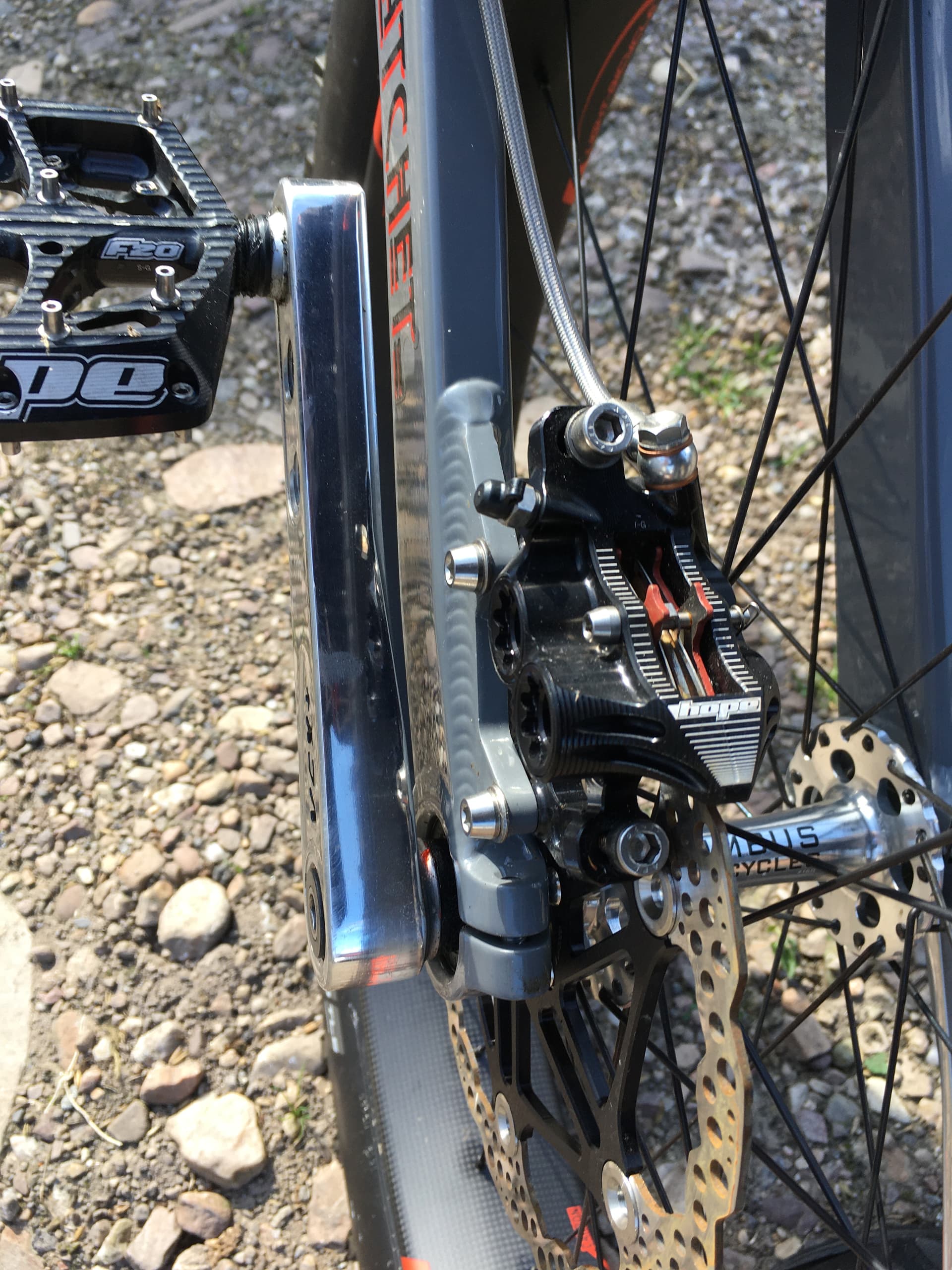

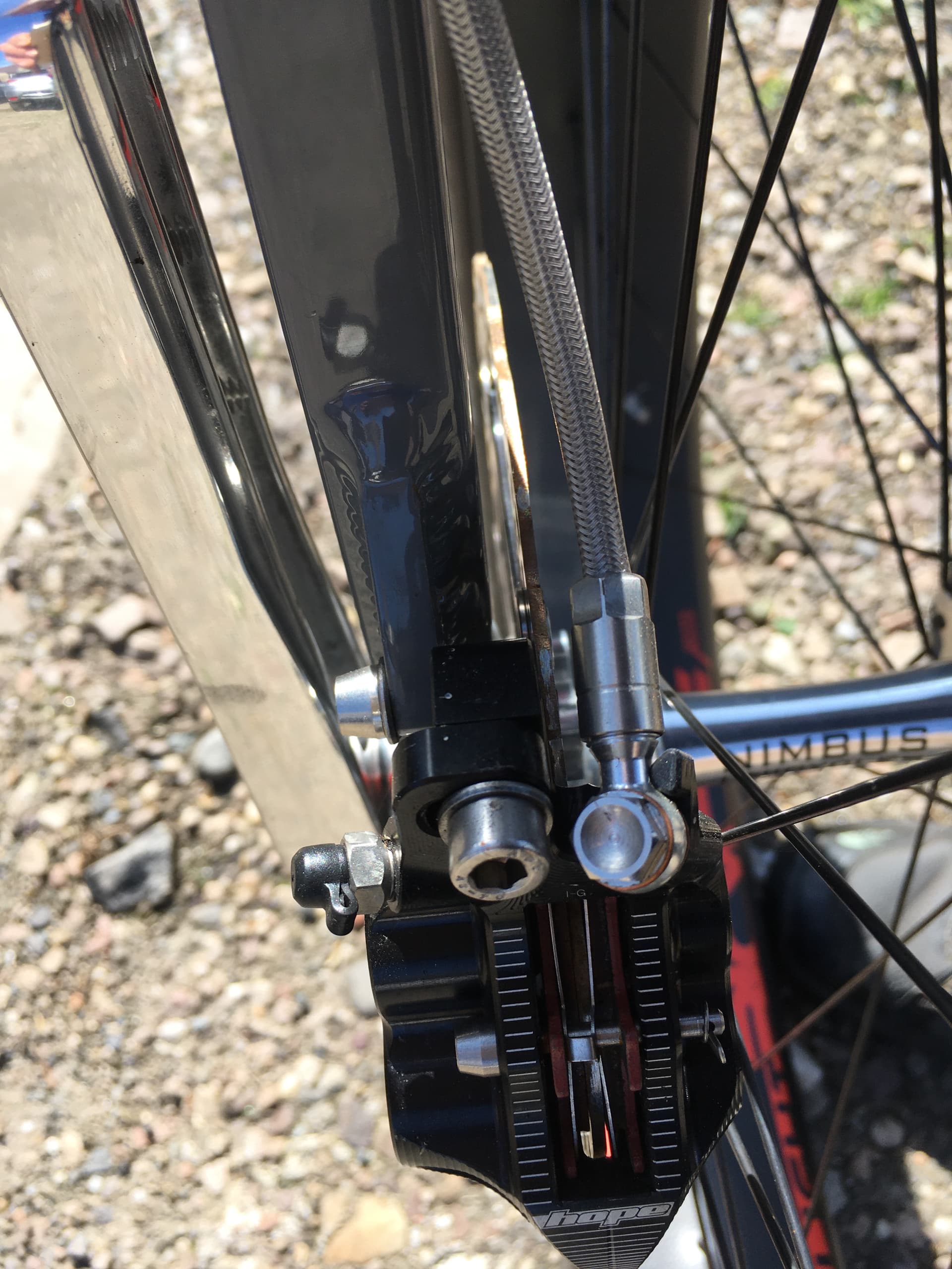

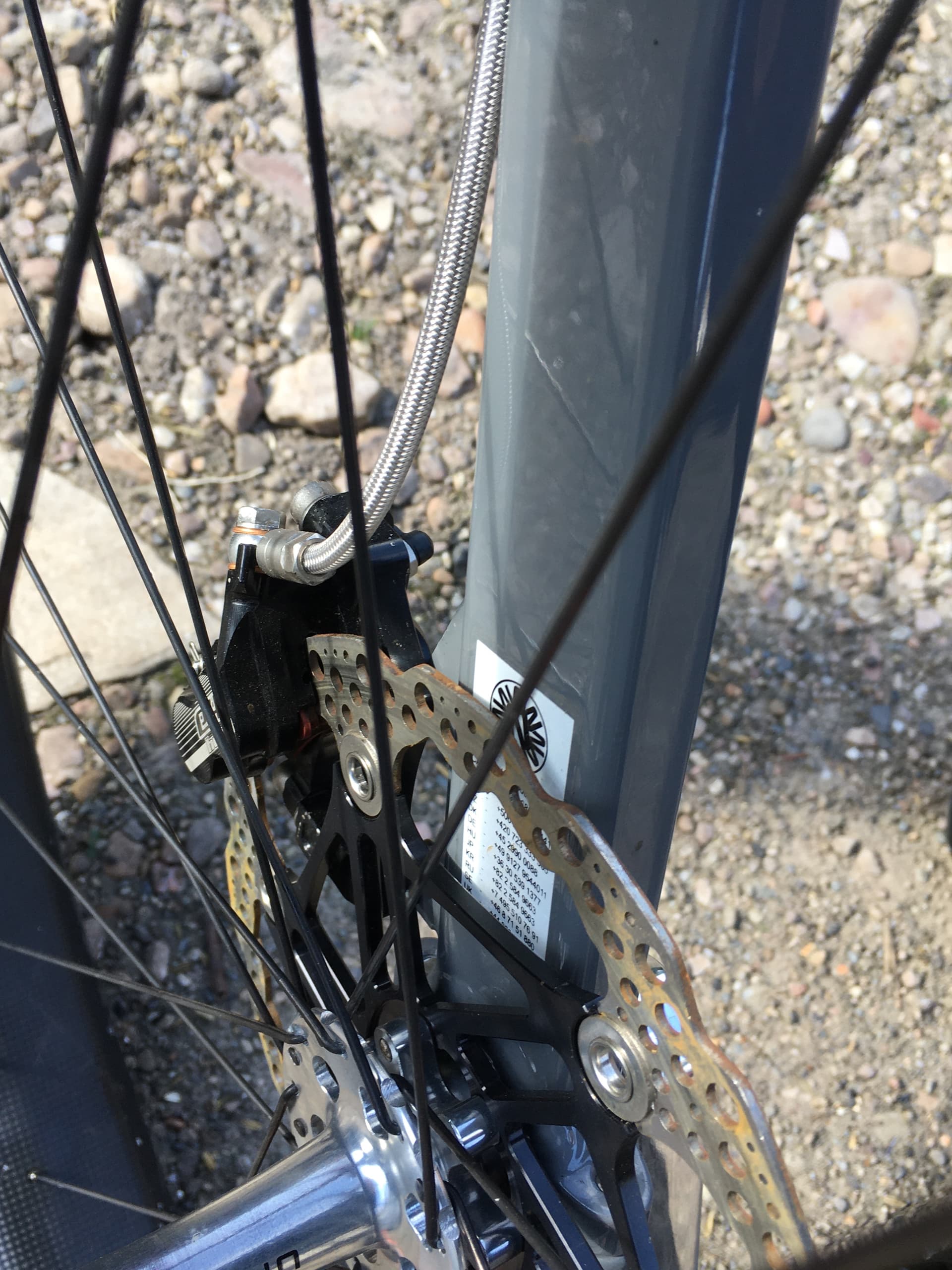

Is it normal for the caliper adapter to ever so slightly hang inside of the frame leg?
I guess the issue is that once built the spokes will be at an angle the gives more clearance - but I wanted to check in case buying these discounted E4s was a tad hasty of me.
I’m sure it will be fine if you have the correct mounting bracket for the rotor you’ve chosen, there is nothing peculiar about the mounting of the E4 brake as far as I am aware.
I’ll take a photo of the E4 I have on my Hatchet later so you can see what that looks like on that – granted that is with a 125mm Nimbus hub and a 200mm floating rotor, but that shouldn’t be of any consequence.
Here you go – as you can hopefully see there isn’t a whole lot of clearance, but that’s the way it is supposed to be
The rotor position on the Schlumpf relative to the bearing should be the same as it is on this hub, so the fact that it is a different width hub should make no difference, it is the tab position relative to the bearing housing that is important, and that should be standard too.
