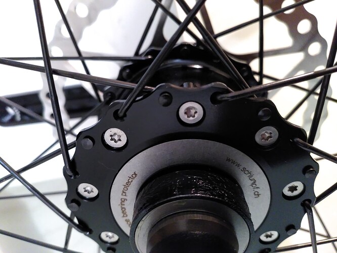

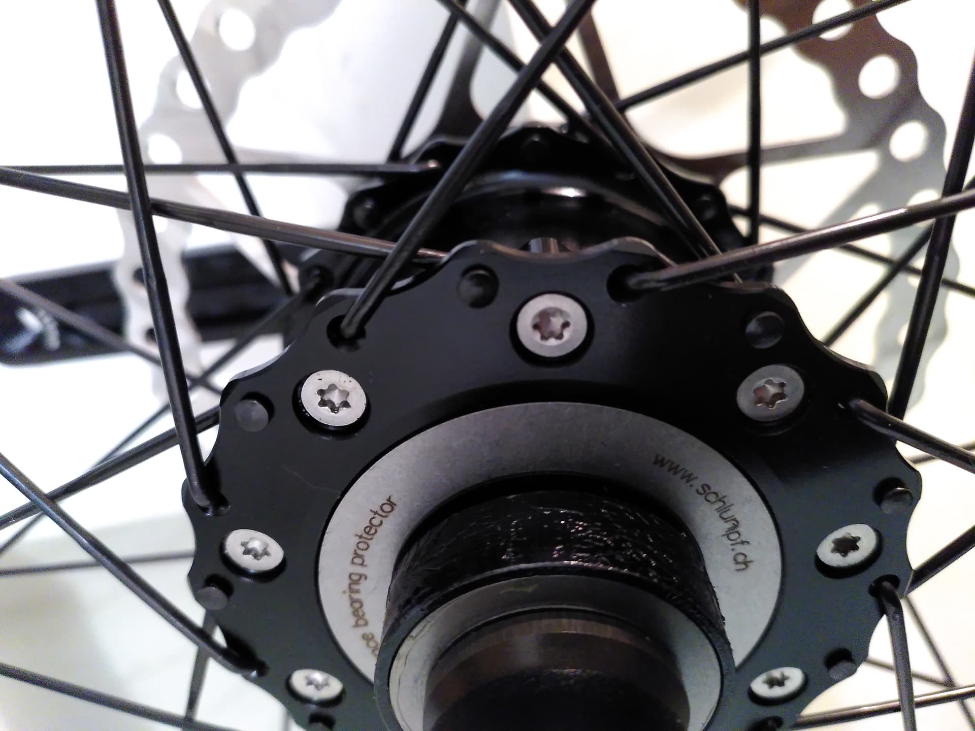

Ok, here are some more pictures. I think the spokes they used are a bit thicker at the bottom (I had the wheel built, didn’t do it myself).
That’s annoying because I already had to return the wheel once because they mounted the spoke head the wrong way round even though I pointed them to the part in the manual where it says how to do it…
Thanks, sounds like I have to get washers…
That might help… as I do personally this it is best with washers in NDS.
But I’d be curious to know if @Joris had this kind of issue and come to think of it it seems like their build is closer to your set up.
(Hope you won’t mind me tagging you into this Joris!)
Really hope we can figure this out and get you up and running @r4nd1nt :crossed_fingers::gear:
Except for the wider rim that’s very close to my setup, yes.
Thanks for digging up all those helpful posts and people. :smiley:
No, I didn’t have this problem myself. I used the 2mm spokes from einradladen.com (which I believe are the same spokes as from unicycle.co.uk), without any washers. The clearance I have at the non-disc side between the spokes and frame is somewhere in the 0.5-1mm range.
