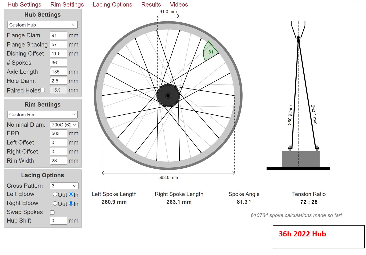

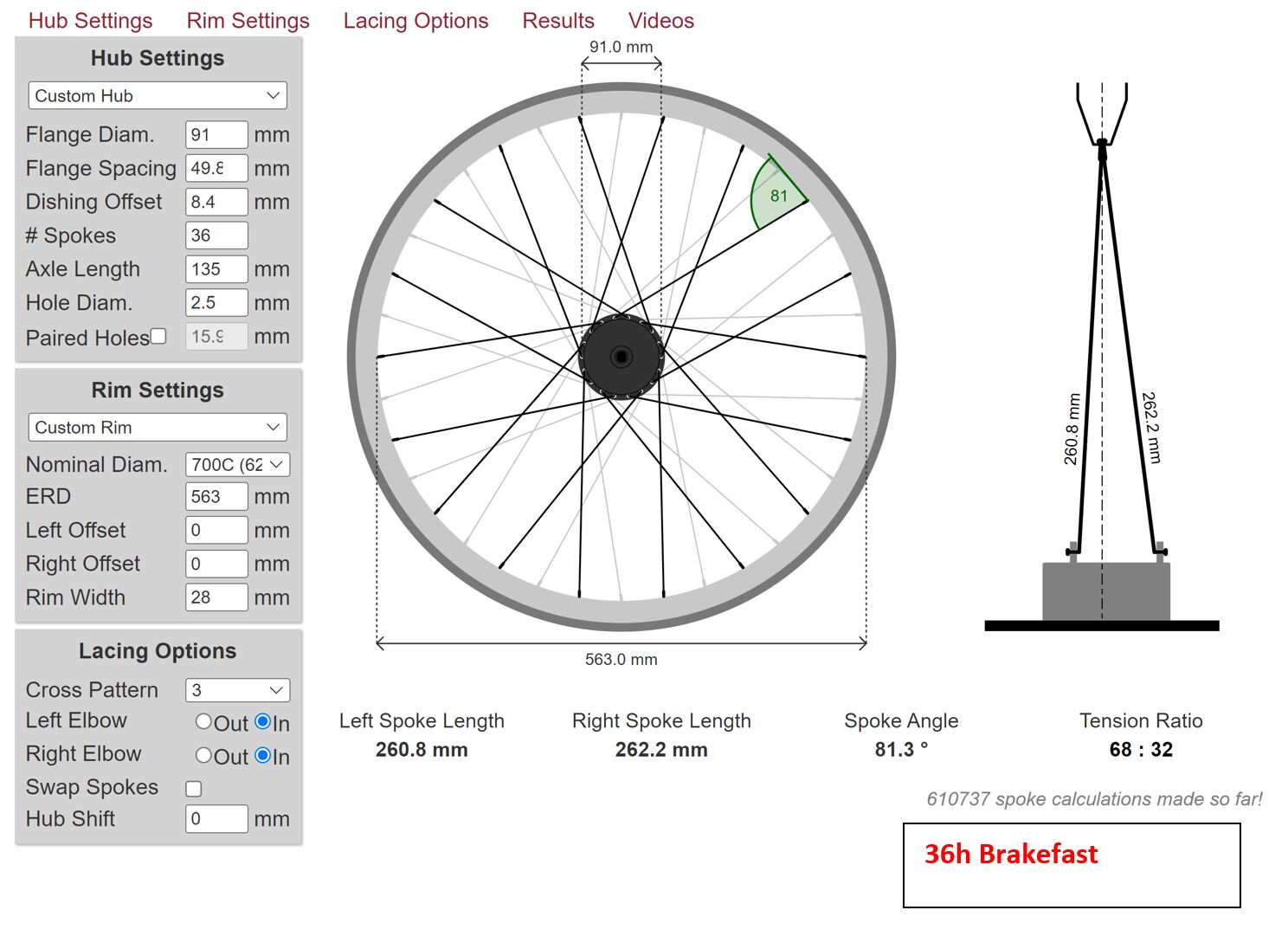

My calculations showed this hub is more asymmetric compared to Brakefast.
Brakefast:___________________________68:32 = 100kgf:47kgf
2022 Hub:___________________________72:28 = 100kgf:39kgf
2022 Hub+29er rim with 2mm offset: 68:32 = 100kgf:47kgf
Are people planning on using symmetric rims? Is the large spoke tension ratio a concern?
Building the 2022 hubs with symmetrical rims to a higher tension of say, 120kgf:47kg, seems alright as far as tension goes. I’m not sure if any of the newer hubs had flange spoke hole failures though?
