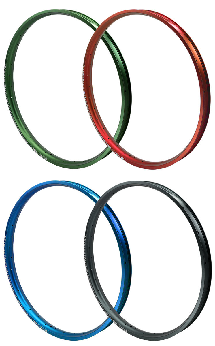

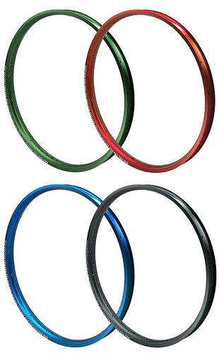

So far I’m considering these options, in ascending order of width.
I think 42mm is about as narrow as I want to go, and 55mm is going to start to limit tyre options. So those are my lower and upper bounds for now.

The KH Freeride is about i50 and definitely on the light side for that width (680g) - an awesome rim which shall provide you with the maximum of axial/sideways stability.
With the WTB KOM Light i45 you can trade off 5mm in width against 50g in weight. That’s fair. Nice rim, looks like a top candidate.
You can also consider the KOM Light i40 on the rather narrow side. But if you like rather low tyre pressures or you corner hard and drop deep, scrap that.

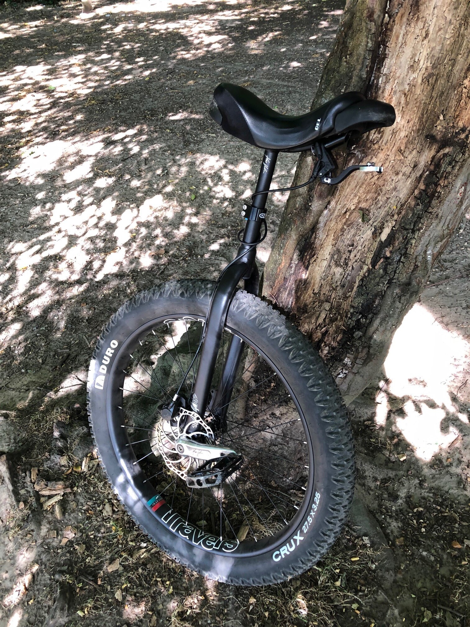

So far I have no complaints on the #RGB from QX:
I’m waiting for the Dura Crux to come in and I’m sure that’ll mount properly as well (Currently running a 3.0 tire)
Also looks decent. I would probably take that one over the Mad4One as it’s the same width but a bit lighter.
