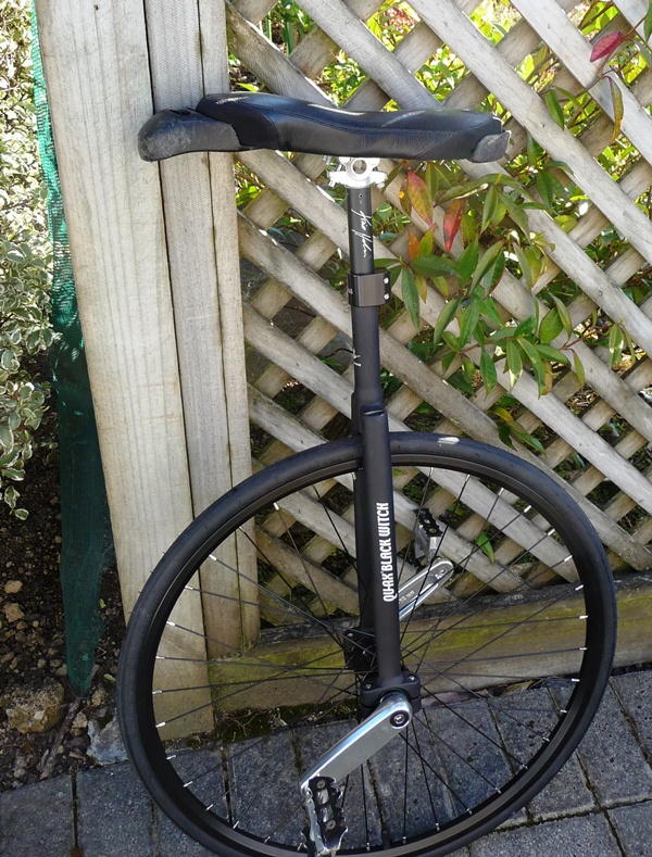

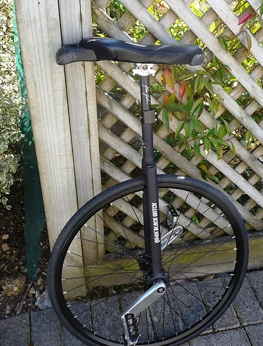

Long-term forum-ites may remember back in the day when I used to write up many of my rides on my varied fleet of unicycles.
One such uni was the Bacon Slicer, so called because it has a custom made wheel with a deep rim and a very narrow tyre. Mainly I rode it on a 700c x 23 mm tyre pumped to about 120 psi, but for a while I even took it down to a 20 mm section tyre.
The result was a very lightweight wheel with virtually no “squidge” in the tyre and very little momentum. If a 29 is a broadsword that hacks its way down the trail, the Bacon Slicer was a rapier, fencing the trail, seeking the neatest route between obstacles.
Since I moved out to Lincolnshire, most of my riding has been either on the 36 or the 29. However, recently I had a yen to get the Bacon Slicer out again.
Experience on the local rutted bridle paths had shown that the 23mm tyre was just unpleasant to ride for any distance, and was very vulnerable to punctures.
I therefore invested in a 700c x 35 mm Schwalbe Marathon tyre. It has more puncture resistance, a bit more grip, and as it is a tiny bit fatter I can run it at medium pressure - around 60 psi.
This gives me a uni that is lighter and more demanding to ride than the 29, but less of a handful than the original Bacon Slicer with its skinny road tyre.
Yesterday was the first day out on it and I enjoyed it so much that I went for two separate cross country rides!
I am no longer a committed short-crank rider. The original Bacon Slicer had at various times cranks from 89 mm to 125mm and was mainly ridden on 114s. For now, I’ve put some very light 125s on it and I found myself able to ride a lot of stuff that would be challenging on the heavier 29.
On routes where I would normally be confident to manage either a clean run (no UPDs) or at worst the occasional “step off”, I had two or three spectacular running dismounts, and two where I had to roll to dissipate my momentum. This is more like unicycling as it used to be.:slight_smile:

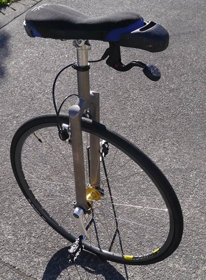

I got mine at a shade over 3kg…it could be much lighter but I like having broader tyres and pedals for performance over weight.
Have you tried using a 700x28c? Its almost as light as a 700x23c without feeling like you’re riding a touring tyre, but with a bit extra rubber to compensate having only one wheel. With short cranks, its also as fast as a 36". I hardly ever ride my 36"anymore…the 700c doesn’t tire you out because it’s so light it glides. Much more fun.
This is more or less my setup (without brakes, broader pedals and shorter cranks). I’m waiting for Triton to make me a narrower frame:

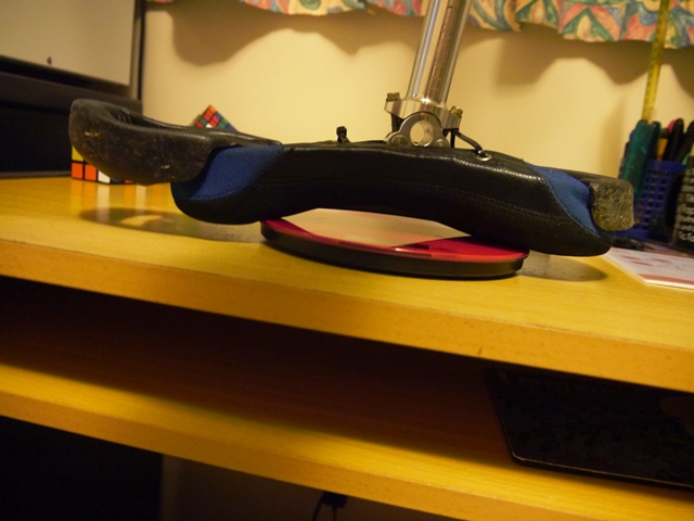

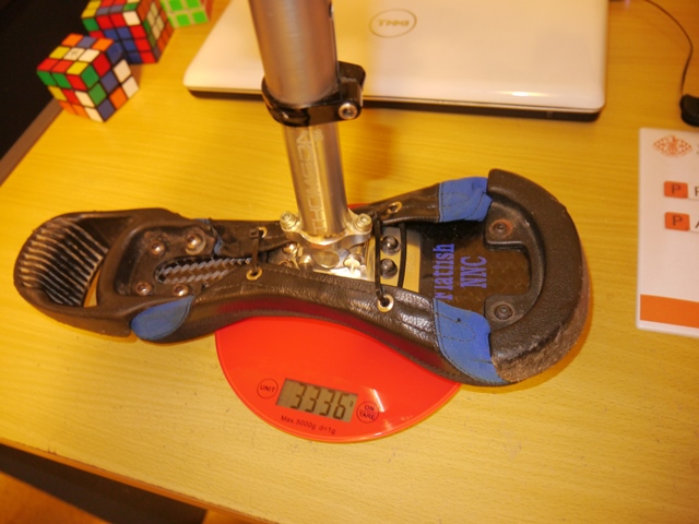

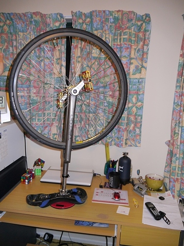

“much lighter”? That’s already close to just a scant 7 pounds! I can’t fathom how a 29" uni - with the lightest frame, saddle, seatpost and clamp, hub, spokes, rim, tire, etc., can weigh so little. Amazing! My 24" with alum frame, cf saddle, titanium hub and super light single skin, skinny rim, ultra light pedals and super light tire still weighed in at 8lbs, and I thought that was light!
Okay, maybe a little bit more than 3kg. My current 700c set-up is 3.336kg, but I want to make a lighter, narrower frame…just waiting for Triton to get some equipment to bend their Ti tubes I think.
I have lighter pedals, tyre and tube, but the unicycle needed to perform as well. The nice thing about this setup is that it rides like a regular uni- with the smaller pedals my feet never felt secure. With these other bits the unicycle weights almost exactly 3kg, and with a lighter frame it would come in well under 3kg.
If unicycles used bicycle technology, it should be closer to 2kg.
The frame could lighter if designed specifically for road use (eg a carbon road fork should be under 500g), and carbon cranks and carbon seatpost…could easily drop a kg.
The NNC saddle is quite light, but was built stiff in order to take a handlebar. If you don’t ride one, then there is no need for this amount of stiffness. The Mavic Open Pros are excellent, but it’s still a 36 Hole rim. Road bikes run on 2/3 that number of spokes.
Plenty of ways to get the weight down.
