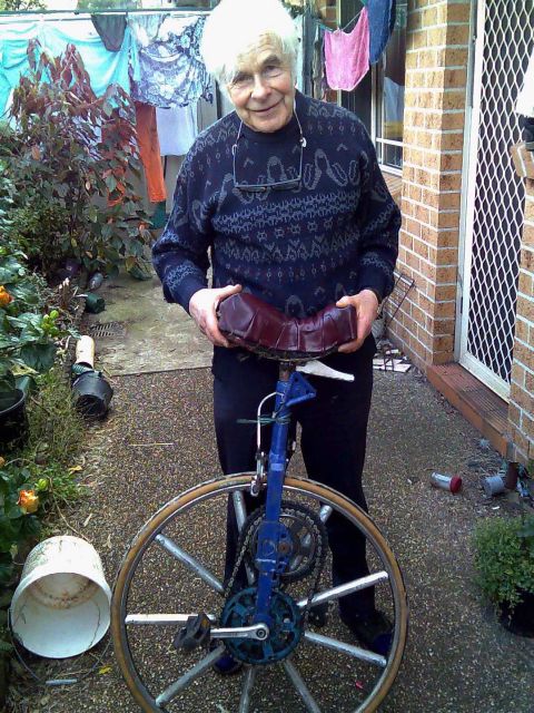

By the way, past inventors have utilized a jackshaft approach, such as Keith Macay of the UK. I merely refined the design.

For the record, I think he is from Australia, and his last name is spelled McKay.
