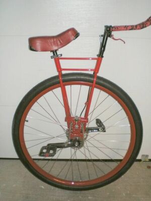

Great solution: pedestrian technology, applied cleverly. Tell me, will you post detailed drawings? Also, I’d like to see step photos of the wheel being freed from the bearings and chain drive. As pictured, how much does it weigh?
Now go chase down some impala- there really should be a spear-rack.
Total weight with disc brake setup is 19.8lbs (9.0kg). Cranks are FSA carbon pro. Saddle is custom Wallis Design.
Sorry but I build by sight only, and have no plans to disassemble it anytime soon for pics or drawings. However, here’s a repeat post of the business end:

Are the disc brake and sprocket at hub cold connected? It almost looks like screw heads or rivets protruding from the break side. Is the hub stock, or modified stock- or custom built? Are the multiple holes in the gear cage to accommodate different sized gears, or for tensioning? Your tolerances are sooooo tight. Beautiful, beautiful work- like a giant clock.

Would it be possible to make it be able to disengage the jackshaft drivetrain and re-engage a 1-1 lock-in to make the cranks lock directly to the hub, to enable shifting between 1:1 and whatever gear ratio is selected? Seeing how the Schlumpf hub shifts its drive plate thing back and forth between the planet carrier and the hub housing, I don’t see why it wouldn’t be possible with this design, either, but I could be missing something important. To make this shiftable back to 1:1 would be absolutely epic.

And I love the brilliant simplicity of the jack shaft design.
it would be a little complicated, but i’ve just imagined a reasonable design engage-able and disengage-able with simple allen screws, so no shift-on-the-fly, but still reasonable.
