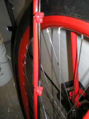

The Menace has gotten even redder lately with a red painted rim, and new brake cable guides in the form of red skulls (made by Dirty Dog products):

Love the red skulls.
