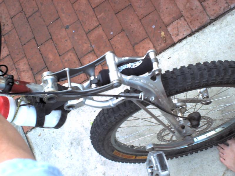

Bravo, An extremely inovative frame and drive system, Our community needs more people to design and build what we want and need. I agree with a disc brake, and the coda has the same properties you desired. I like your work!
Barefoot?
Barefoot?
Barefoot??
Not My Foot., Oh , crap , busted and on profile picture too, Darn!#*$%
