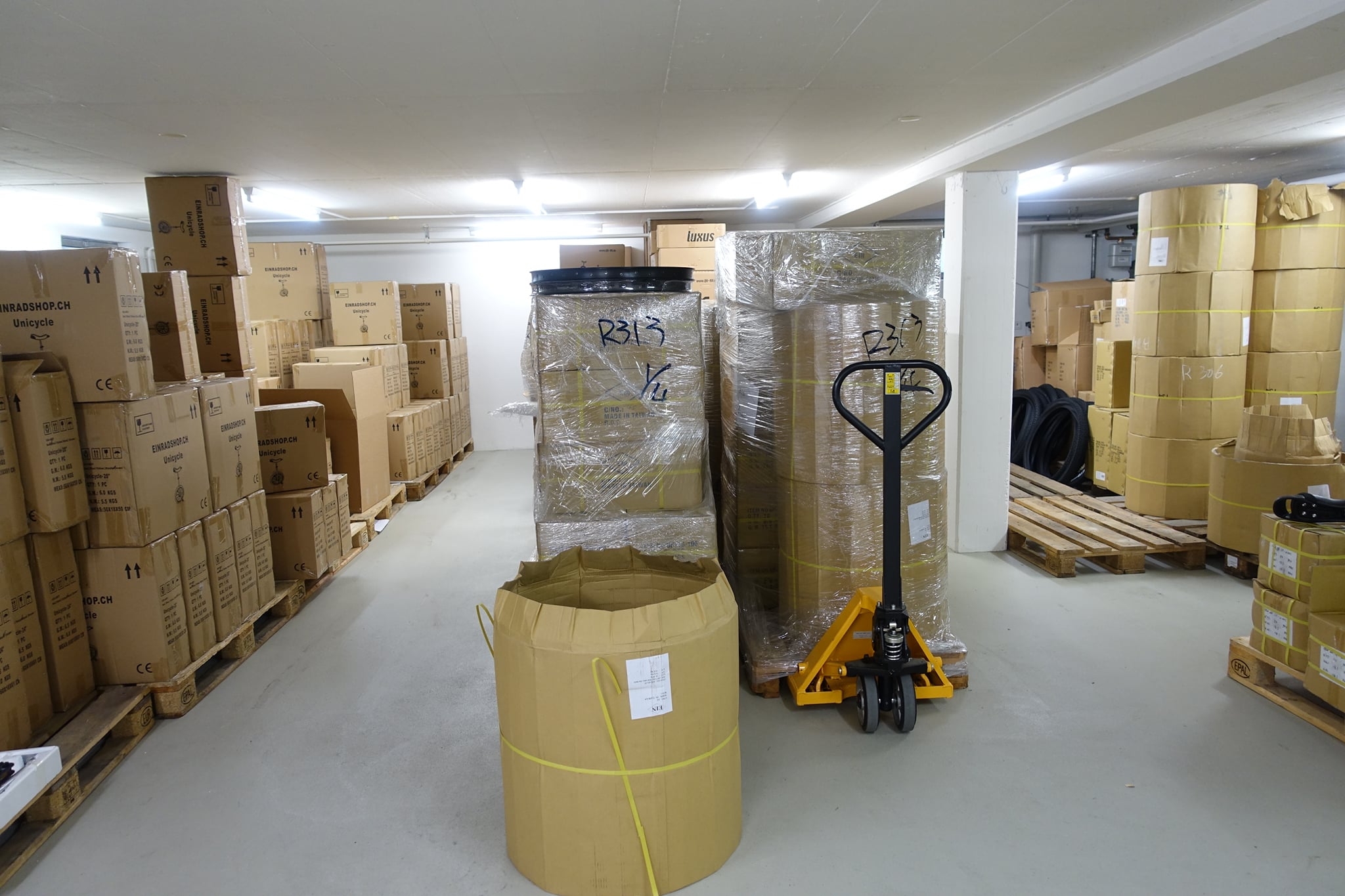

I have to say that is the cleanest warehouse I have ever seen in my life. Did you tidy up for that photo? It looks amazing!
the look of the room is constantly changing. Meanwhile there are still racks in there and stacks of tires. Things don’t look so neat in my 3 adjoining rooms :slight_smile:
