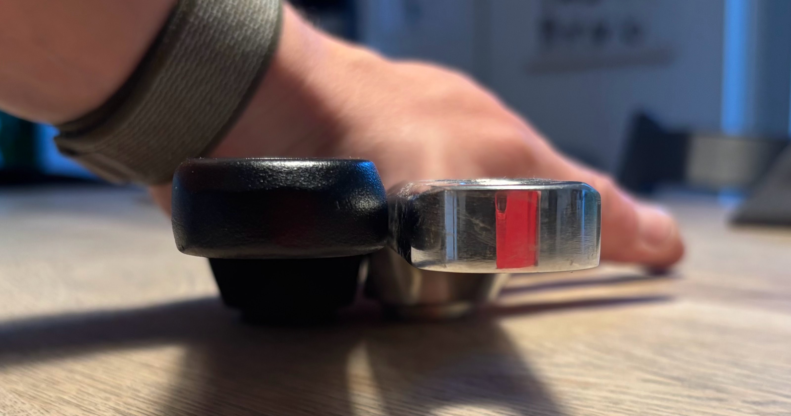

Prowheel crank 127mm ISIS "MaxQ" first look
Due to this post by @pierrox I got curious and ordered a pair of Prowheel 127mm cranks.
It seems Amazon have 127mm/140mm/152mm cranks available both in the EU and the US.

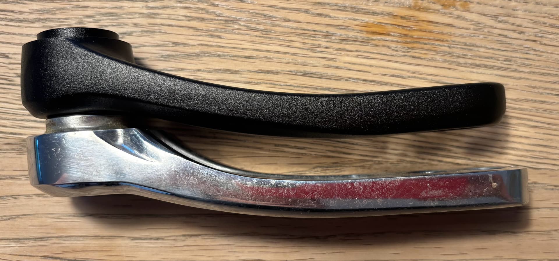

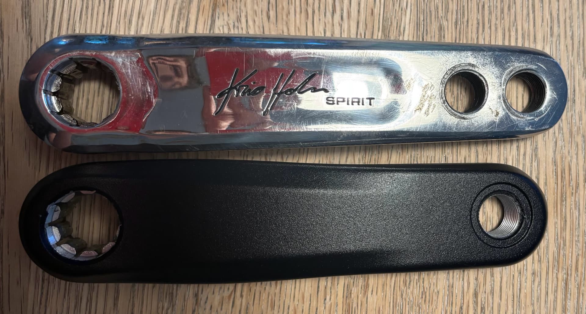

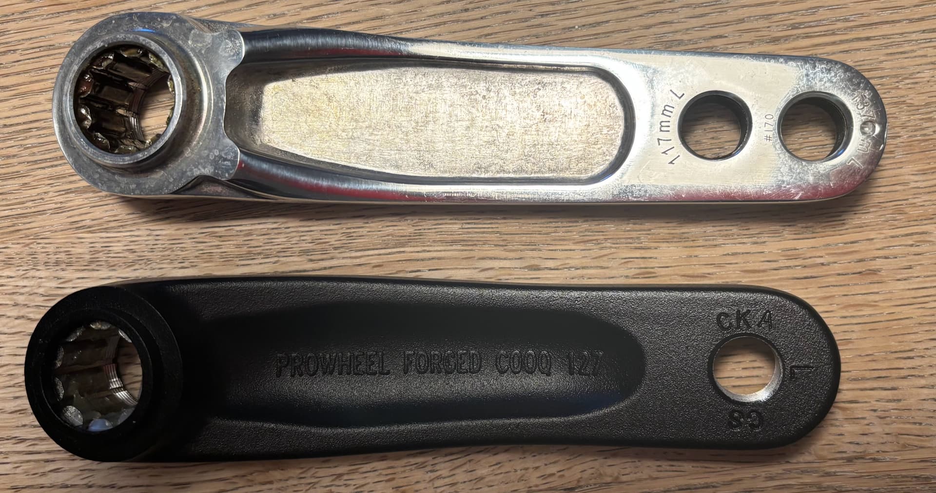

Here is a quick photo comparison with some KH Spirit 117/137mm cranks.
As far as I can measure each crank have ~3mm more q-factor than KH Spirits. So using these cranks will put your feet ~6mm further away from each other. So I think we should refer to them as as the “MaxQ” cranks from now on :slight_smile:

would you say that MaxQ is better or worse for muni? By having it wider you create more of a platform and balancing should be easier, but possibly for maneuverability narrower would be better. As I tend to ride with 150mm cranks, I possibly should look into a 150mm Q-factor as well. A bit like that other pic I showed with the tractor wheel :smiley:

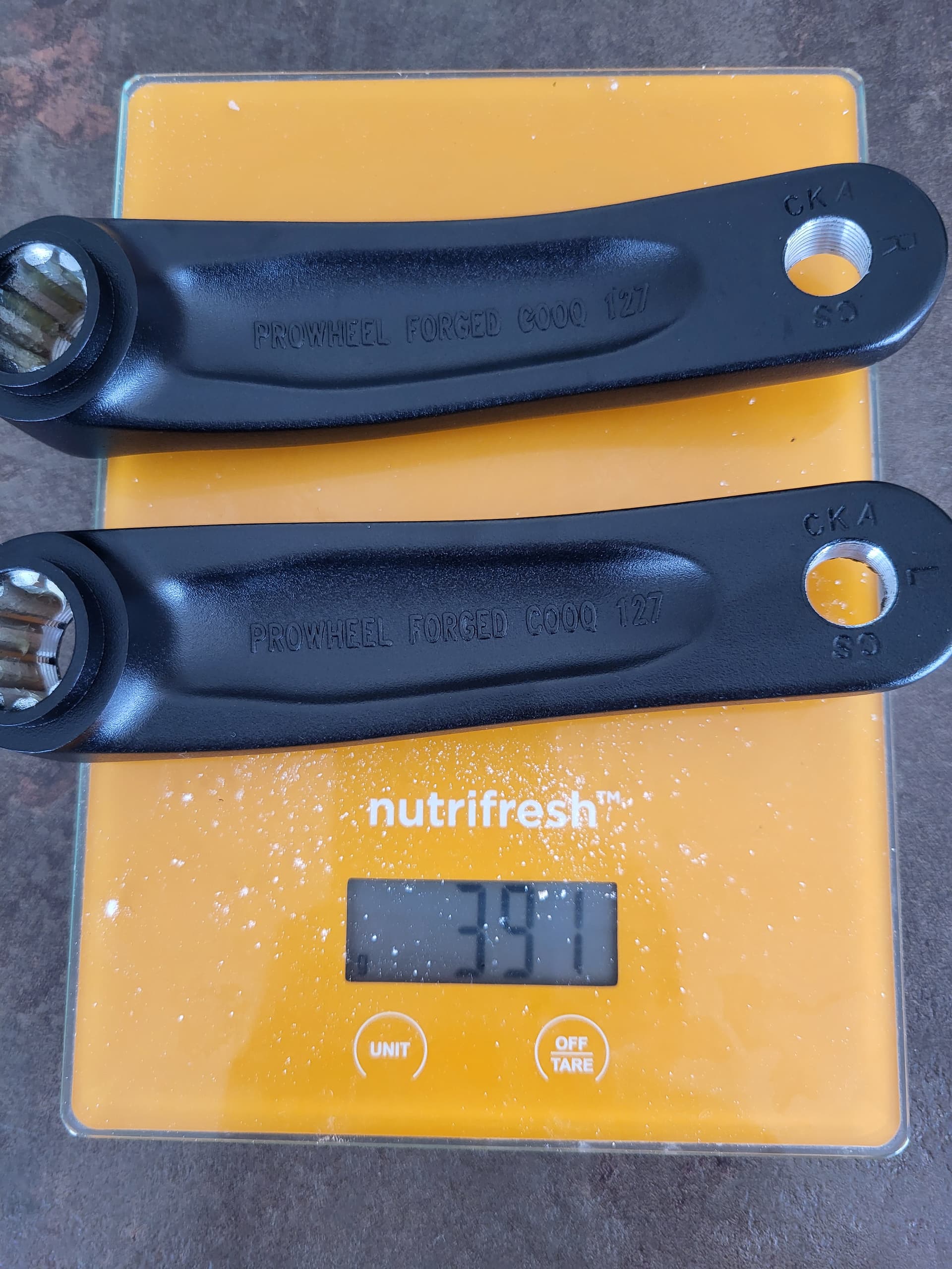

Last tech spec (for 127mm pair): 391g
They are beefier than the butter Qu-ax ones and definitely heavier.
