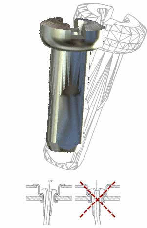

Anybody have any strong feelings with brass vs. aluminum nipples? I’m thinking about these:
Edit: the more I think about this, the more I think the weight savings is mostly in losing the tube and material for the rim. The rest is probably insignificant in comparison. Almost gotta have a steel hub, too. I should probably get brass here.
In all my builds (bike wheels) I’ve used brass. To me the aluminum ones I see on old wheels always look corroded and seized up on the spokes, then they get rounded so you can’t use a spoke wrench on them anymore. That doesn’t seem to happen with brass nipples.
I think you are right about weight… Probably won’t make much difference.
Thanks much for confirming!

About the spoke nipples. As others pointed out alu nipples are likely not worth the weight savings but if you want something a bit more colorful then that is the way to go.
Makes complete sense. Thanks so much for the quick response. I’ll be taking your advice.
And I’m going with brass nipples. Thanks so much!

With respect to aluminium vs brass nipples – as has been said, if you want some nice colours go with aluminium. Looking down at the coloured nipples looks pretty cool when the wheel is rotating :grinning:
With reference to rounding off aluminium nipples with a spoke key, go with the double-square nipples I mentioned above; during the build you can do all the work with from the inside and don’t need to put a spoke key anywhere near the head of the nipple on the outside. It can be convenient during the final truing but most of the work is done inside the rim. Note that you’ll need the Sapim tool for these nipples. Also get a decent 4-sided spoke key for use on the outside – I have a DT-Swiss Pro-Line one, it is the kind of tool you actually want to use, it is expensive, but in general you get what you pay for.
If you are going to be riding this in the winter and there is salt on any of the roads, go with brass just to be sure the nipples don’t fester away. However, you probably won’t want to take you shiny new wheel and Mad4One frame out when it can get all corroded…
[Edit: As a quick note – with the double-square nipples, you need to account for these in the spoke length calculation – I can’t remember the details just now unfortunately.]
