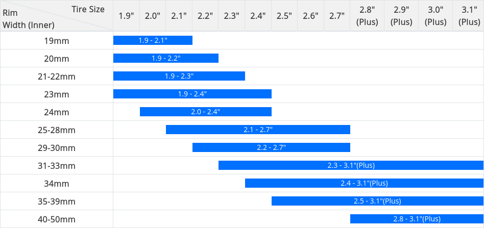

It really depends on the tire you’d like to put on it. If I were you, I’d probably go for a smaller inner width - between 32 to 35mm. Most of the tires we ride on unicycles should get on these width whereas a 40mm rim would probably be too large for some tires. For example, LightBicycle doesn’t recommend using a tire narrower than 2.8" on a 40mm rim:
