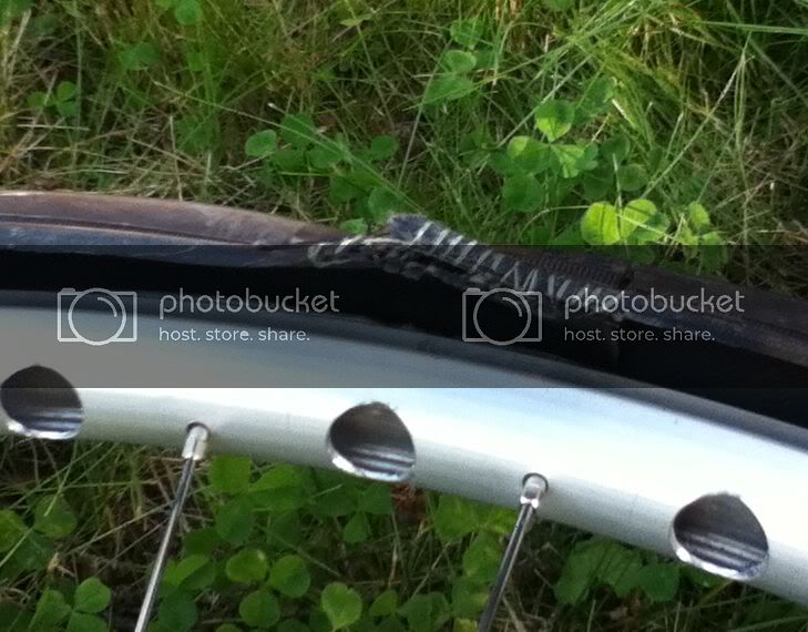

The tire is holding up great but the dip at the seam isn’t going away. I have somewhere around 2-300km on it so far an really like the size. Way lighter and faster than any of my smaller wheels and much less awkward than my 36. Yesterday I just finished drilling and tapping a few holes in the SINZ crank I have on there now and it feels great with the pedals in the 102mm hole and using a disk break on the descents.
I am gong to take the wheel apart, fix the bump at the rim seam, use longer brass nipples for joining the spokes (had a couple of the short aluminum nipples pop) and make a new smaller tire so the wheel will fit in a 2007 KH29 frame so I can put the fat 29 back in the Triton and keep this thing around for short road rides. I think it is going t become my commuting wheel.

Sometime in May I built up a new tire to fit in a KH29 frame, freeing up the Triton frame for bigger and badder tires.
The new tire was built out of cheep 27x1-1/4" tires from wallmart. I thought that they had kevlar beads since they were folded up in a little box and said “KEVLAR” on them but the really had a kevlar flat protection belt and some sort of steel cable bead.
I built the tire in a similar fashion to the 24" tire I posted earlier in this thread but no stitching in the casing, only around the beads. I could not go through the beads so had to basically just wrap them tightly together. I glued up the joins (or at least I thought I did), glued down the flaps, wrapped some tape around them and inflated to let the glue set.
There was maybe a 1mm lump at each join from the double layer of re-enforced casing. I don’t think I ever took a picture of it while it was in one piece.
