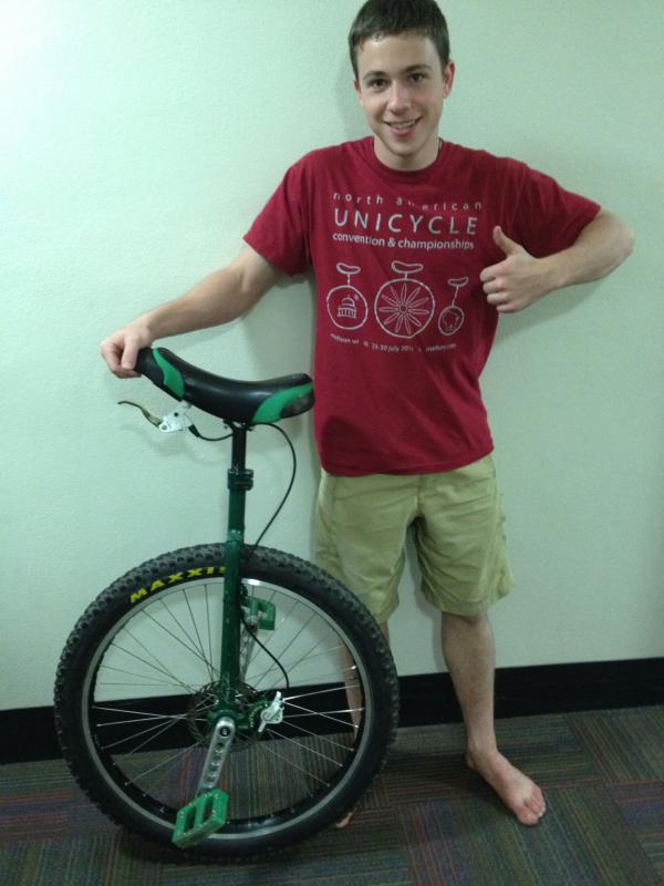

Just rebuilt my KH26 with the new nimbus disc hub.

Custom KH26
KH Frame 24" 2008 (Kris lowered the crown on his 24" in 2009 - the frame is the same size as his “short” 26" frame)
KH Seat Post Adjustable
KH Street Seat 2010
KH stiffener Plate and 2011 front bumper (I will probably put a T-bar on it - we’ll see)
Shimano Deore M575 160mm Disc Brake
Nimbus Disc Hub 100mm
KH FR 47 mm 26" rim
Wheelsmith spokes
Maxxis Ardent 26 x 2.4 lightweight
Drilled Moments 137mm
Odyssey JCPC pedals (limited edition green!)

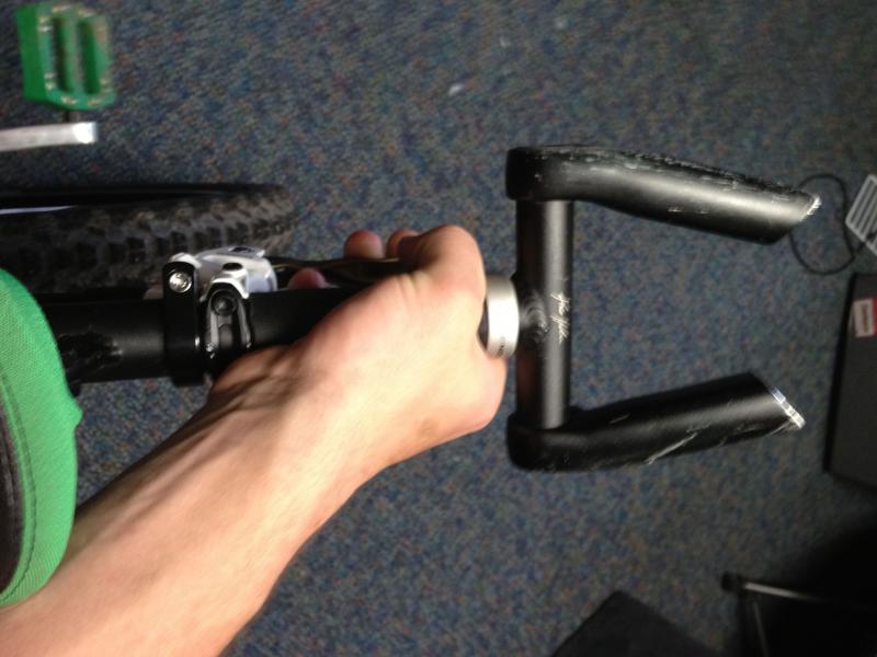

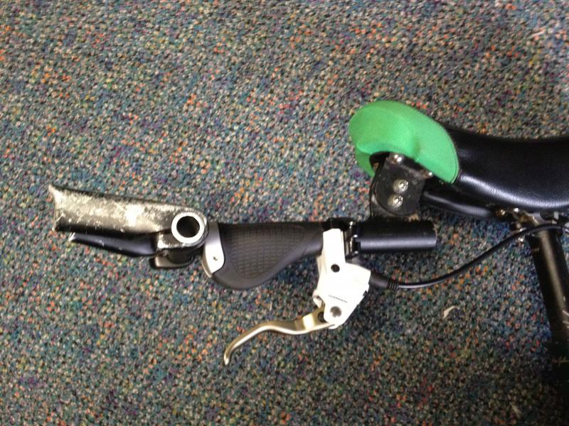

Added the “Turtle’s T” KH T-Bar setup.
hey scott, could you already try the handle setup, how do you like it?
Turtle, I have not had a chance to go for a ride yet since it just rained and all the local trails are closed. (When you live in the middle of a city, there are many riders and few trails, so they have to be closed when they are wet.) I also noticed that I have my grip backwards and flipped down compared to your grip. After going for a ride with my way, I may try to change it around and see which way I like better.
