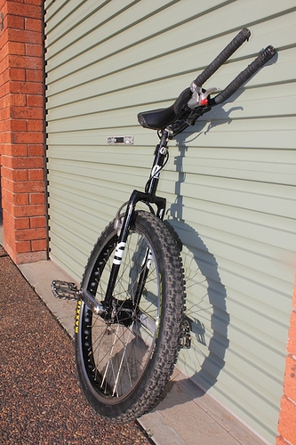

My New QX series 26" Geared Mountain Unicycle.
QX Series Alu frame, Schlumpf hub, QX series Carbon seat post, UDC carbon seat base, 137mm KH moment cranks, Impact knockout pedals, KH free ride 26" rim, HS22/33 Magura Franken brake, Maxxis Ardent 26x2.4 folding bead tyre, Self designed custom handlebar, DT Swiss 2.0 stainless steel spokes.
A big thanks to Mark Wharton and Kevin Wharton for all their help through www.unicycle.com.au. Looking forward to representing them and the QX Series brand at UNICON XVI in Italy.
