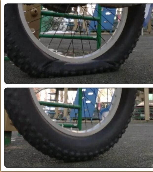

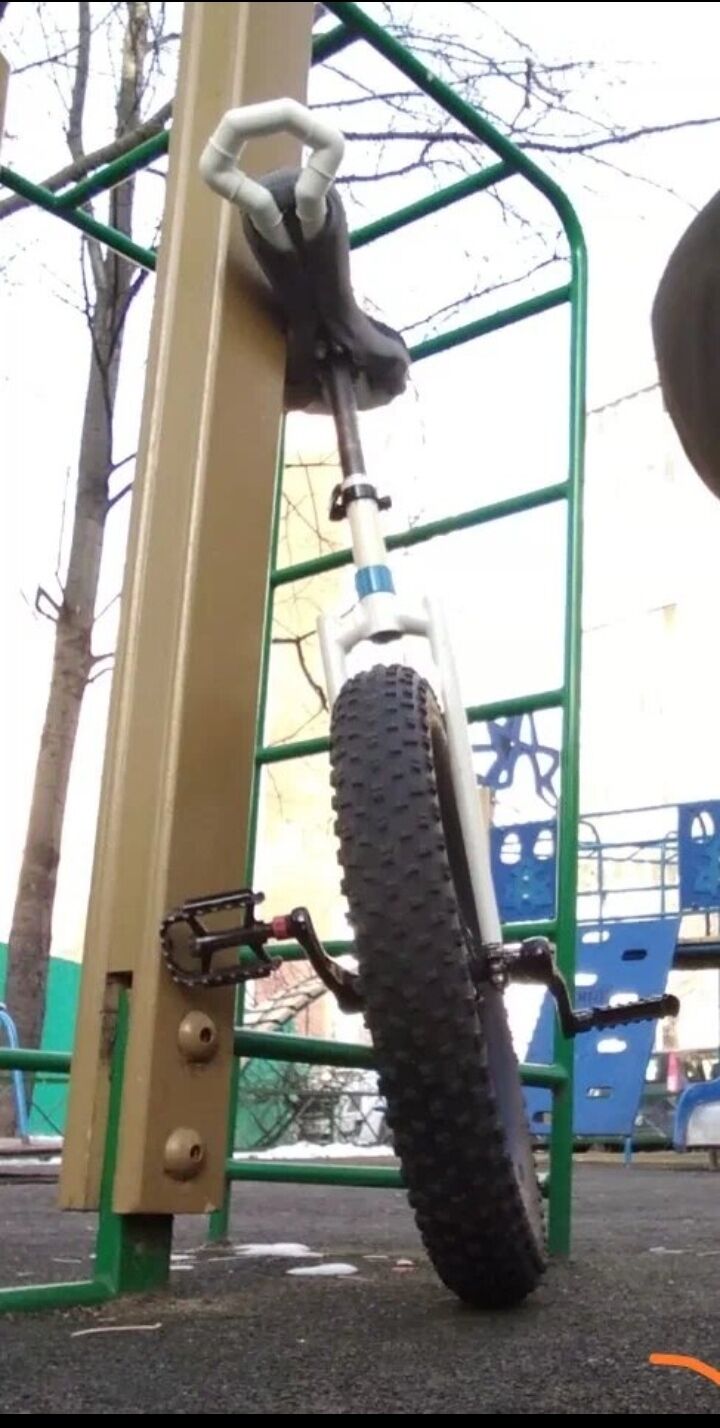

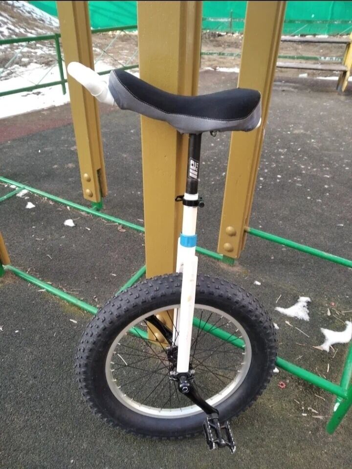

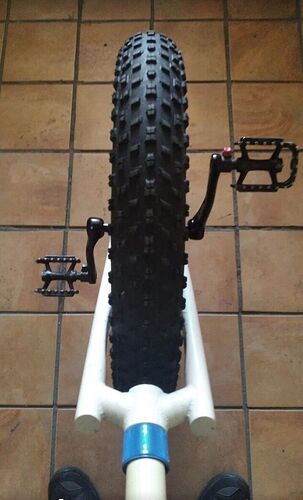

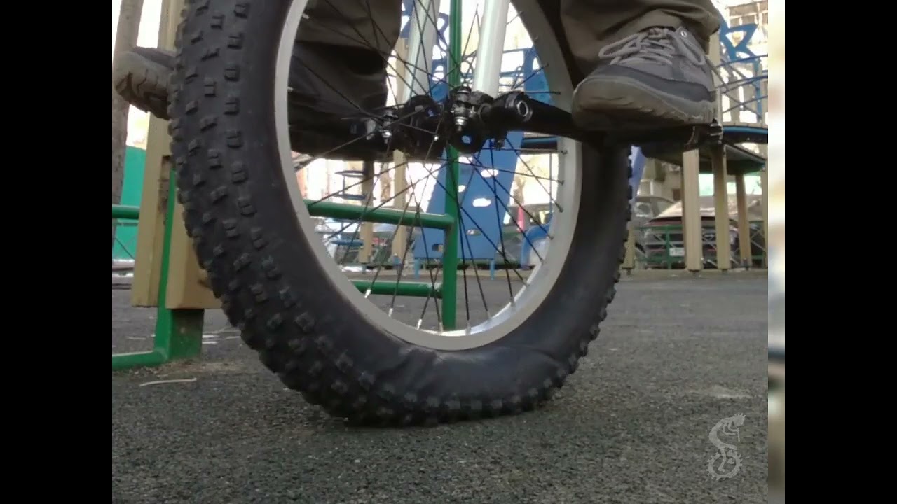

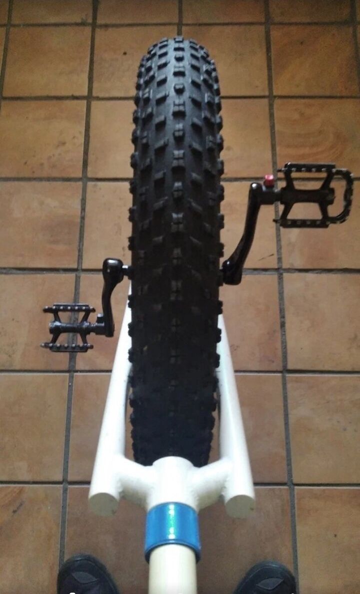

Fat tire on thin rim project.
Tire 20x4.0 Rim 25mm
Real wide 80mm, diameter 570mm

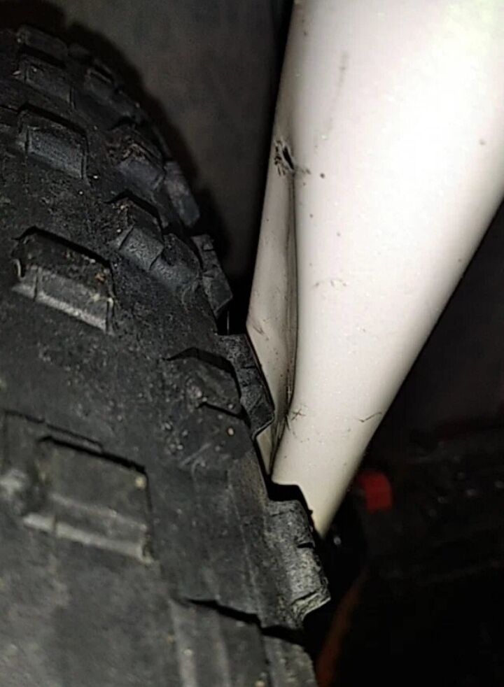

The frame 24", cro-mo, was deformed in tire area
Pressure 15psi (20psi is max. for this tire)
Pictures below, by hops.
I’m satisfied. I get very soft and controllable machine for snow and ground paths, without having fat frame.

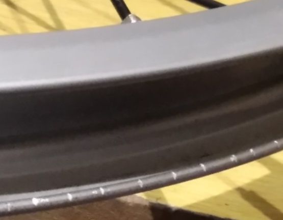

Here was one issure firstly, the tire had a little rotation on the rim, about 1mm per km. I was afraid, if the nature of it is wave moving (peristaltic effect), all efforts will be useless. I see, edges of my rim is too smooth and the tire can slip maybe. I made a lot of small dents on rim edges, by small triangle file.
Testing now, it looks like better, hope the issue is resolved.
You’re a very practically minded person. Hope your effort pays off.

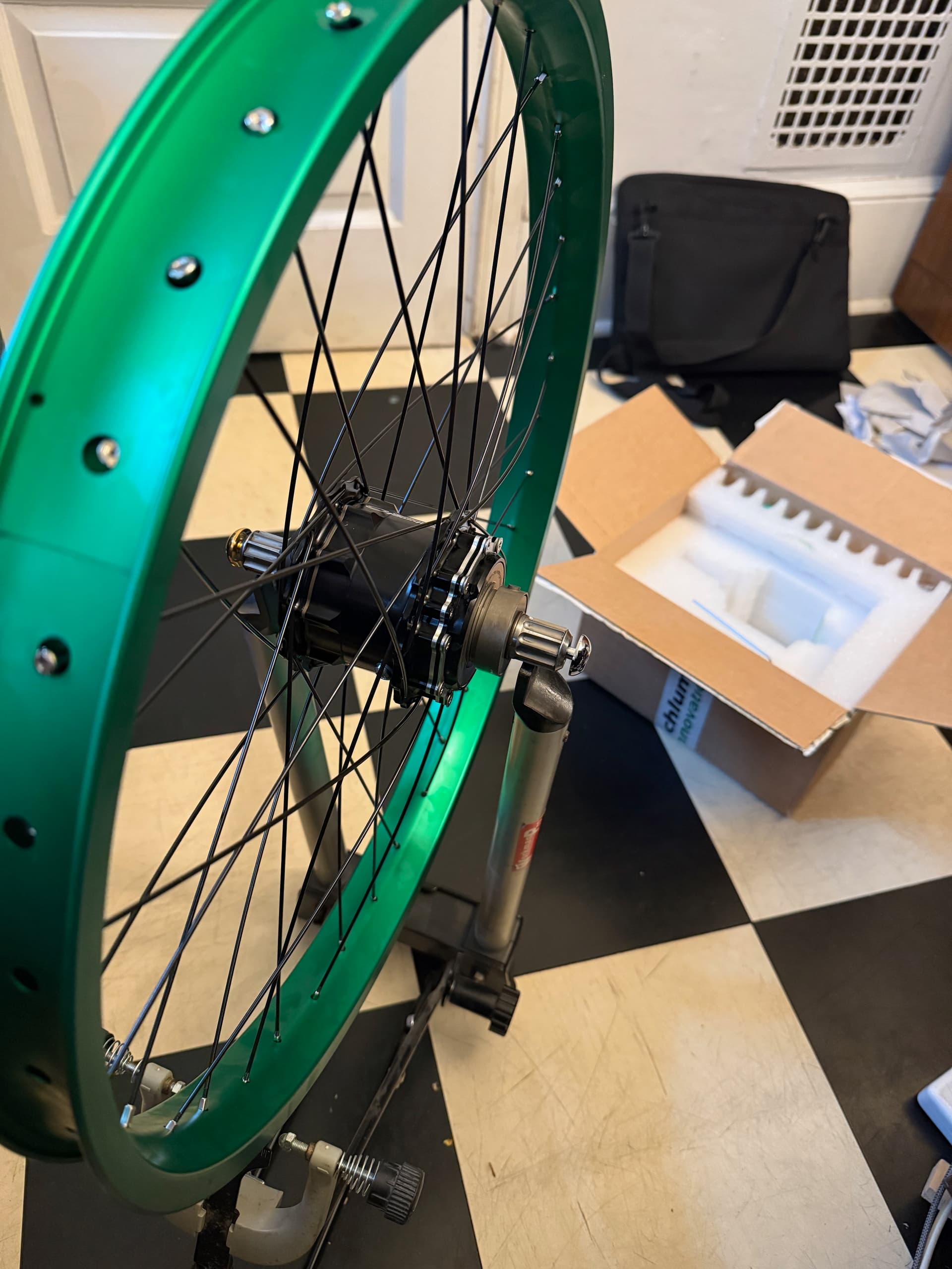

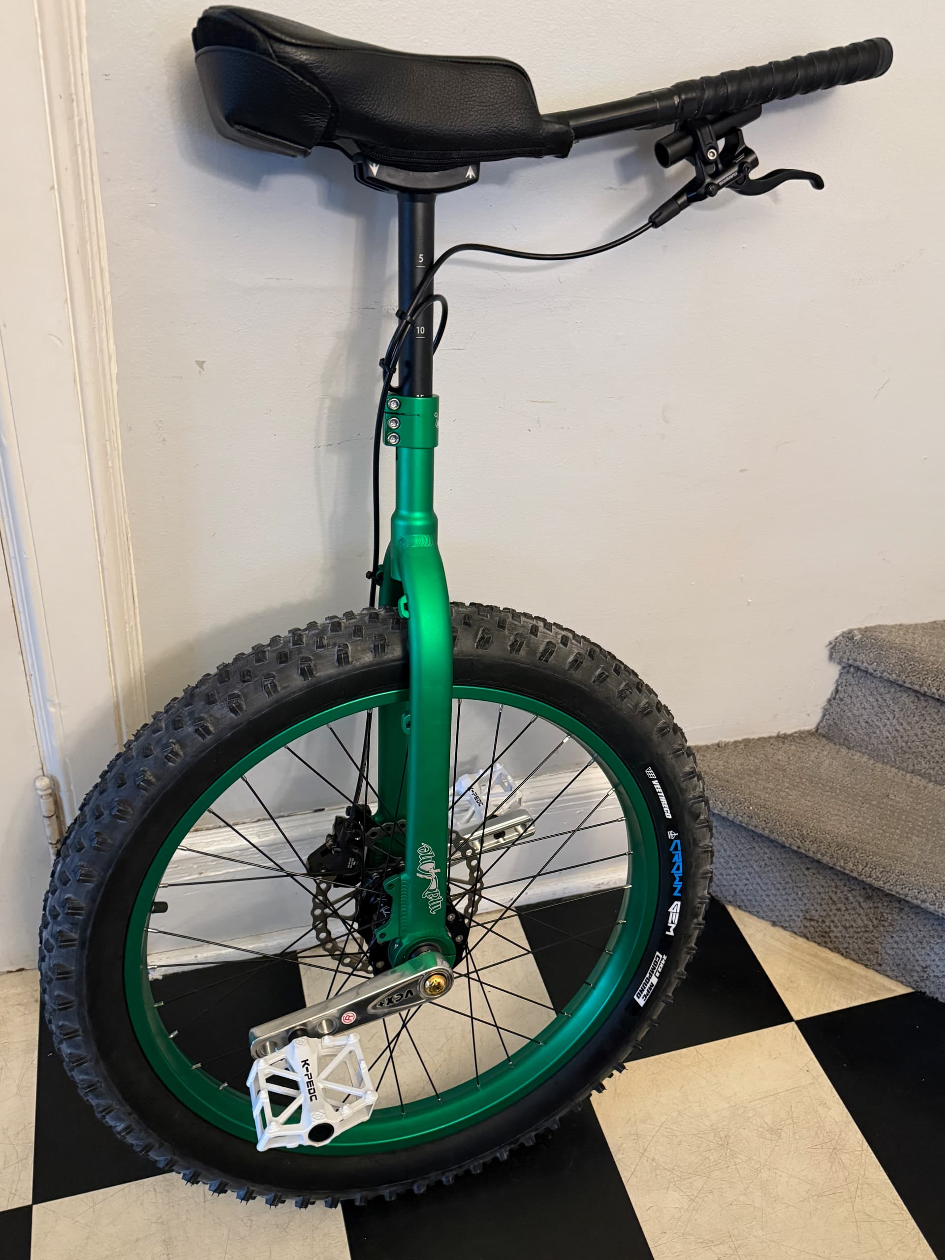

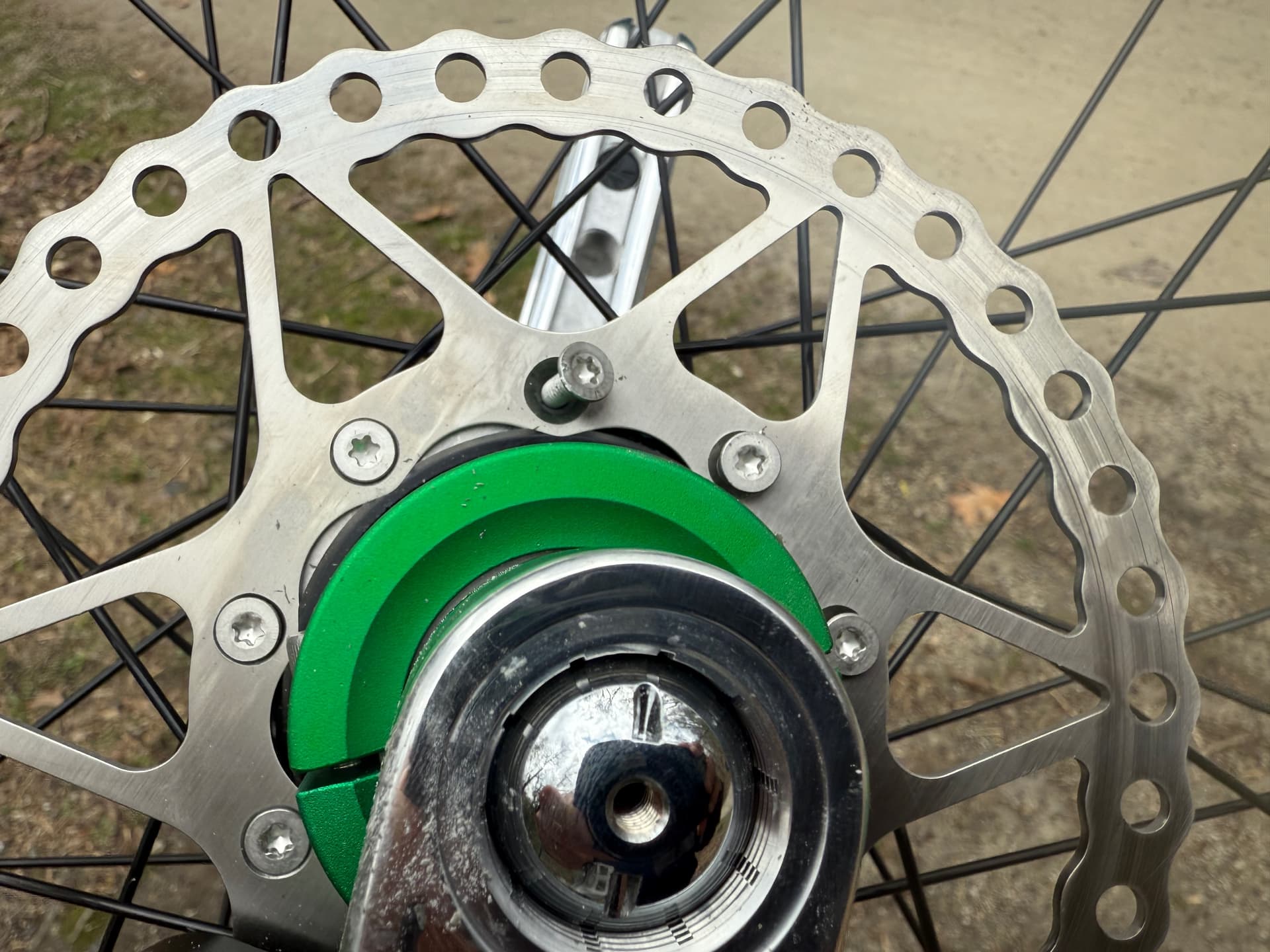

He’s done! Aahz, my new g24, fully assembled. This is my first from-scratch wheel build. Had to re-dish it twice after mounting it on the frame. 24x2.8 doesn’t sound too big but it is so much beefier than I expected! It barely fits in the frame.
After the first dishing the tire was rubbing on the frame on one side while the spokes were also hitting the disc caliper on the other, so I shimmed out the disc and dished it again.It eventually came together.
Needs some adjustments as expected. The saddle’s not quite angled correctly, one of the shift buttons is a little too far in so it wants to shift back down unexpectedly. But I can mount in high gear and get it rolling, which I can’t do on my g29.

It rides very nicely, although the knobby tire will take some getting used to. As will the different traction on these pedals. Likely seeing its first muni trail next weekend. I took it out for a flat trail ride last weekend and - oops - maybe I should have thread-locked these…
No serious damage done, fortunately. Some minor scratching on the inside of the frame where that screw bent (and was scraping every revolution). About a half mile of carrying it back to the car. Replaced the screw, thread-locked it all this time, and I’m going out for another flat trip today to work out remaining kinks.

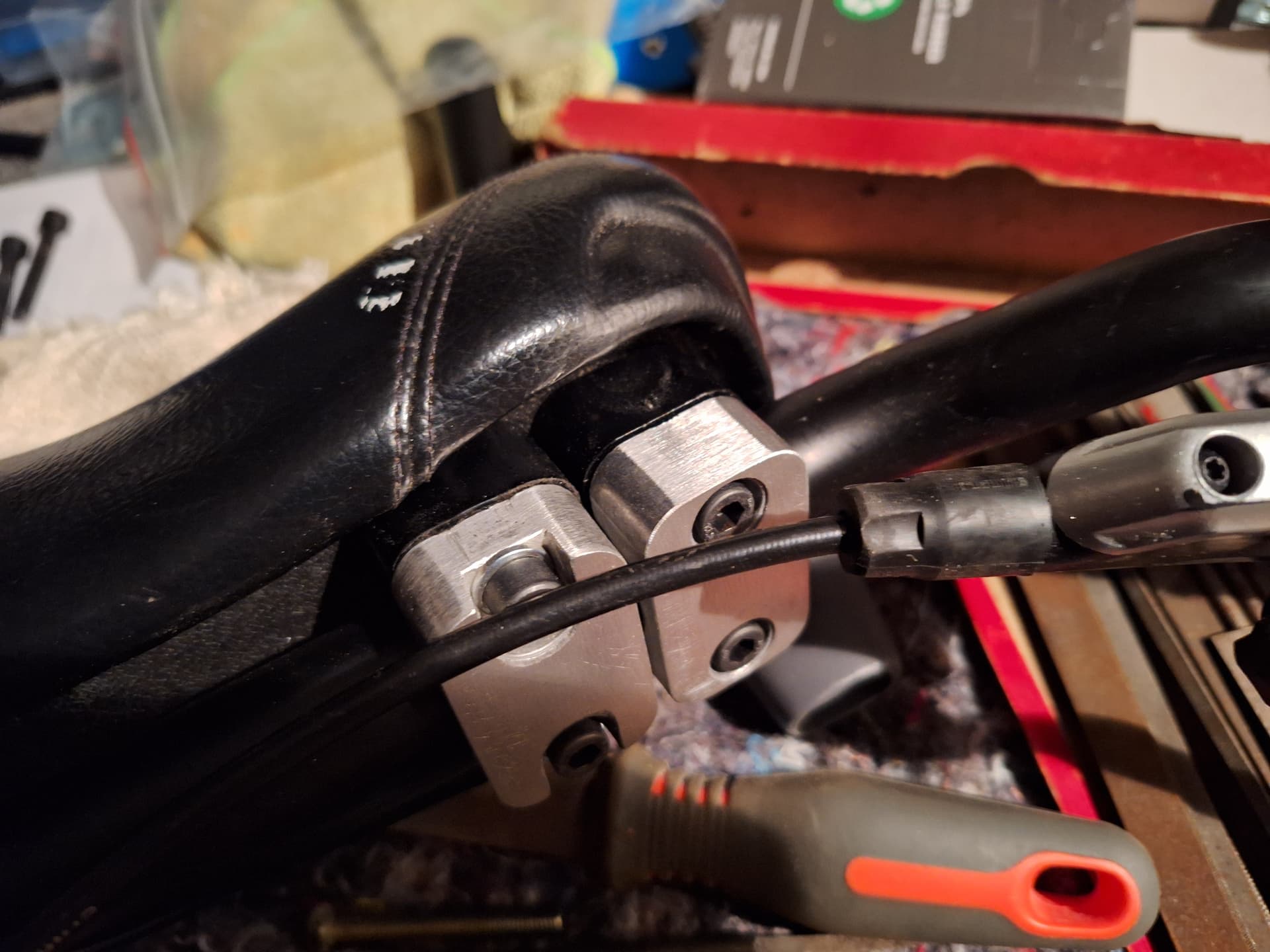

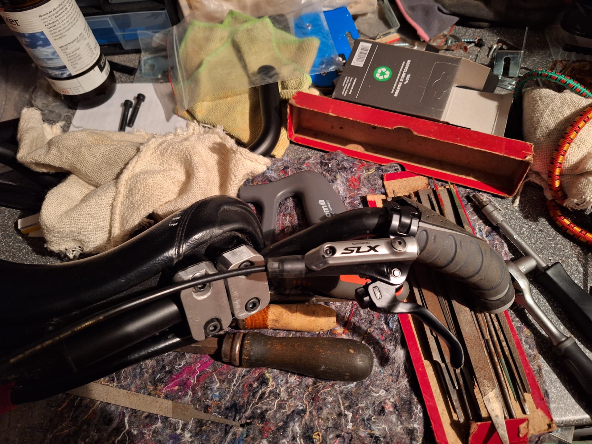

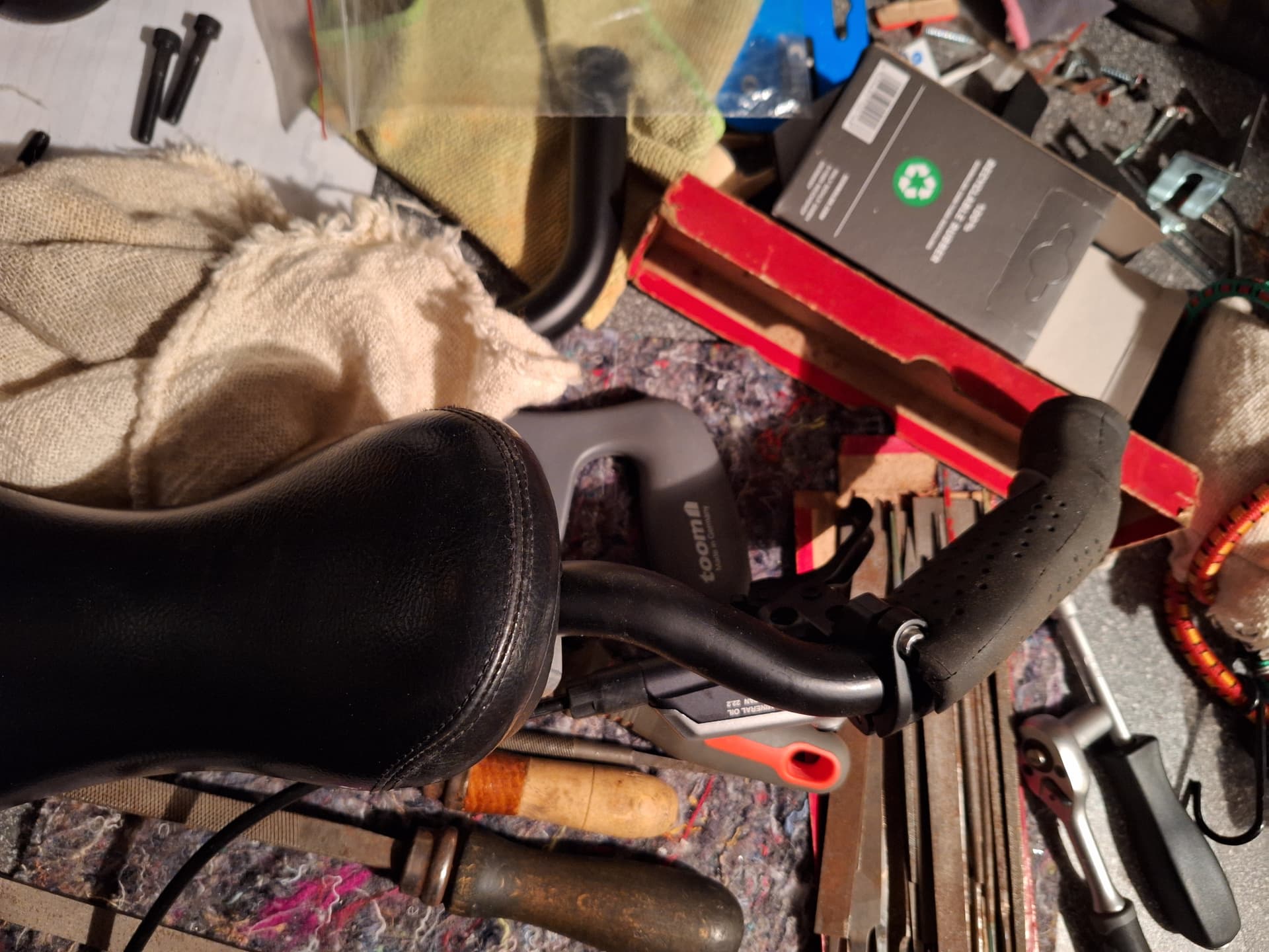

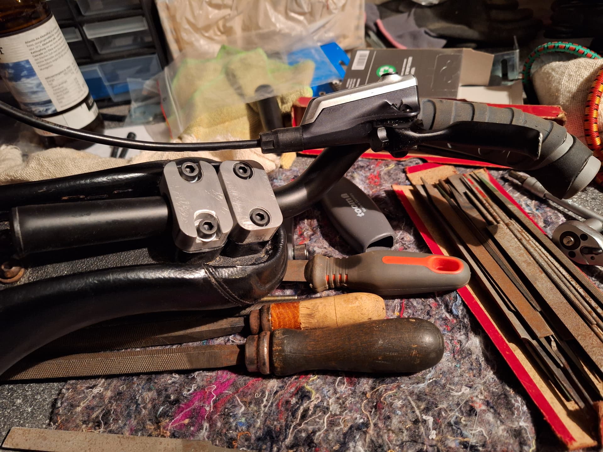

Use 22mm Pipe clamps. The hole distance fits the two front holes of the saddle base, the second one then needs a little filing.
Or for a very ridig setup something like this (as the saddle is no longer the support for the handle - a big drawback for the KH t-bar which I own but only used for a short time as I found it to flexy)
You can use another stem to make it shorter and or higher/lower if needed. All details should be in the same thread in earlier post by me. Also feel free to PM me if you need something explained. I’ve used variations of this setup for the last 1,5 years on different unicycles and it’s awesome and reasonably priced.
