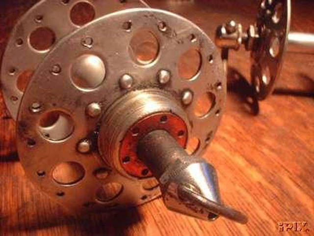

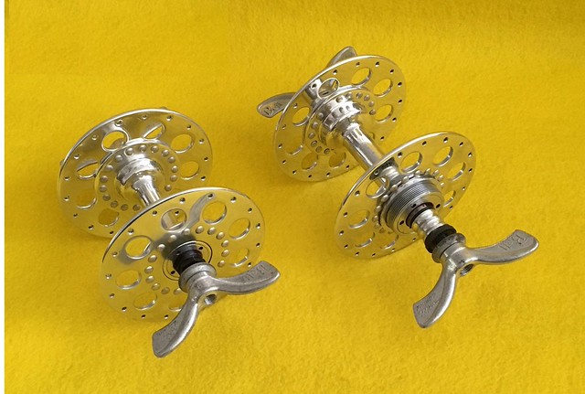

Your idea reminds me of “moyeaux grandes flasques” hubs that fancy French bicycles sometimes used to have. This isn’t my photo album but it’s a nice display of some of them:
Imgur
Down at the bottom, there are disks shown that haven’t yet been attached to a hub. They look like what I’ve usually seen, 6-10 rivets holding them on rather than screws. I remember somewhere also seeing a picture of a press someone made to add a bit of dish to the flanges toward the direction the spokes are pulling, but I can’t find that right now.
I always thought they were cool.
Also some photos here.

However, it maybe worth considering the use of the rivets like it was done with the old hubs pictures above.
At least with rivets there is no need for loctite or risks of loose bolts :smiley:
Well, rivets would be more permanent alright. It would also make it a pretty big hassle to use the hub in any other application. Since I’m not 100% certain of which wheel size would be best, I think I’d prefer using screws with loctite, and keep it flexible.
