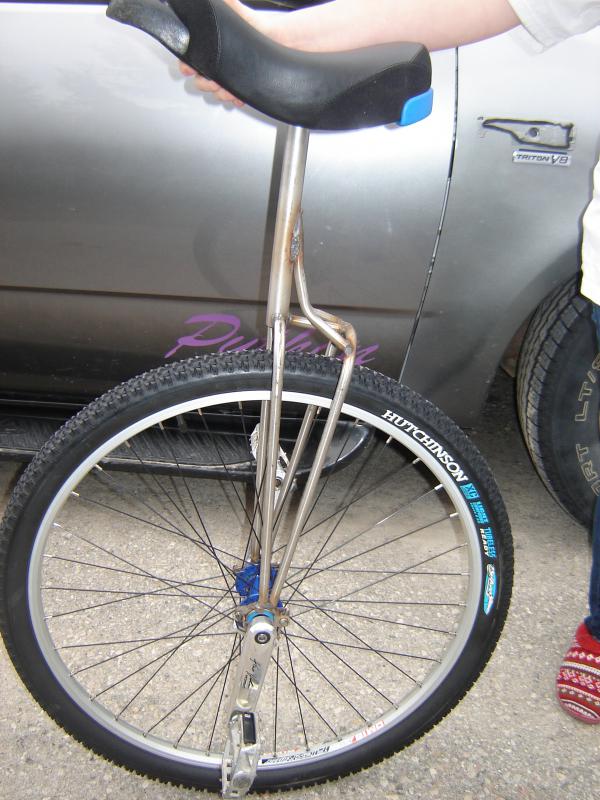

I built my own 29 er from ss tubing around a kh moment hub and a mountain bike rim , no adjustable seat post seat is rigid to frame and is solid as a rock and has handmade quick release bearing clamps

tinman, that thing looks awesome. Do you have any pictures of the bearing holders, they sound intriguing.
Why did you bend the rear ā€œstaysā€? I would have thought they would have been stronger strait.
Any way great job. It is a truly unique uni!

the rear stays are bent because I liked the look, and yes they probably would be stronger straight but not that much
tinman, that’s a pretty unique bearing holder setup you have there. You gonna give the frame a fresh lick of paint or leave it bear?
I’d be tempted to leave it bare but buff it all up and make it nice and shiny first :slight_smile:
you’re right mowcius I’m going to polish and leave it raw, maybe a clearcoat but that would be it

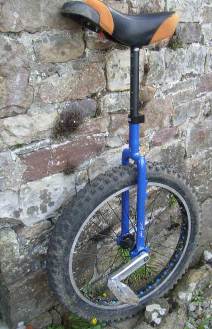

KH24 - bought in stages from unicycle.com in the UK. I had a learner unicycle with a KH fusion seat, cheap 25.4mm seat post and clamp so I bought the KH wheel, Moment cranks, pedals and a nimbus 24" Muni frame and put them together - cost £220. Then I bought a 27.2mm Pit Fighter II on Ebay brand new for £20. Finally I bought the KH24 frame and impact seat clamp so I could replace the nimbus frame and use the Pit Fighter seatpost.
Total cost £305.
Can’t fault the KH24, the components are beautifully made and for a little over Ā£300 it’s a top quality Municycle for half the price of a budget mountainbike.
Nice looking uni, orange and blue go together well.
Thanks raymanh. You don’t get a great deal of colour choice with KH. I loved the clear pedals with the blue anodised components but think they look a bit wishy washy now - I think the Uni would begreatly improved by bronze/gold Echo pedals.
Lets see your KH20 and review - I’m aiming to get a 20" trials uni next week and the KH20 double crown is topping my list so far.
